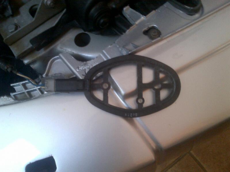

also l found this loose on the front end, any idea

That is a new "bit" to me. It appears to be connected to a pair of conductors? Where exactly did you find it hanging?
It may be something to do with a previous owner installed something or it may be a Land Rover part.
I noted something like numbers written on it or a brand name. Normally most of the Land Rover bits have either a Ford or Land Rover logo or some sort of five to ten alpha numeric part number molded on it.

yes!! another member told me it is a tire pressure receiver each wheel has 1 .
Thanks guys
