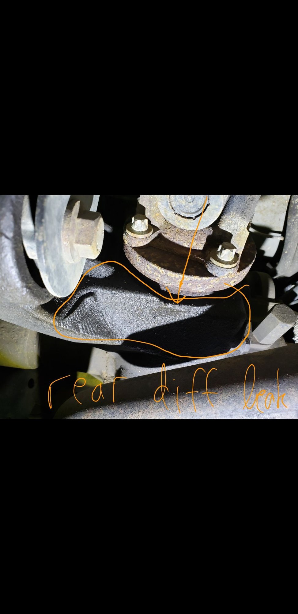

Hello all. Looking for advice or links to repair write ups to fix a few oil leaks.
Vehicle: 06 LR3 4.4L with HD package
Oil leaks:
Power steering rack.
Front driveshaft
Rear driveshaft
Rear differential
Pictures attached (hopefully)

Pictures attached this time.

Rear diff- can’t tell on the pic where it’s leaking, you can try new seals at the sides/axles, but I find that the bearings have play in them and that play causes the leaks. If that’s the case, rebuild diff.
front drivesgaft- actually is the front difftube. Remove and replace needle bearing at end and a new axle shaft seal.
rear driveshaft- replace whole assembly.

The CV is failing on the rear driveshaft.
There are no good resources I know off for the repairs. There is a factory manual that you can find downloads for, but it won’t help with the diff rebuild.
