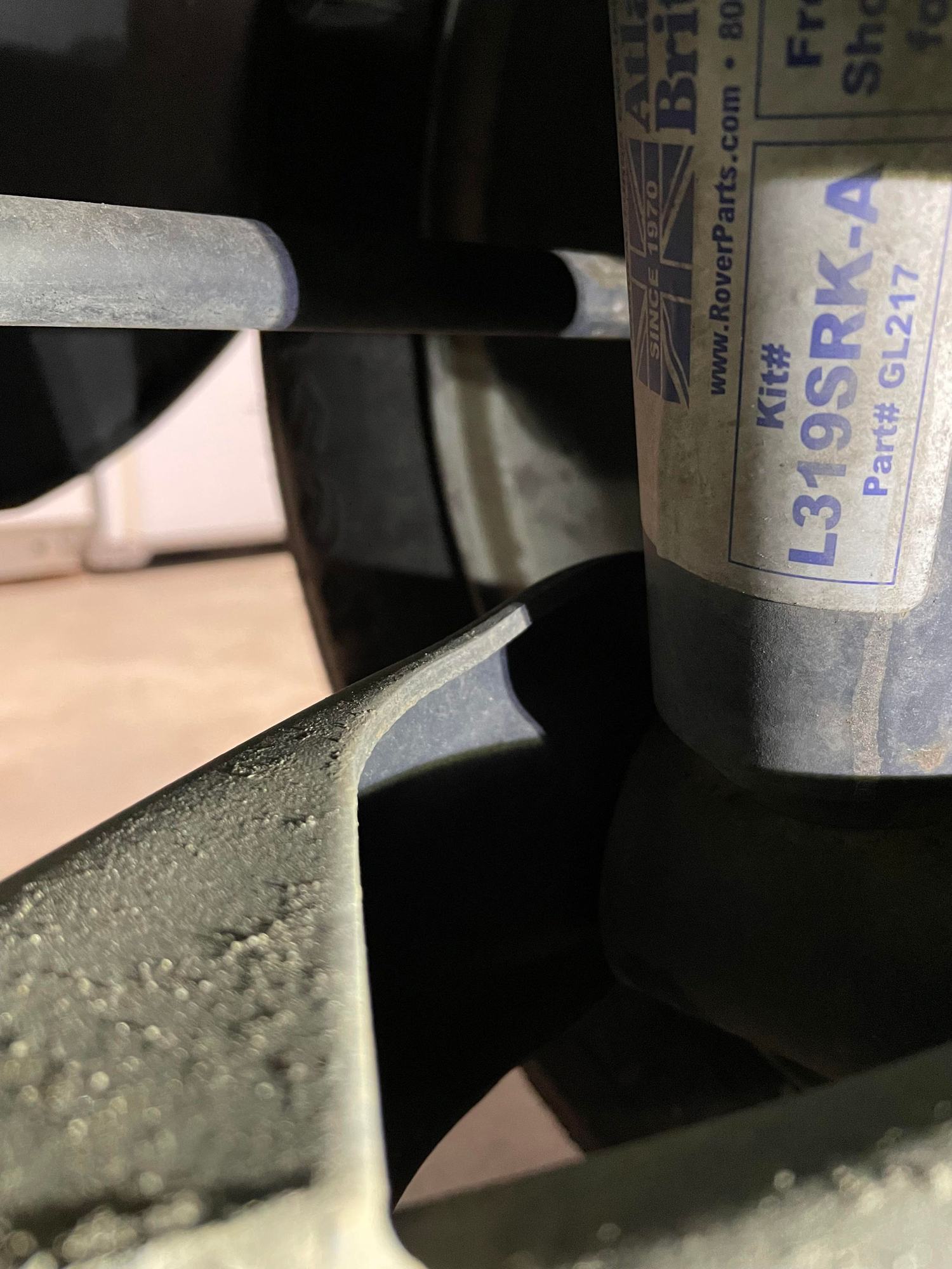

Finally had a chance to crawl under the LR3....it already has a coil conversion! What the small car dealer and I thought was an airline was actually a brake line. I am actually relieved because coils suit my needs very well. This will be a daily driver-mostly on paved roads with occasional weekends on unimproved trails to hiking trailheads and the like. Extreme rock crawling is not my jam. It all makes sense now. Thanks for pointing out that as a possibility!

At least it is a really good conversion kit! Atlantic British knows their stuff!
