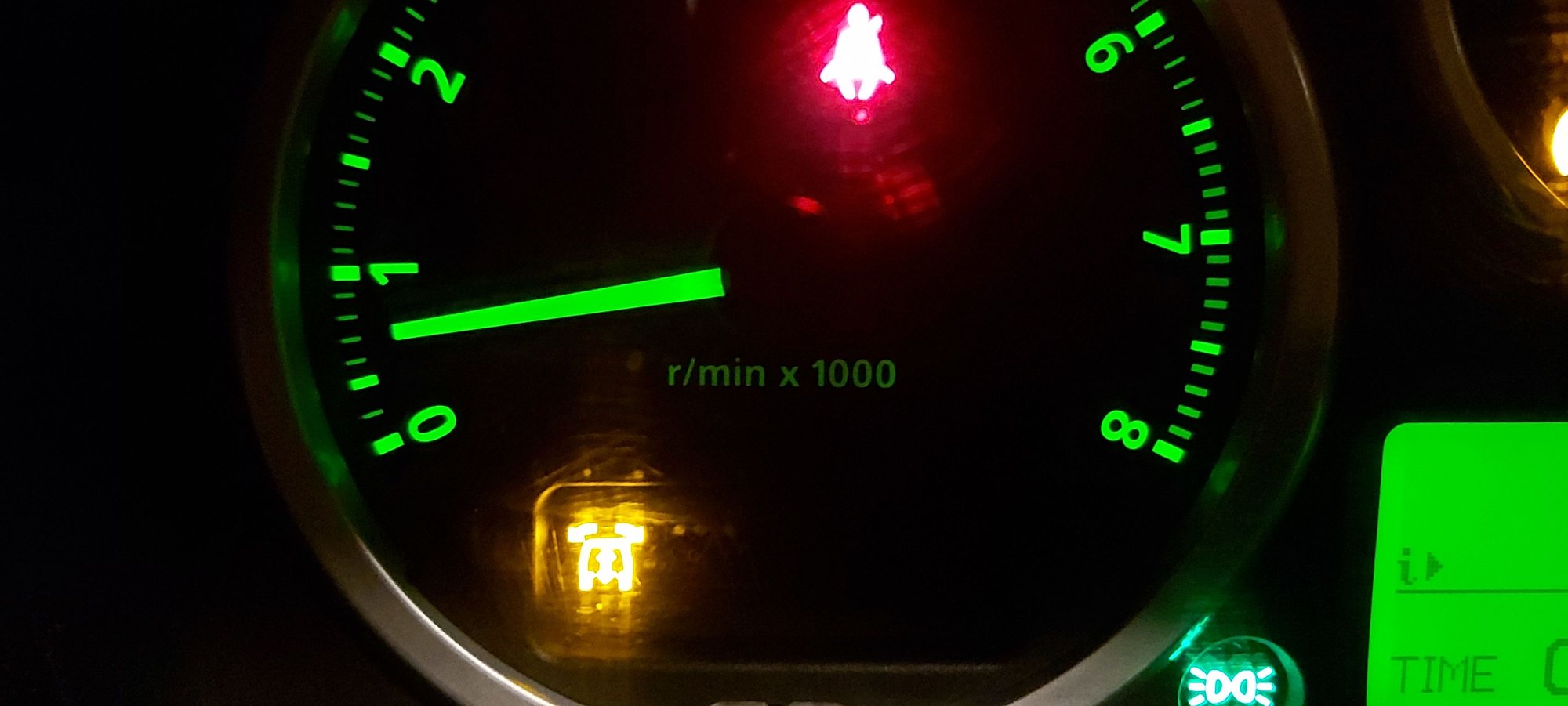

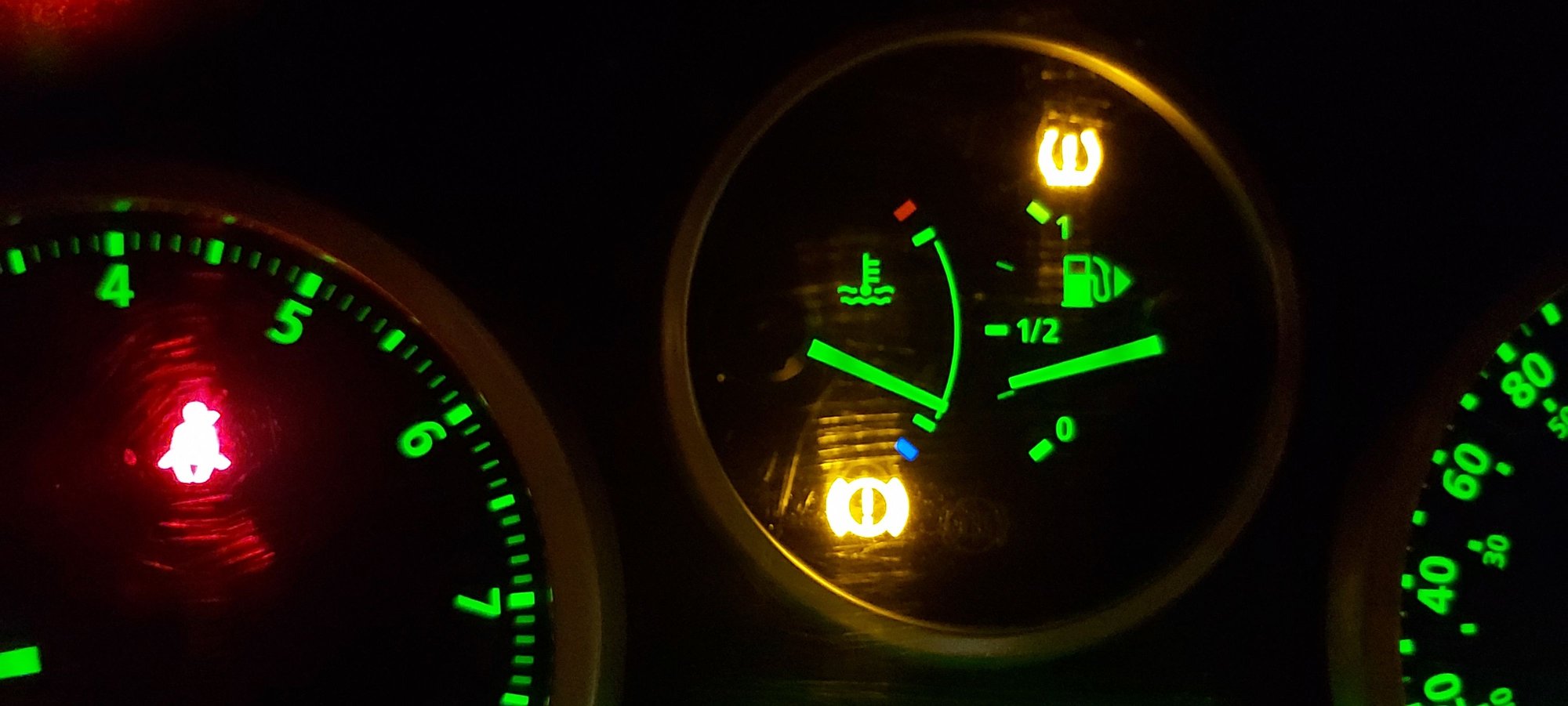

Well pics are working now. Is that the ONLY message on the info center? Cause your ABS light is also on, so that makes me think there is a greater fault disabling the suspension.
Edit: Actually "system fault" is new to me, first read it as suspension fault. Something is out of line, beyond the air ride. Not sure what system fault even means really, never saw that before.

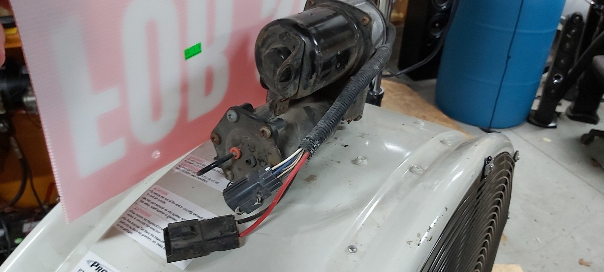

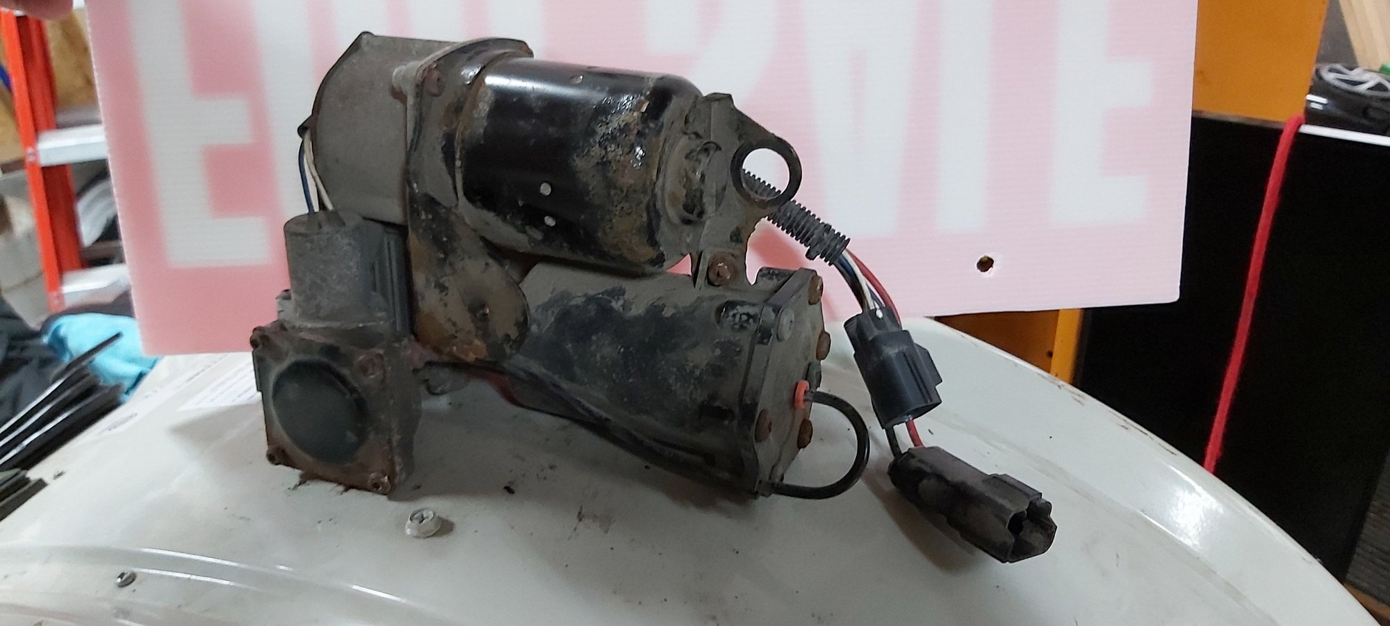

Old compressor removed

That is certainly a Hitachi style pump.

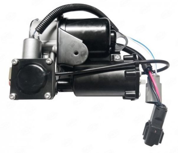

New one installed

So based on a very non-specific fault, I would hav etc guess you have a fault in the terrain response system or something associated that is actually causes all the faults. So the air ride itself may be okay, you need to clear all codes and see what comes back. I highly recommend getting the GAP IIDTool, less than $600 and you can do tons of Rover specific things including getting all the specific system codes that a regular ODBII scanner can not get.

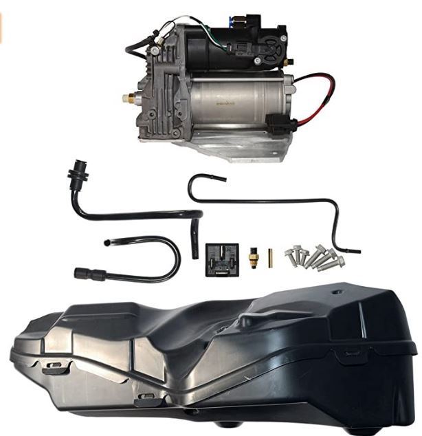

Old May 16, 2020 | 04:23 PM
Brian Raddick's Avatar
Joined: May 2020
Posts: 48
From: Brantford ON

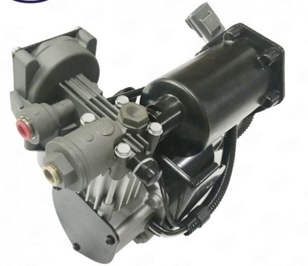

This is what they are telling me I HAVE TO / MUST install
