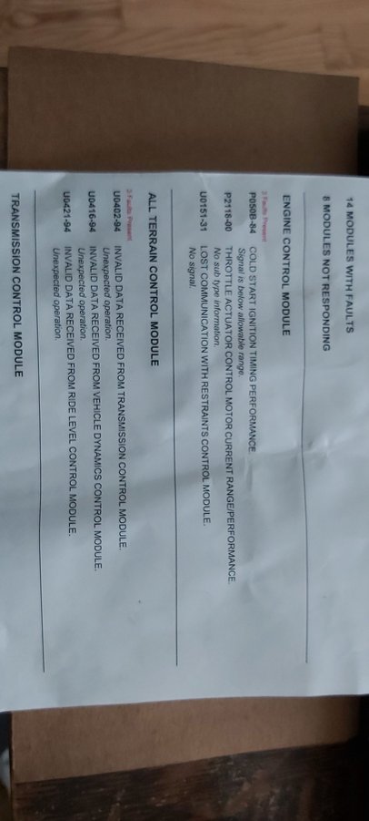

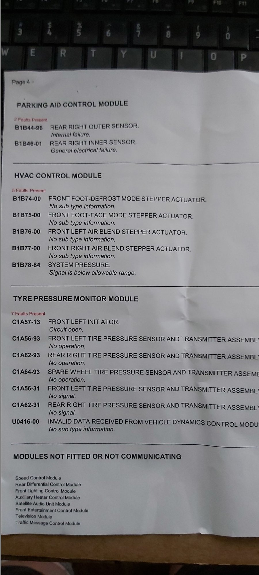

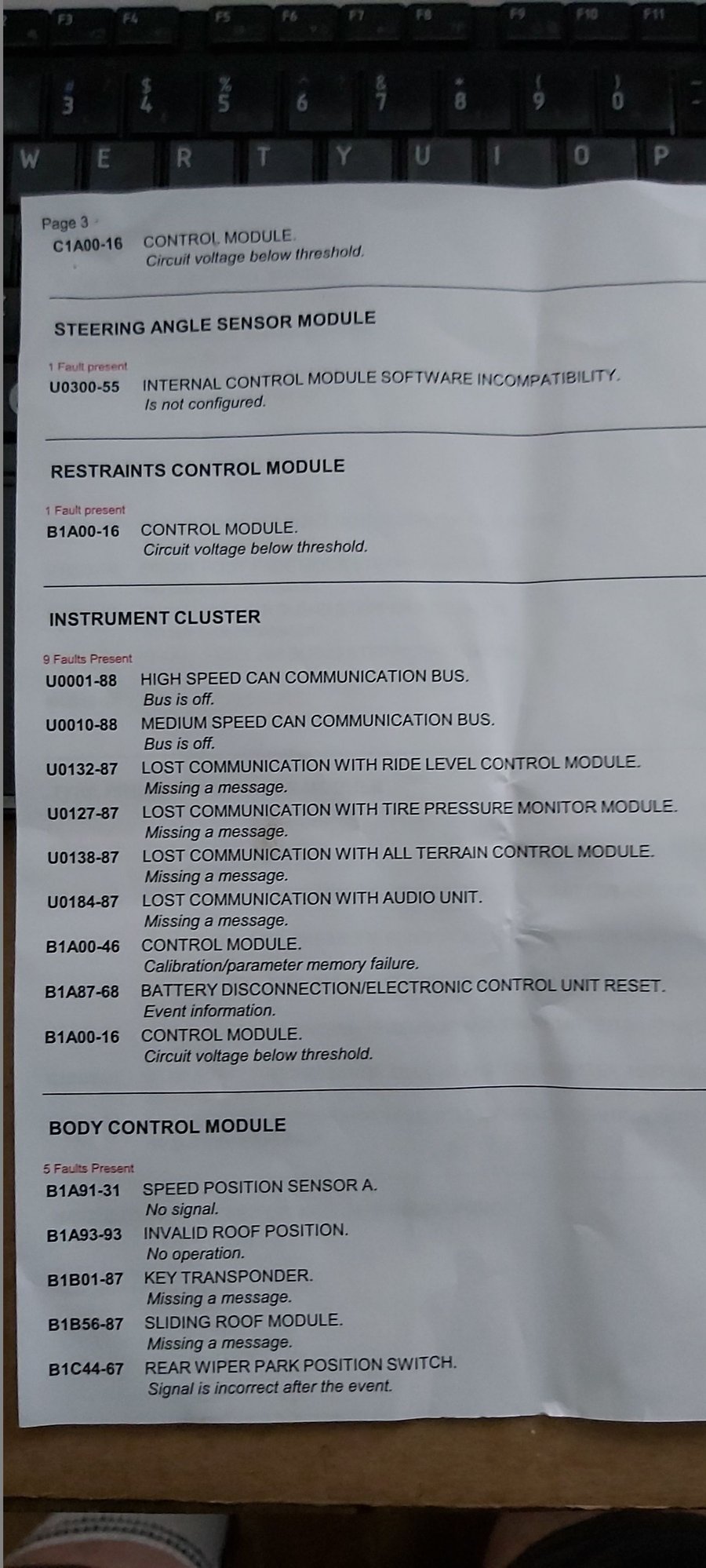

They are idiots. Dont go back to them. There is no reason to upgrade to an AMK compressor.
Sorry for the sideways and upside down ones, I rotated 3 times and each time I attached, they were wrong, Hope you can read them,

Are those codes read AFTER a total clearing of codes? Casue many look like typical Rover errors, ghost errors that often come up but mean nothing. Or you have a very messed up vehicle, maybe something is not connected at the CJB (central junction box).

I don't think they cleared anything. Actually, they recommended scrapping the beast. Can many of those be cleared with a battery disconnect ? Only one that showed on the dash when I bought it was for the Parking brake. I know there is an issue there .
