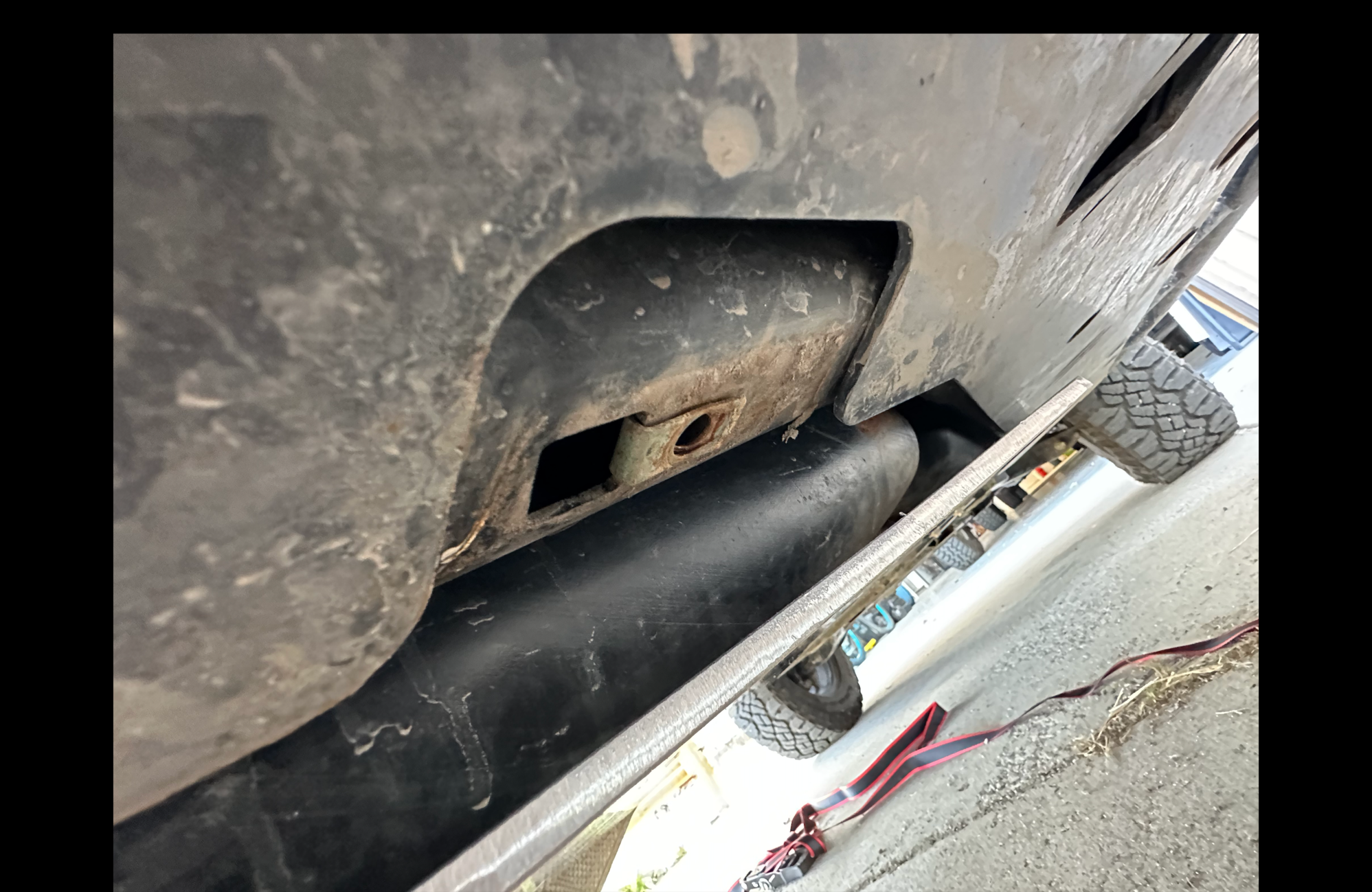

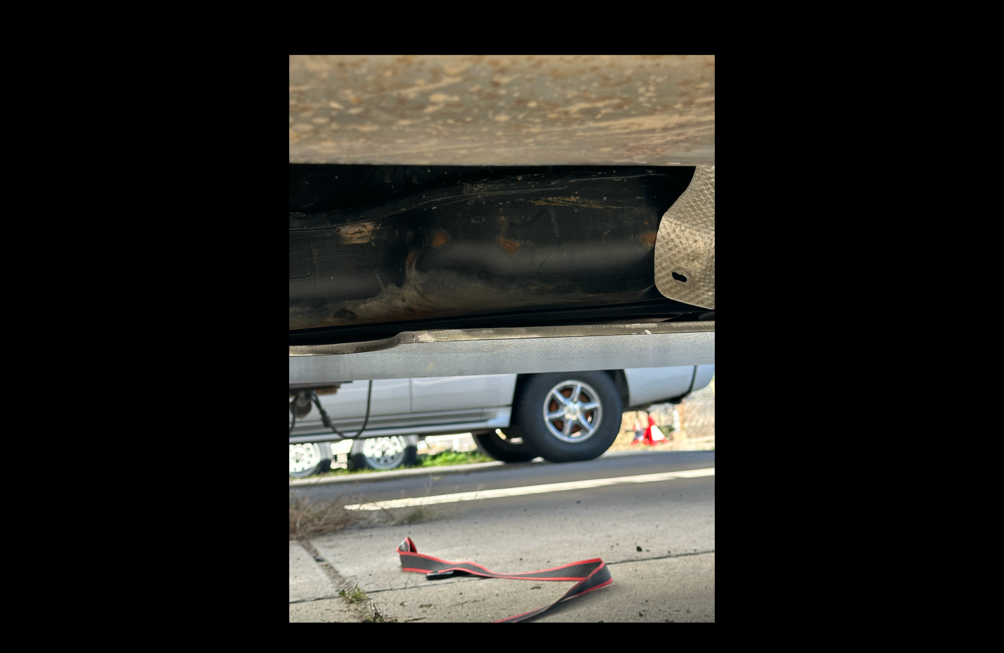

We bought the Lucky 8 LR3 gas tank and just installed it. We are NOT impressed. I removed the OEM skid and did a direct bolt up as I received no instructions and the short description on the website just makes fun of the factory skid. One person on another forum said it is supposed to be installed over (or underneath in this case) the stock skid. I would never entertain that as it would take away from ground clearance. Seeing the HUGE gap in between the skid and gas tank and how low this thing hangs had me speechless. Also there is a side bolt hole doesn't attach to anything so it's just 3 bolts holding in this huge skid and it just hanging out in the breeze, very shaky. I also don't like how the sides of the gas tank are not protected. If a rock gets caught in between the side of the huge gas tank flap and the soft gas tank and frame look out!
exposed gas tank inboard side
exposed tank outboard side

I will close by saying I've always been happy with Lucky 8 as a company and their products however with this I really expected a lot more, especially for this price. I've reached out to Lucky 8 and am waiting to hear back. Unless something big changes I am returning the skid and reinstalling the stock one, which fits like a glove and although not pure beefy strength has been quite sufficient for the wheeling we've been doing.
*pics attached, it's hard to get good angles for photos but it shows the inboard and outboard exposed tank sides, teh hole to nowhere, and the huge gap/ clearance loss.
