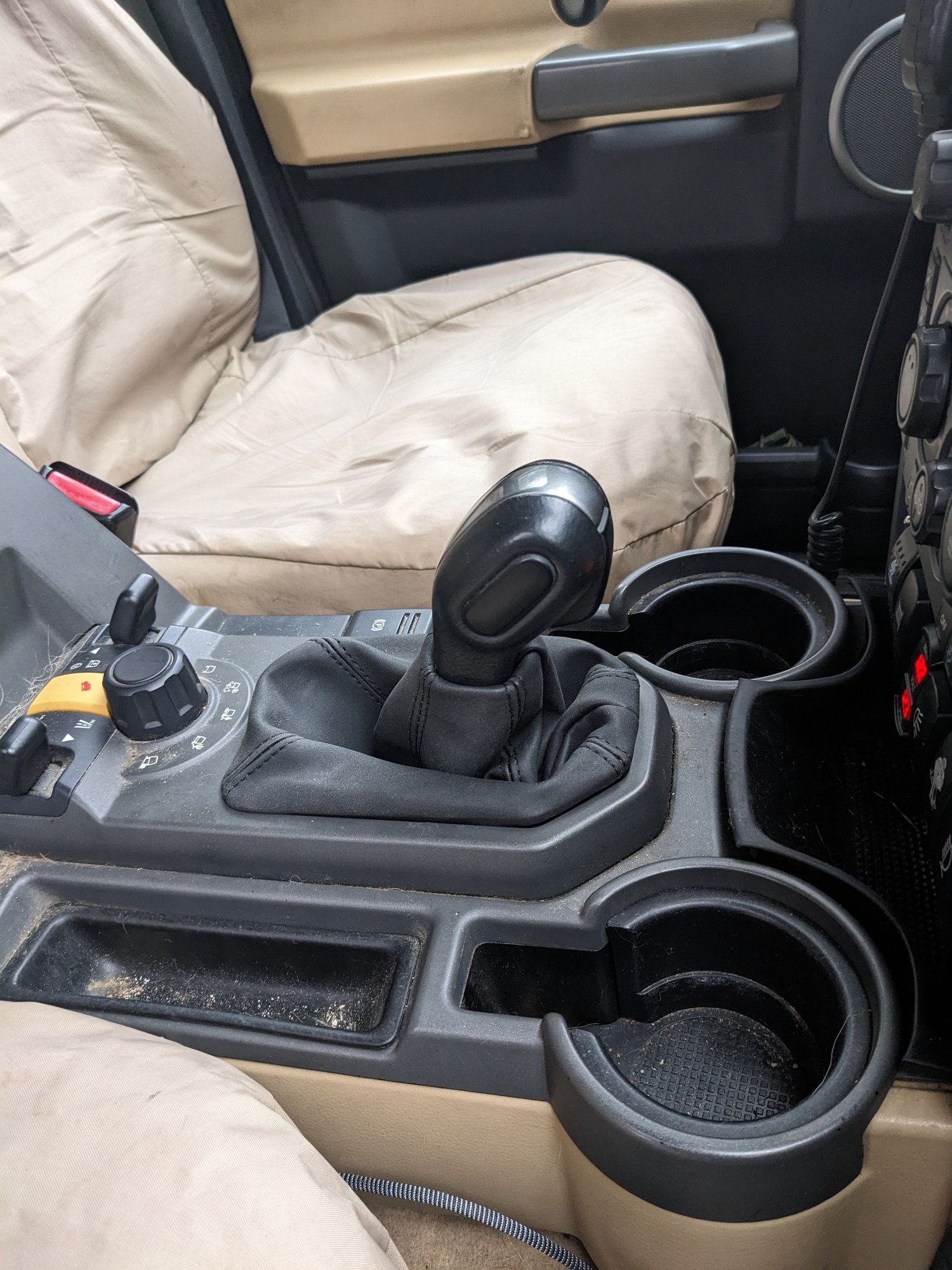

I got tired of hearing the plastic fence rattling around and did this
Put a Discovery 3 manual shift gaiter on it to avoid the plastic clatter when using the command shift

I don't have that issue but love the gaiter. Where did you source that? Thanks.

Default You have to REALLY want one
I did not think to take any pictures of the process because
1. I did not think anyone else would care that much.
2. It was cold and rainy yesterday and the though did not cross my mind.
First off: Linky thing to the part
Be careful if you find this somewhere else for a much reduced cost. Most only have the cloth (or leather) gaiter but not the plastic mounting ring. So do your homework. I suppose you could contact a few junk yard (they call them wreckers) in the UK and find a used one.
A few notes if you do this.
1. pull up on the gear **** and set aside.
2.At this point, you have two choices, you can pull up on the whole terrain response panel or try to just pry up the small panel that has the gear shift lights. I chose the second approach.
3. Once the small panel is removed disconnect the flat pc type connector and take the panel inside where it is warmer and better lit.
4.There are two small circuit boards (one on each side of the opening) that are pushed over a few small plastic posts and then heated to form rivets. I took an X-Acto knife and cut the top off of those plastic rivets and removed the two circuit boards that are wired together.
5. Plug the circuit board back in to the wire harness and tuck away securely in the console.
6. The rear of the mounting trim conflicts with the shifter and makes it difficult to get into D and almost impossible to mover over to sport or command shift mode.I cut about 1/4 inch off of the rear portion of the trim piece which is about 1 3/4 inches wide.
7. Feed the shift **** into the gaiter. There is so much excess that It did not need to put a rubber band around it to hold it up.
8. Push shift **** back into the shift lever, and snap in the trim ring.

I see you have a dog hair issue like I do when it comes to the center console. LOL About once a year I actually remove the entire center console upper bit and break them all down and detail them. So much hair, dirt, etc. Yuk. I do like that shifter cover idea!

DakotaTraveler, I usually use the leaf blower after each camping trip to get the dog hair out. Otherwise it can go a month or more between leaf blower events. I only have 2 seats. I have the LR sear covers and I like the water repellent properties, but I am looking for something that does not keep slipping off. yes aside from the broken shifter fence, it did let a lot of hair into the inside of the console
