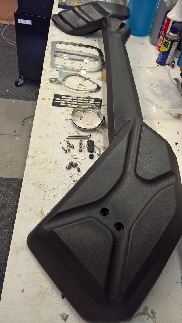

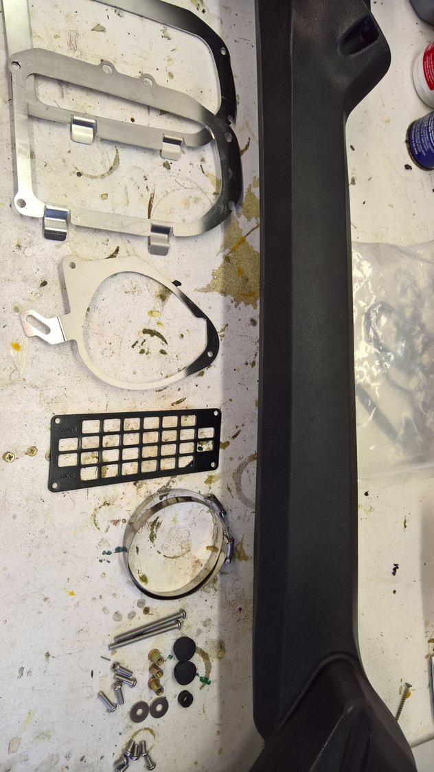

Snorkel arrived today. Shipping was very fast. It looks to be decent quality- good thickness and feel to the plastic, hardware looks solid. IT COMES WITH NO INSTRUCTIONS. So... I watched a YouTube on installing an ARB snorkel which at least gave me some general information. I will let everyone know how it turns out.

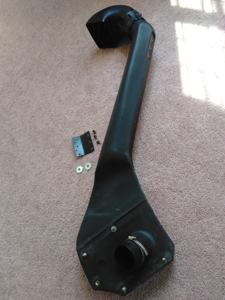

Land Rover Safari Snorkel Air Shocks Compressor Bracket Package Deal | eBay
I my opinion/experience after market its Not as good as the Brand Name stuff and the material is different/cheap...after all you get what you pay for.
Cheers
$200+ ship

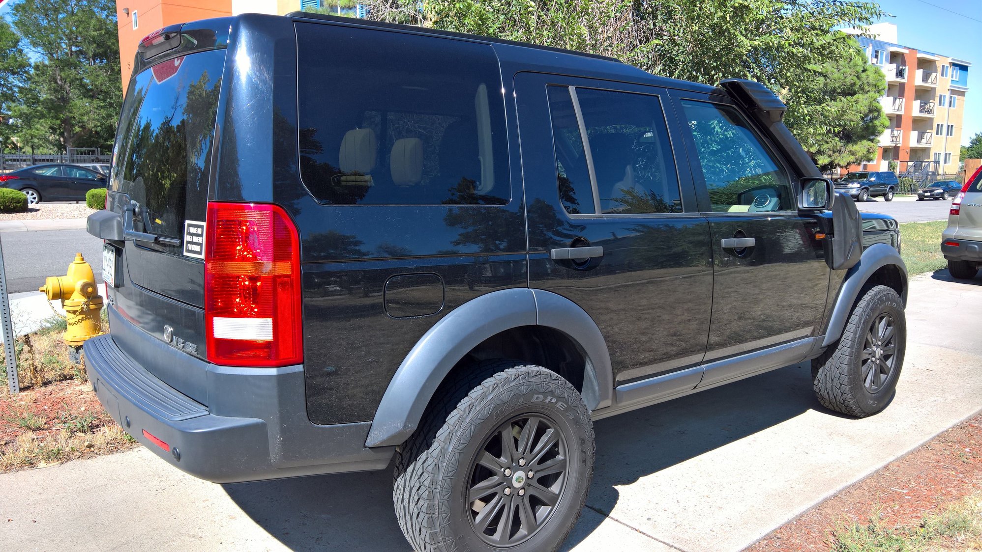

Installed the snorkel today. I have never looked at an OEM up close so I can't give a comparison but I can say that the OEM instructions from Niver39 were spot on. The fit was good and the snorkel is mounted solidly. I made 2 changes- 1. instead of using the brass sleeves that come with the kit I used a nut and washer to secure the main body of the snorkel to the fender and 2. instead of using a brass sleeve on the window pillar I used a self tapping screw with a washer. Much more solid and easier as well. TIP: use some epoxy on the washer and nut for the body to hold it to the inside of the fender. Saves you trying to get your arm up there through the wheel well.
Obviously it fits perfectly for the 4.4 V8. No worries there. I don't know why the kit comes with 2 hose clamps. I could not see a use for them. The unit seals pretty well but if you are planning on deep water crossings I would use some silicone as well. (The ARB has a better system for sealing the intake) There are 4 screws you will need to supply. They are the ones to hold the grill onto the snorkel inlet. Some basic little metal screws worked fine.
All in all I would definitely say this was worth $177.00. I just could not see spending $700.00+ on an OEM.
I hope this has helped. Please let me know if you have any questions.
