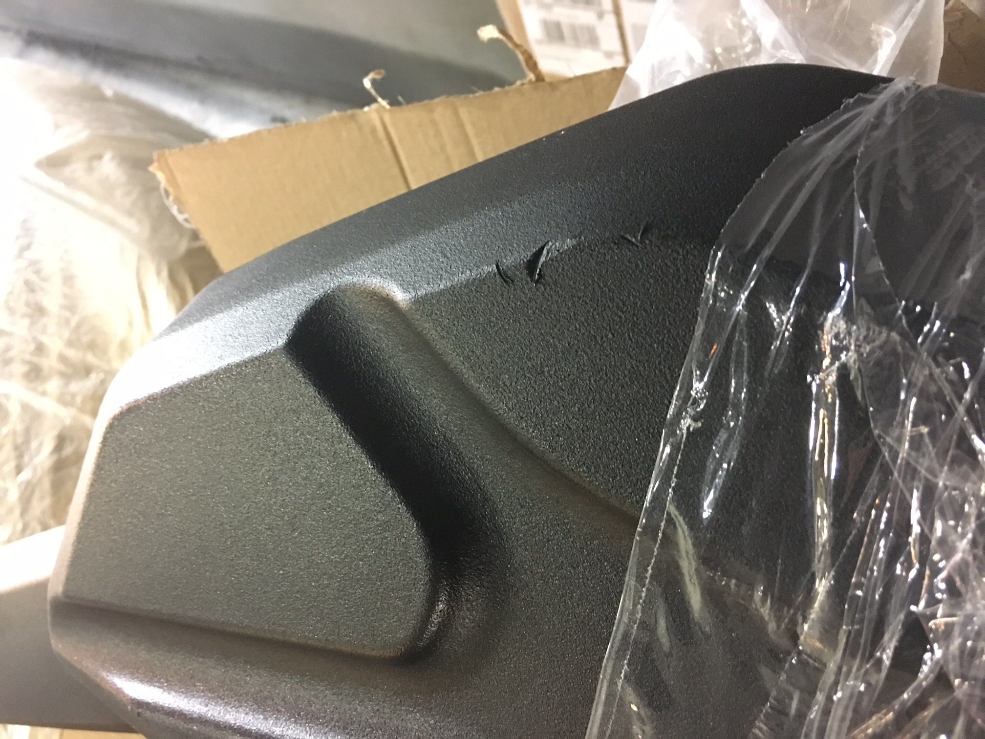

What a bummer - took the snorkel out of the box at the shop today, and there's a big chunk out of the most OBVIOUS spot on the entire unit.
Of course it couldn't have been on the back side or top, etc.. nope, right there where everyone will see it.
I messaged the seller on ebay.

My only concern would be how the material holds up over time, no particularly deteriorating, just how badly it'll fade in comparison to the higher priced snorkels it's replicating.
Texas sun hates black plastics, so. :P
Duplicolor makes this stuff called "Bed Armor" in a rattle can, but it layers like an epoxy bed liner - same texture also.
Worst case you could just mask everything off (or remove it) and coat the entire unit in a can of that stuff - should last forever.
The material does feel VERY strong, but I'm not sure about UV resistance.
Really hope I dont have to send this stupid thing back to China to get a refund! I can probably melt some plastic and stick it in there then re-texture it.
Thanks for the heads up on that product, I actually might have to give it a try on my plastic fenders and such, they're starting to look pretty bad.
