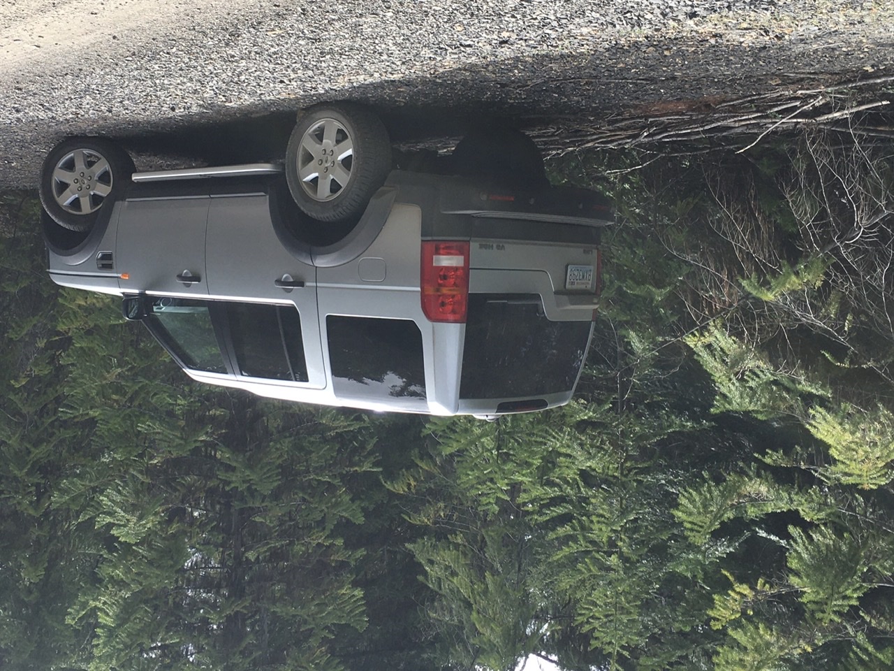

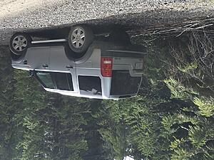

Got any pics of this new-to-you LR3? Sounds pretty nice/rare being an '08 HD. What color is it?

Zermatt Silver. Here’s a photo of it on the trail this weekend while hunting for morels. (not sure why it’s upside down, I’ve uploaded and then rotated and uploaded and get the same thing).
