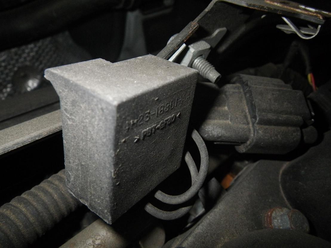

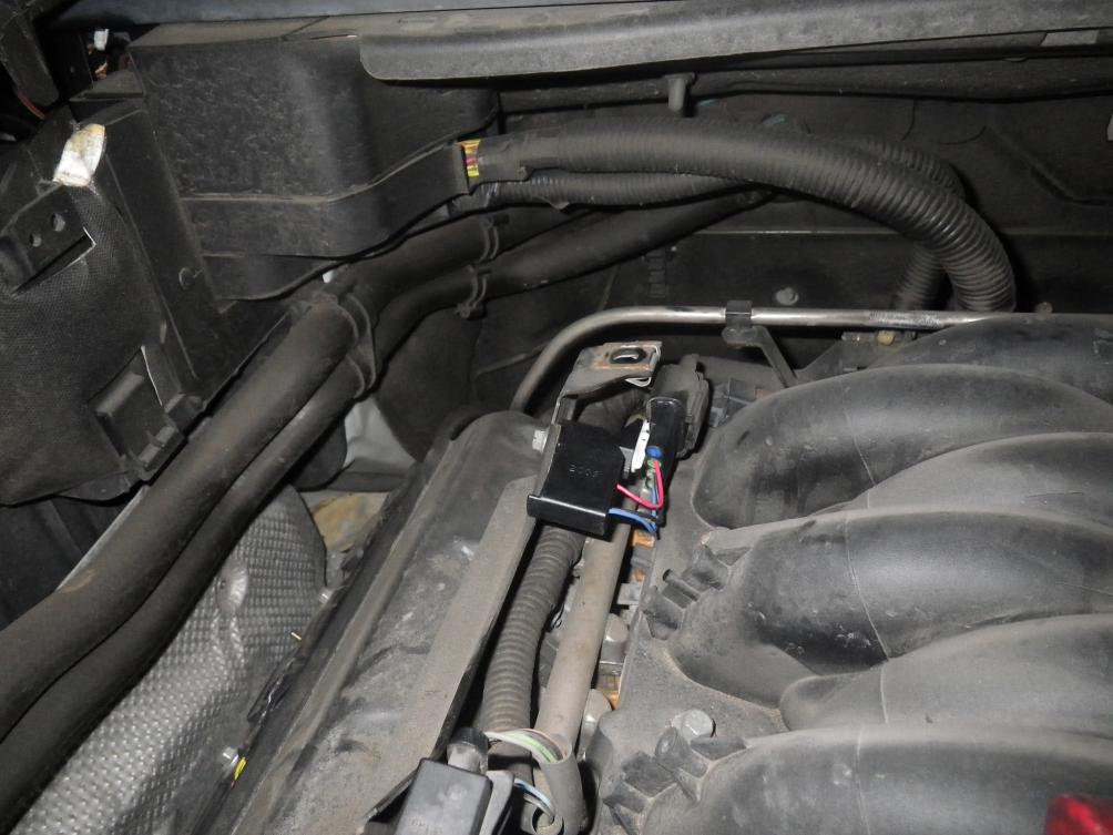

Roverguy7 posted the photos a little while back here:
https://landroverforums.com/forum/lr...service-59972/
Old style:
updated style:

Originally Posted by rinmud
guarentee the diode on the coil pack is failing , sometimes intermittant sometimes totally. Its beneath the top cover in the engine bay and it looks like a thumb drive for computers. its 18 bucks if you go to a ford dealer and show them it. just tell them your a redneck with a 2004 f-150 scott
I am having the same issue and the dealer doesn't know what part I am talking about m any chance you can post a picture?

Originally Posted by sfera
I am new to this so I am sorry if it posts twice. Dealer know what part I am talking about. Do you have a picture or lr part#
Thank you
https://landroverforums.com/forum/lr...e4/#post409744
