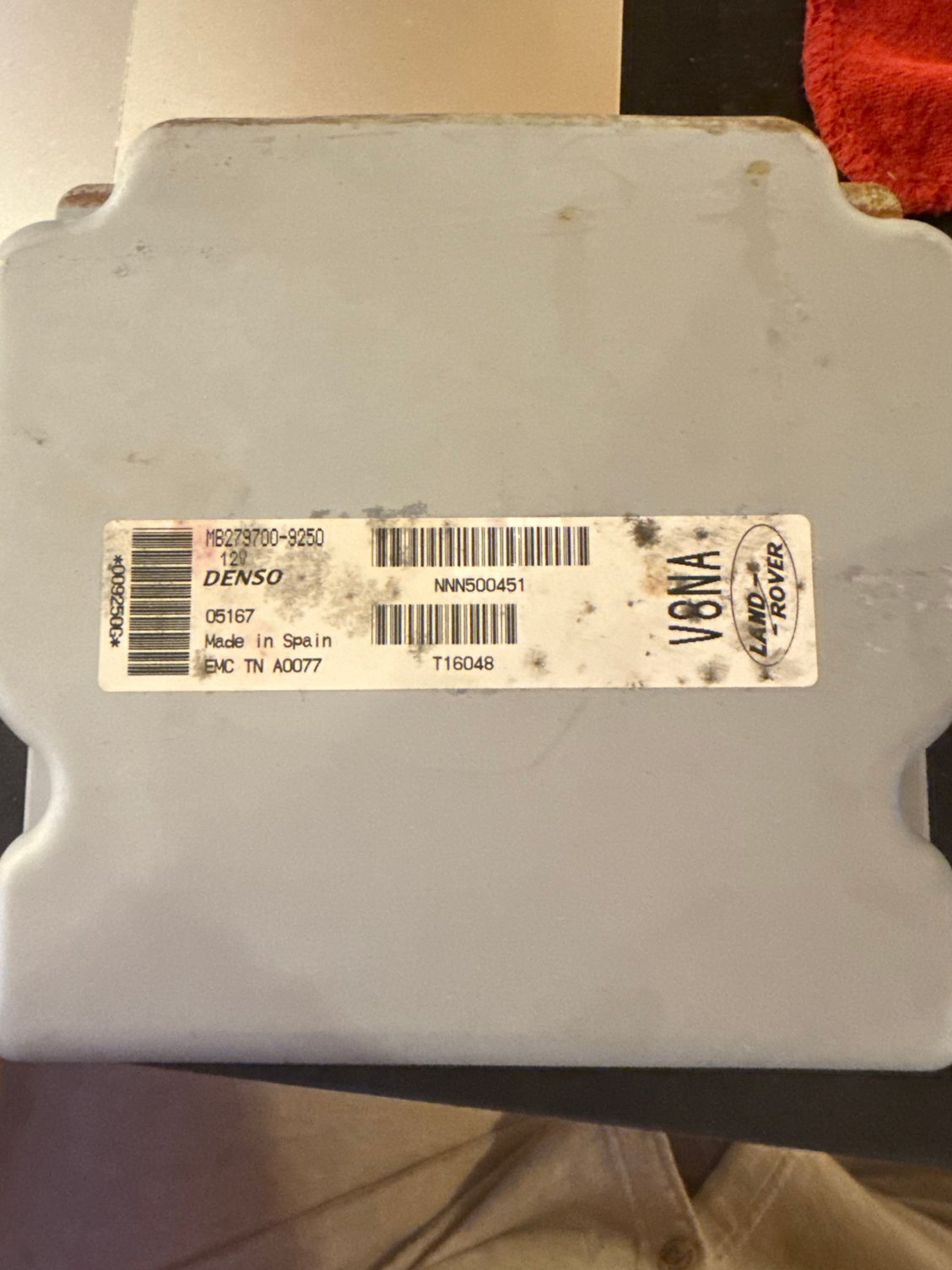

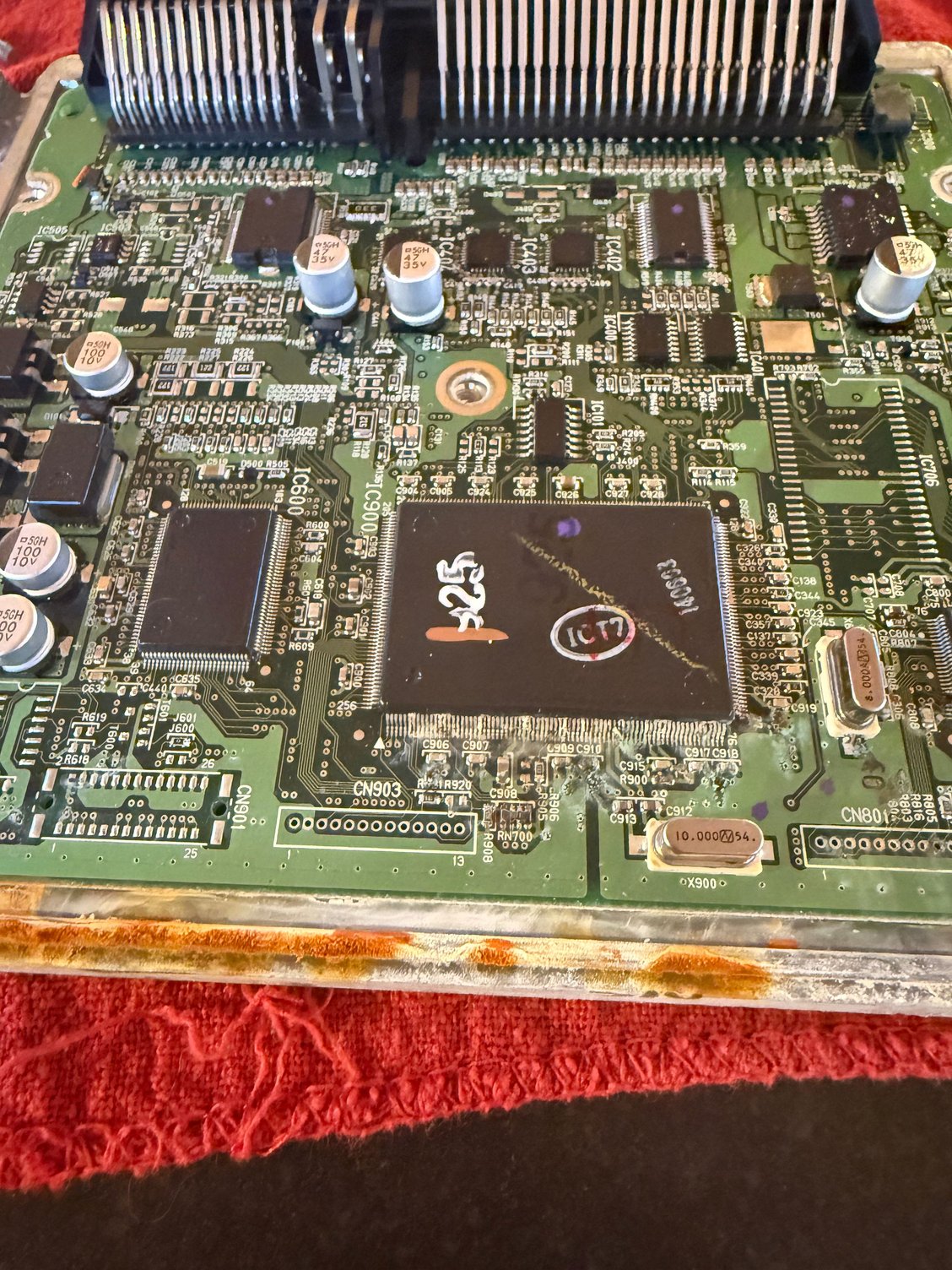

just a followup on my post....dug deeper and went down the ECU rabbit hole and sure enough looks "hopefully" to be my problem. Not a huge deal getting it out bigger deal paying for it but all the time and money I've put in up to this point it would have been so much cheaper going for this from the get go. attached is my ECU sent out to get reprogramed into a "new" one and as per company all should be fine. Will let all curious members know what happens. Happy New Year.......

Did you try cleaning it or are the traces damaged ?

Ouch, that is in rough shape.

my terrain response and height switch looked like that, some time with some electronics cleaner, a toothbrush and a soldering iron fixed it-but those traces do look rough.

The traces bother me less than the IC legs that are corroded. I fix stuff like that all the time. But the legs are usually aluminum and once they corrode, its pretty much game over for that chip.
