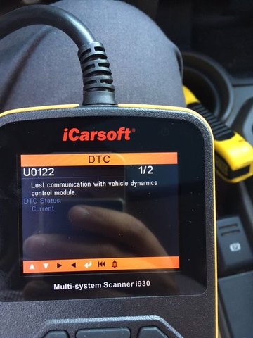

Thanks for the suggestions. I ordered the iCarsoft Land Rover tool from Amazon, and read the codes below. I also took it to a mechanic who read codes using his laptop (screenshot). I would greatly appreciate the help.
I'm wondering if I must take it to a dealer for further diagnosing or not.

Thanks much for the suggestions. These are the codes I received using the iCarsoft tool, and would greatly appreciate any suggestions.
U0122
Attached Thumbnails HDC Fault & Suspension Lowered-img_1908.jpg.jpeg   HDC Fault & Suspension Lowered-img_4003.jpg

I would't worry about the "Loss of Communication" faults. When certain faults are stored, the vehicle will disable communications to other "related" modules so they are disabled as well. Usually when you fix the root failure, the communication codes will go away.
The two codes you have are for the Pressure Sensor, and if the wiring is OK, then you probably just have a faulty sensor. I'm not sure if the sensor is available separately from the valve block. We usually see valve block failures, and a new one comes with a sensor.
