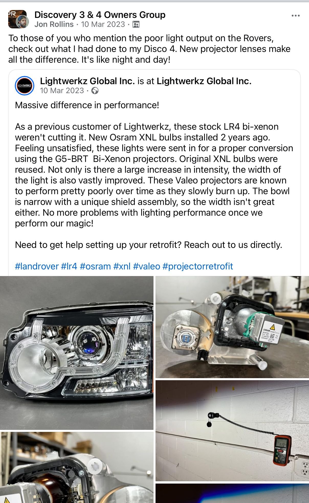

At some point there was a shop who did upgrades to D4/LR4 lights by replacing the projectors. I’ll see if I can find it.
Needless to say it’ll make your lights illegal, not for road use, etc. etc. so YMMV. Same with changing HIDs to LEDs
Old Feb 20, 2025 | 02:33 PM
kajtzu's Avatar
Joined: Jul 2019
Posts: 315
Likes: 83
From: Helsinki
Best I could find and this is of course for the LR4. Perhaps ask them if they’ve done anything for the LR3?
