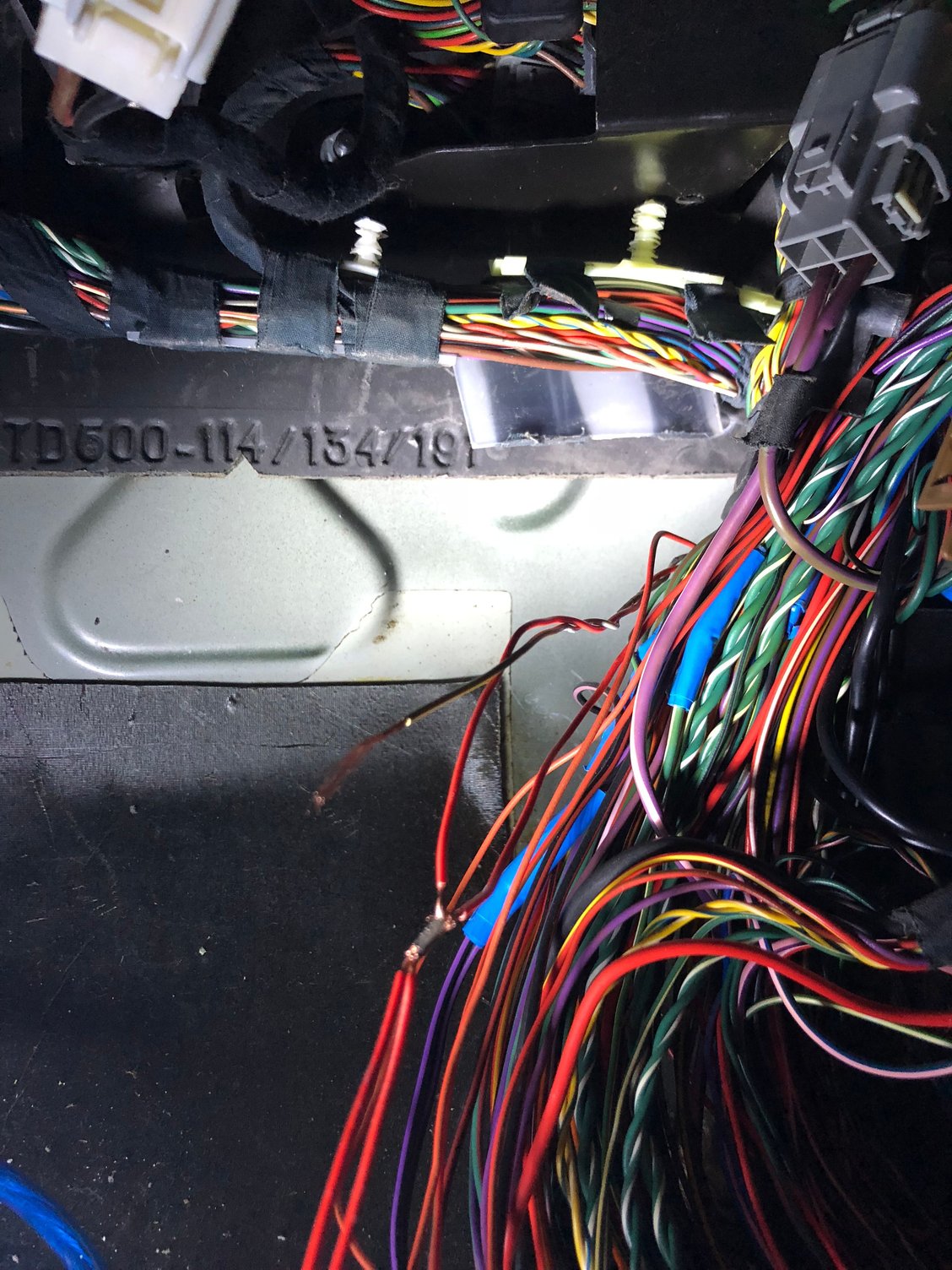

Broken wire passenger side “A” post. Appears that this light brown wire goes towards the driver side in the wire bundle above
Based on length, looks like the wire hooks up to this connection.

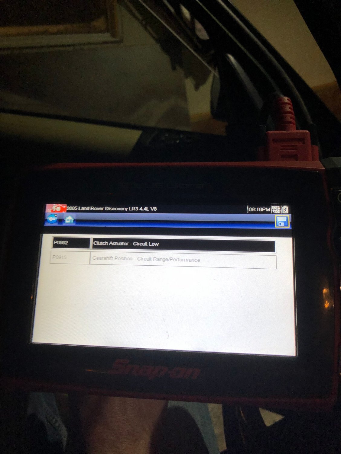

I am thinking these 2 codes are causing my issue. Any suggestions where/what to look for or test?
