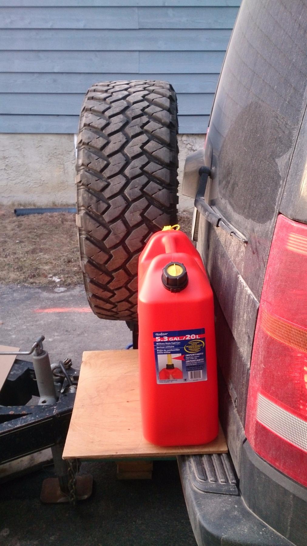

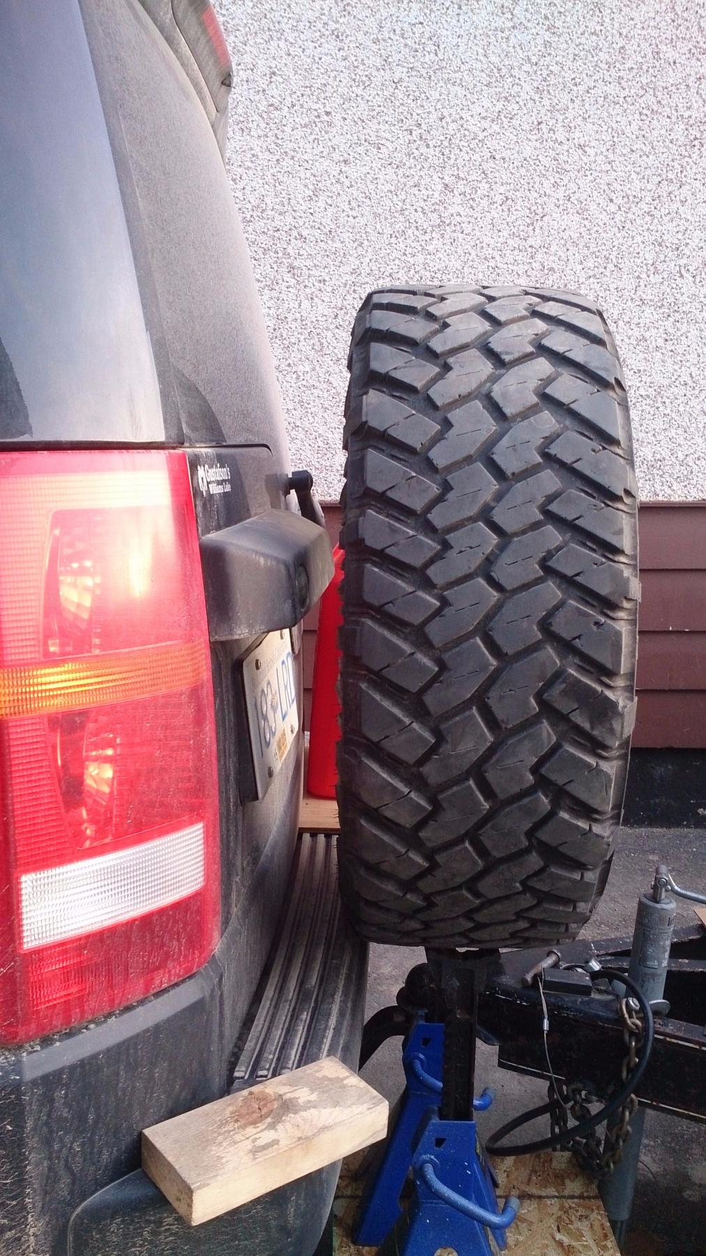

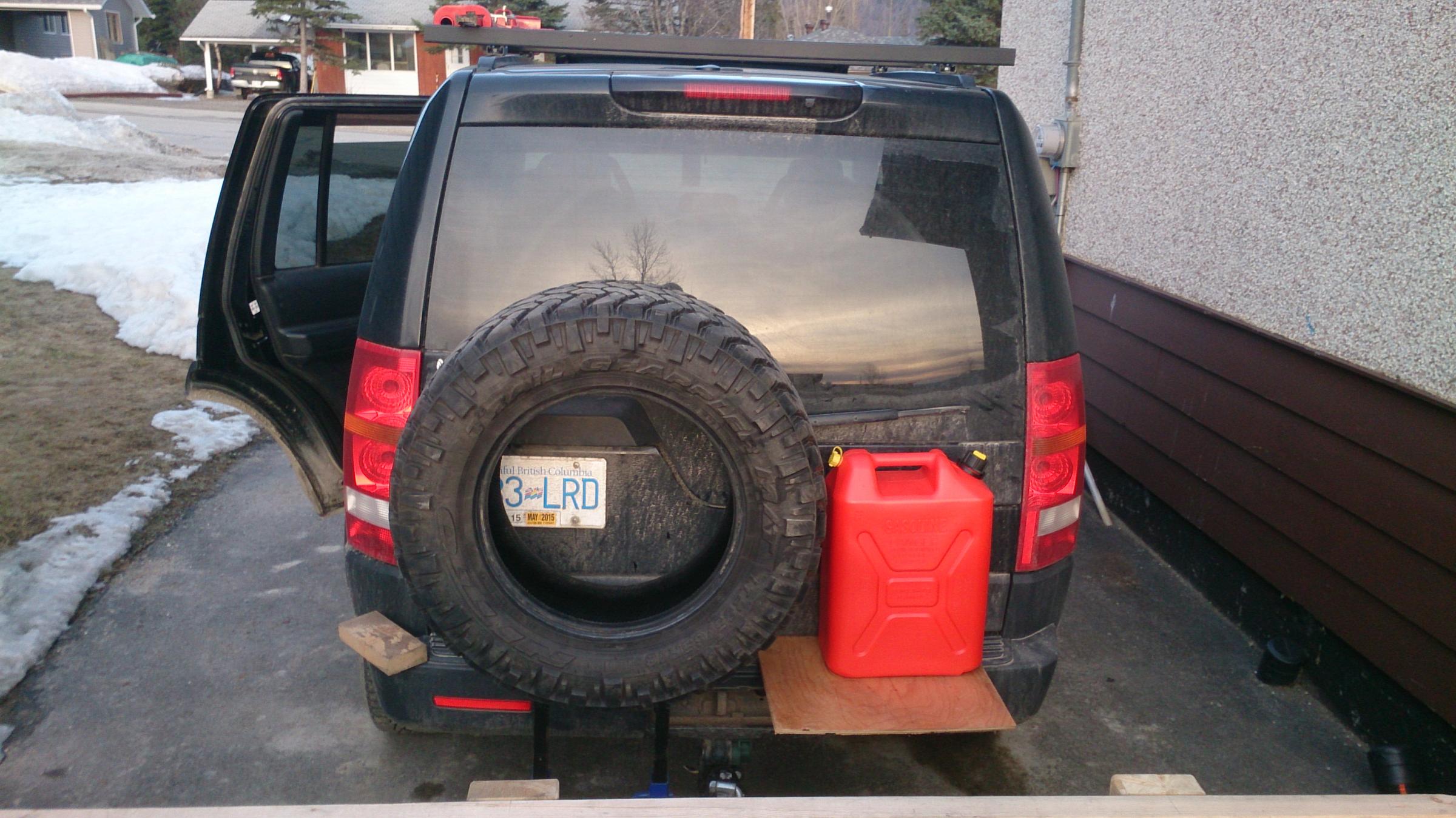

I found that mine were hard to deal with (even with the larger 7/8" socket) and decided to spend the money on new lug nuts to avoid the frustration. New lug nuts are not cheap either; at $10.50 each, I replaced all 20 at a cost of well over $200CAD from the nearest LR dealer. I kept half of the old ones as spares. This will come in handy for when I fab up a rear bumper tire carrier (with a double jerry can holder, pic shows one, but I will mount two).

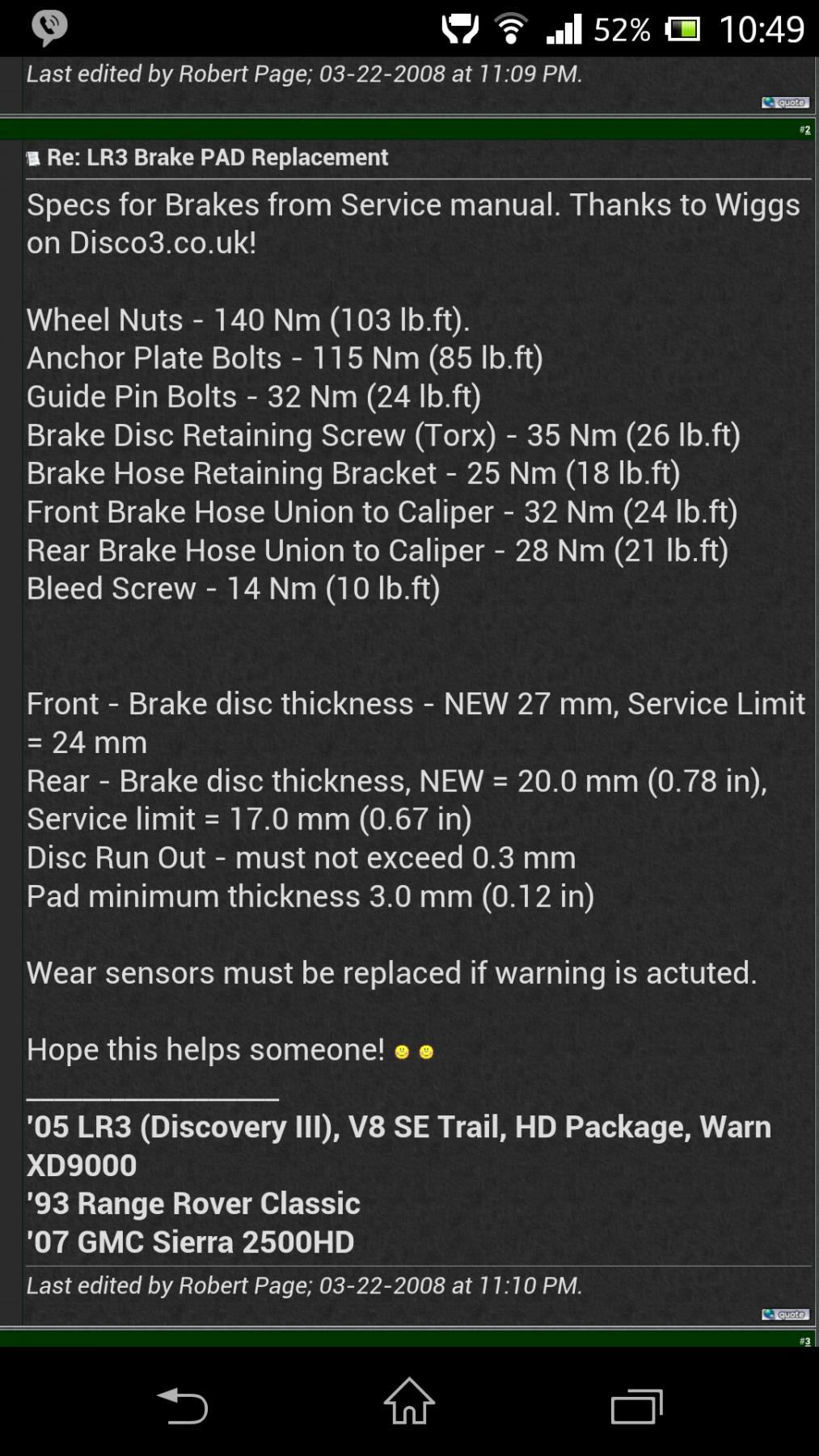

As for brake pads, you get what you pay for. Consider your needs. Are you on steep terrain, off road, packing a large payload, or towing a heavy trailer? I went middle ground on mine as the local parts store had three choices.
Before you order up the parts for a brake replacement, consider the following:

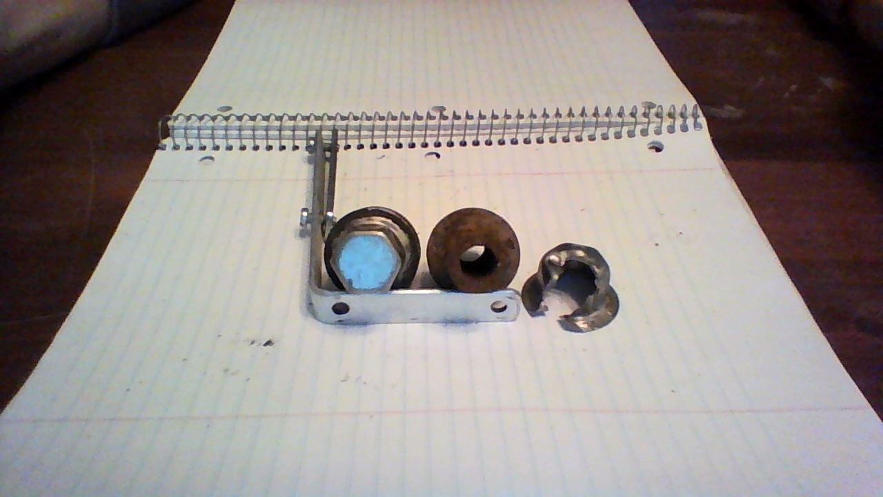

* Brake pad wear sensor (one on front left and one on rear right). Sometimes these break. They are kinda flimsy pieces of crap plastic and wires. I replaced the rear and the light stayed on, turned out the wires on the front were basically (but not completely) broken, the new one is on order.
* ABS/wheel speed sensor. I have a post somewhere that refers to the replacement of these sensors. Mine were corroded so badly that the only way to remove them was to break them off and carefully drill out the remaining bits. Then clean up the bores and install the new sensors. Time consuming, but it worked out just fine.

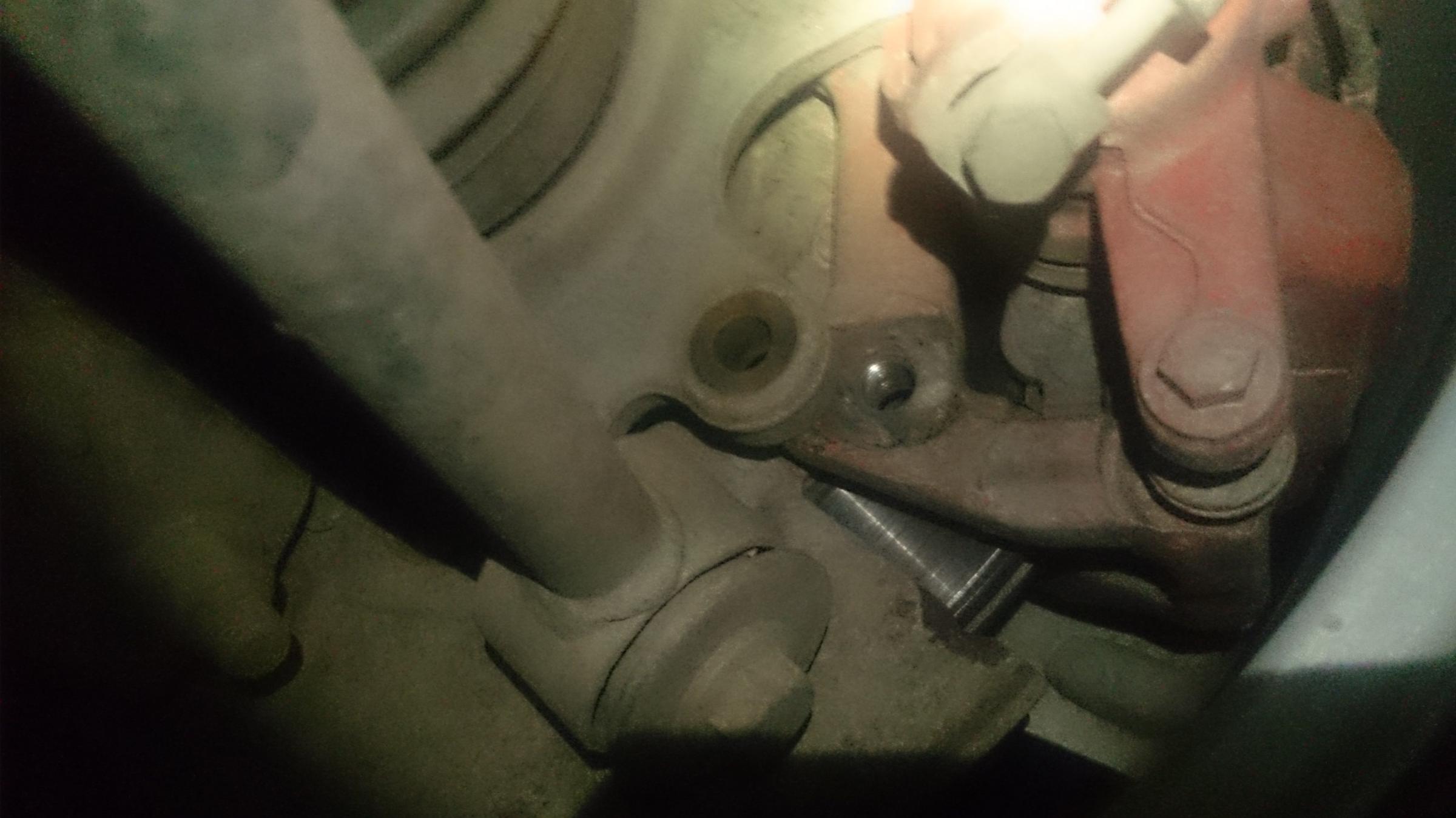

* TORQUE YOUR HARDWARE!! IF YOU DON'T OWN OR HAVE ACCESS TO A TORQUE WRENCH, MAKE IT HAPPEN. DON'T LET THIS HAPPEN TO YOU. (Yes this is a picture of my own LR3 up a mountain with the damn caliper bolt MISSING. This is what happens when you get distracted mid job and don't double check. I ended up up swapping the upper bolt to the lower hole and limping home like a beaten dog. The damage was mostly to my pride, but the inside of the wheel has a nice scar to remind me that I own a torque wrench for a reason.) Also, an impact gun is not a torque wrench, the video showed very little of the 'actual' work being done; but on every bolt, the impact gun was rattled up with no sign of a torque wrench. This is fine if you like drilling, easy outs and re-tapping holes when bolts break, or you break the heads off the next time they are removed. Real mechanics use tools. Beg, borrow or buy. Sorry, but this is a pet-peeve, especially when the tire shop strips the lug bolt hole in the rotor of a VW, all due to laziness.
