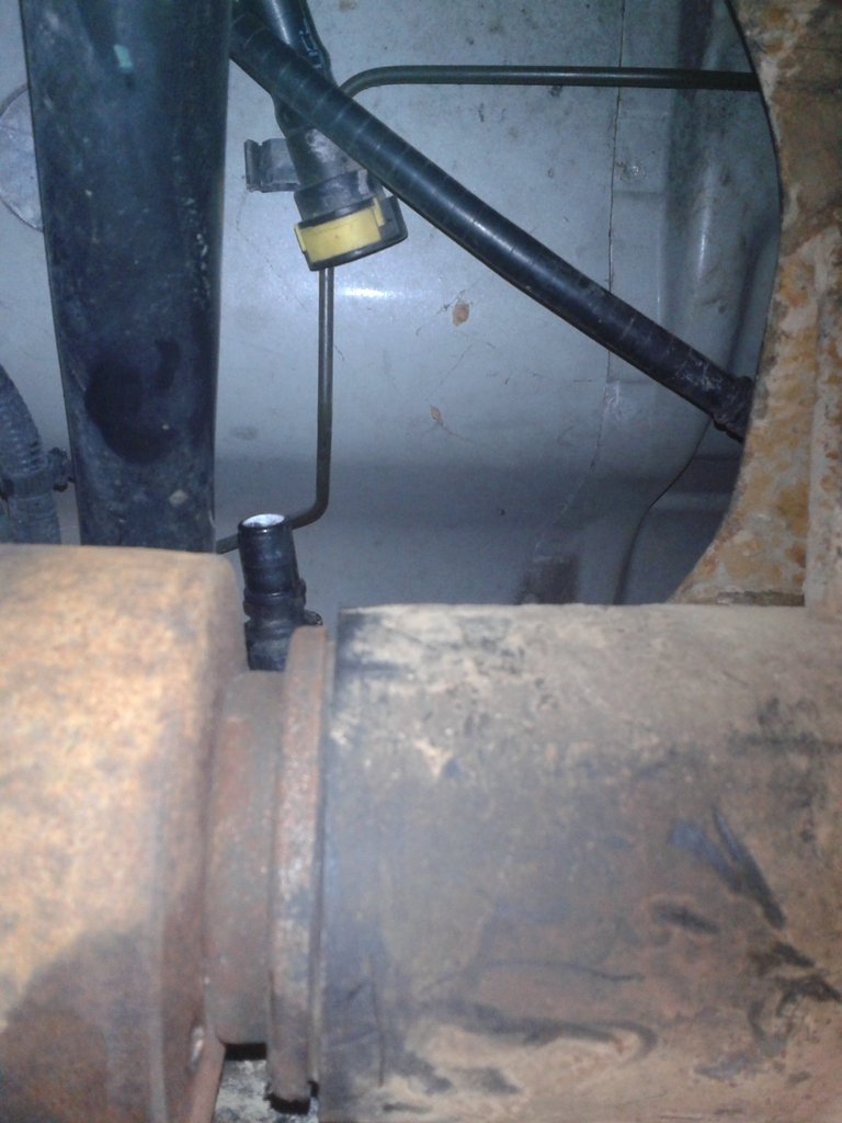

Next there is a large line with yellow disconnect above diff, press yellow, wiggle and pull

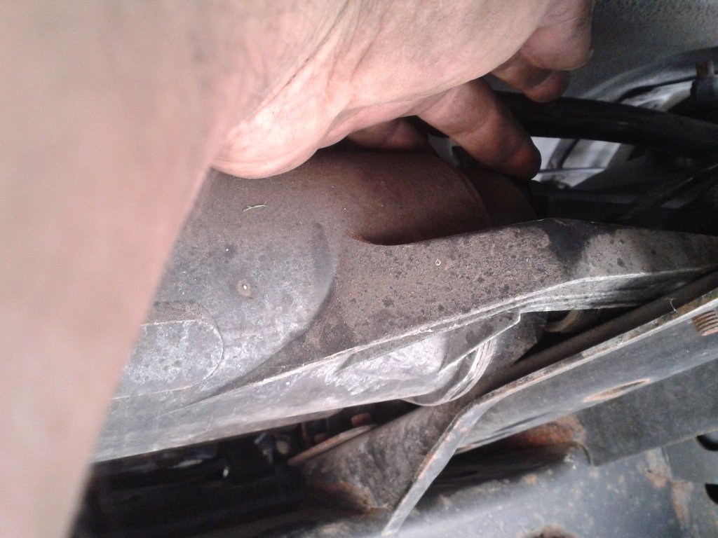

Next is a line on charcoal canister above diff, you access it from spare tire area my finger points to it

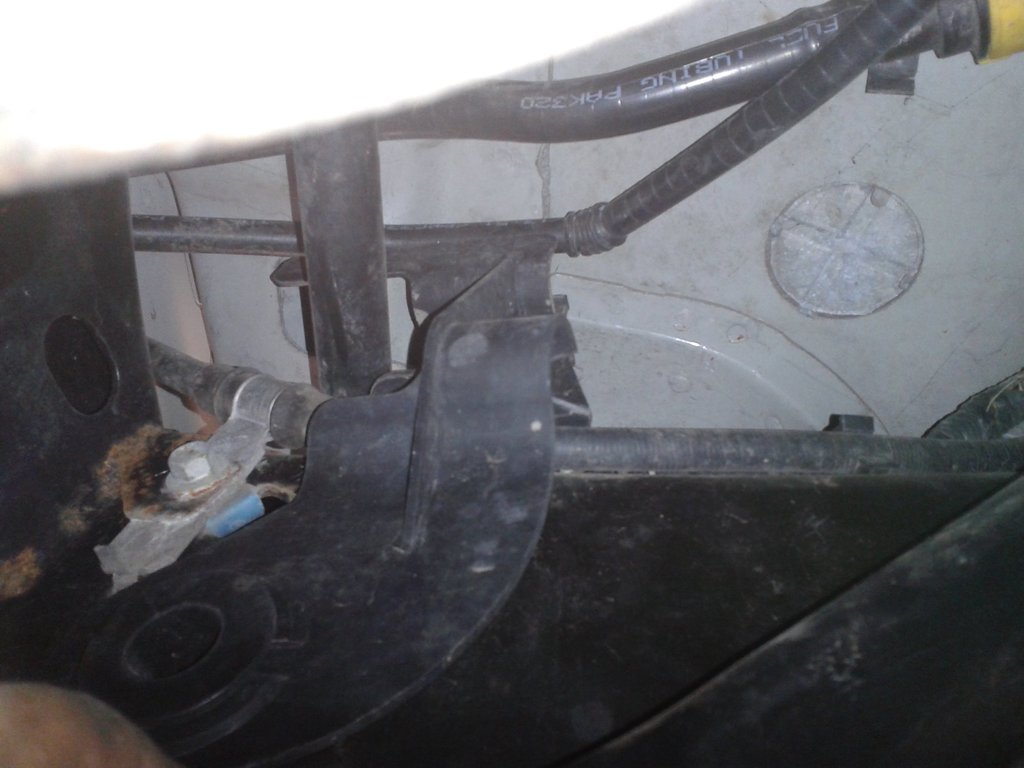

Next unhook them from this black plastic bracket, you will need to fish these out as tank is dropped ESP the charcoal canister one that loops around, here is bracket

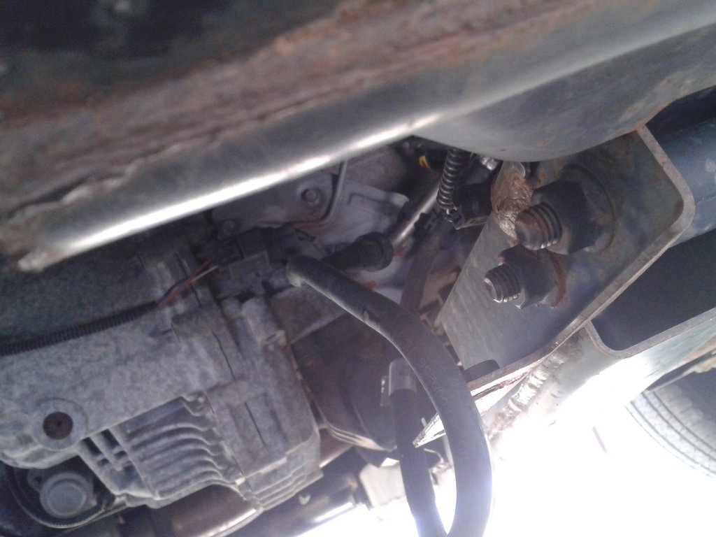

All that's left are 2 lines in front
Use extreme caution system is under pressure gas sprays out of this line it is quichk disconmect squeeze twist pull
