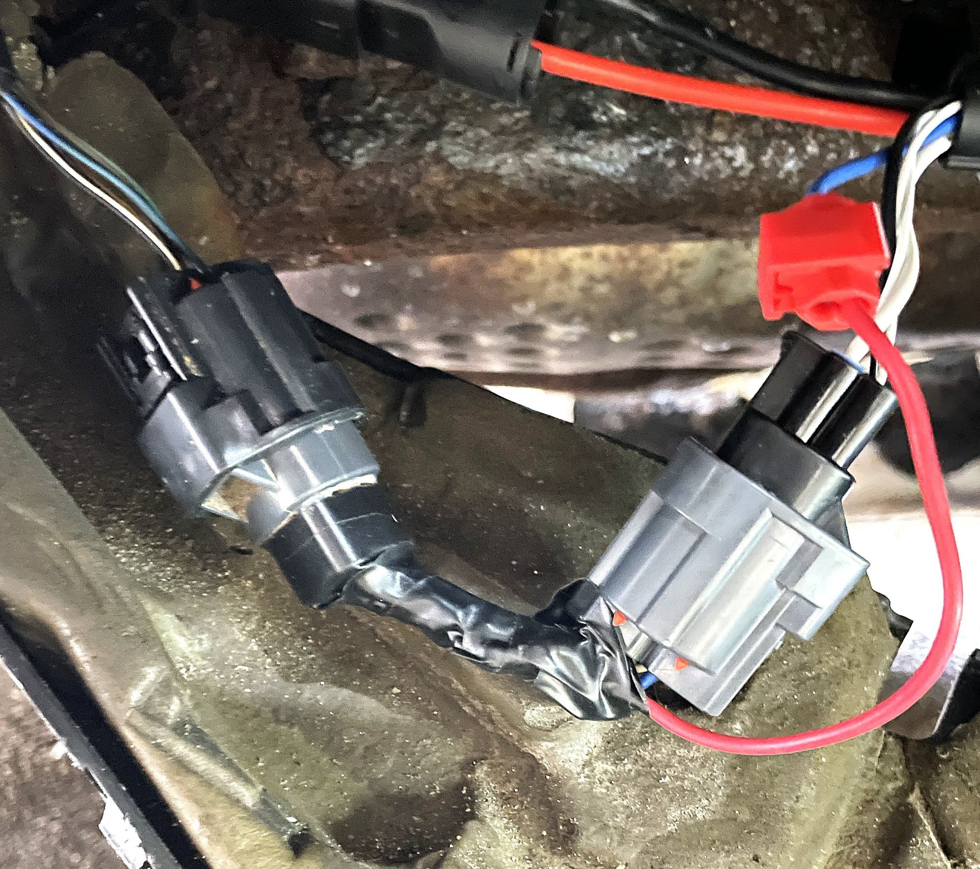

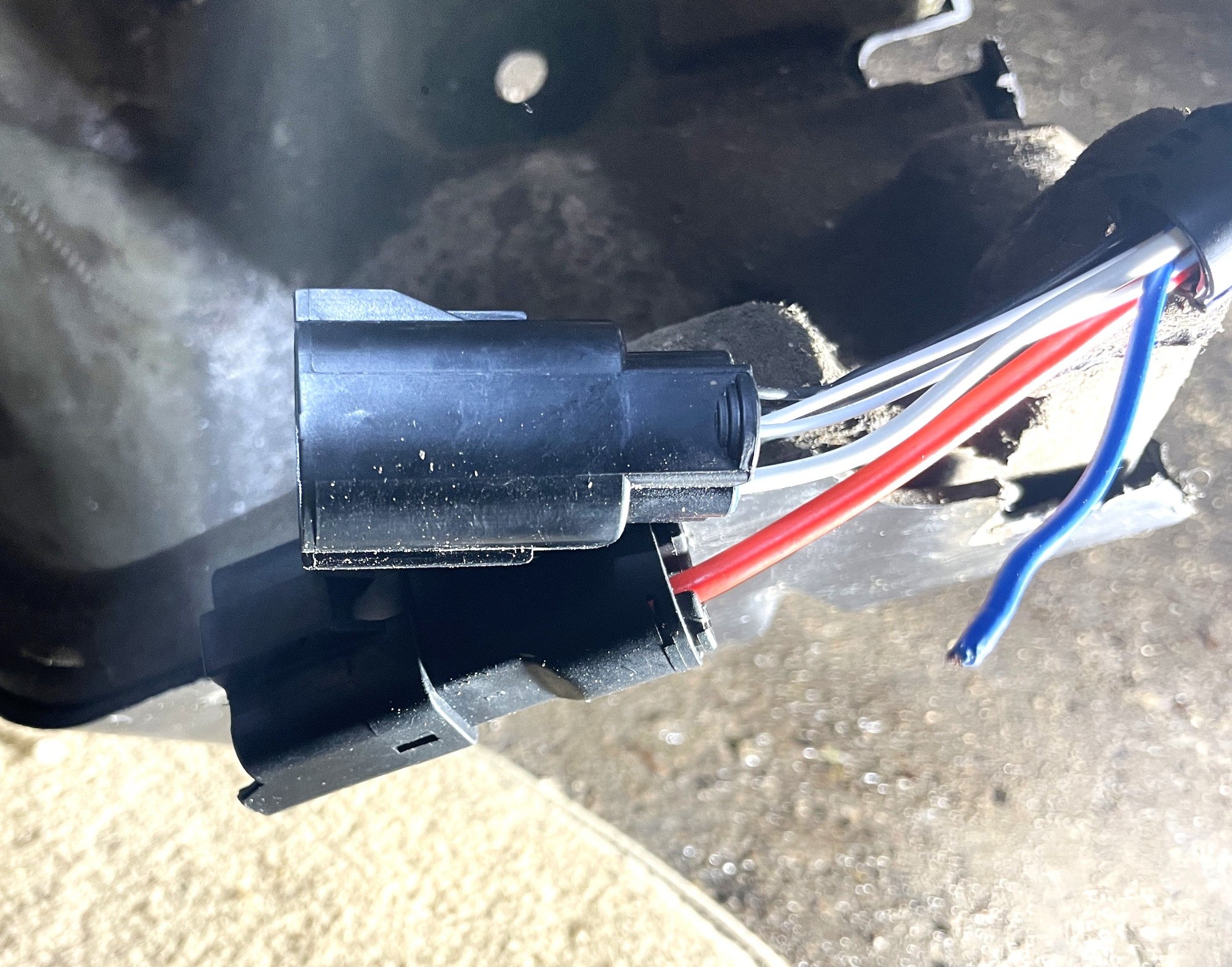

The blue wire for the exhaust solenoid had come out of the connector. No connection there causes instant error and refusal to engage the compressor. If you were listening you might have heard the shout when I found this out!

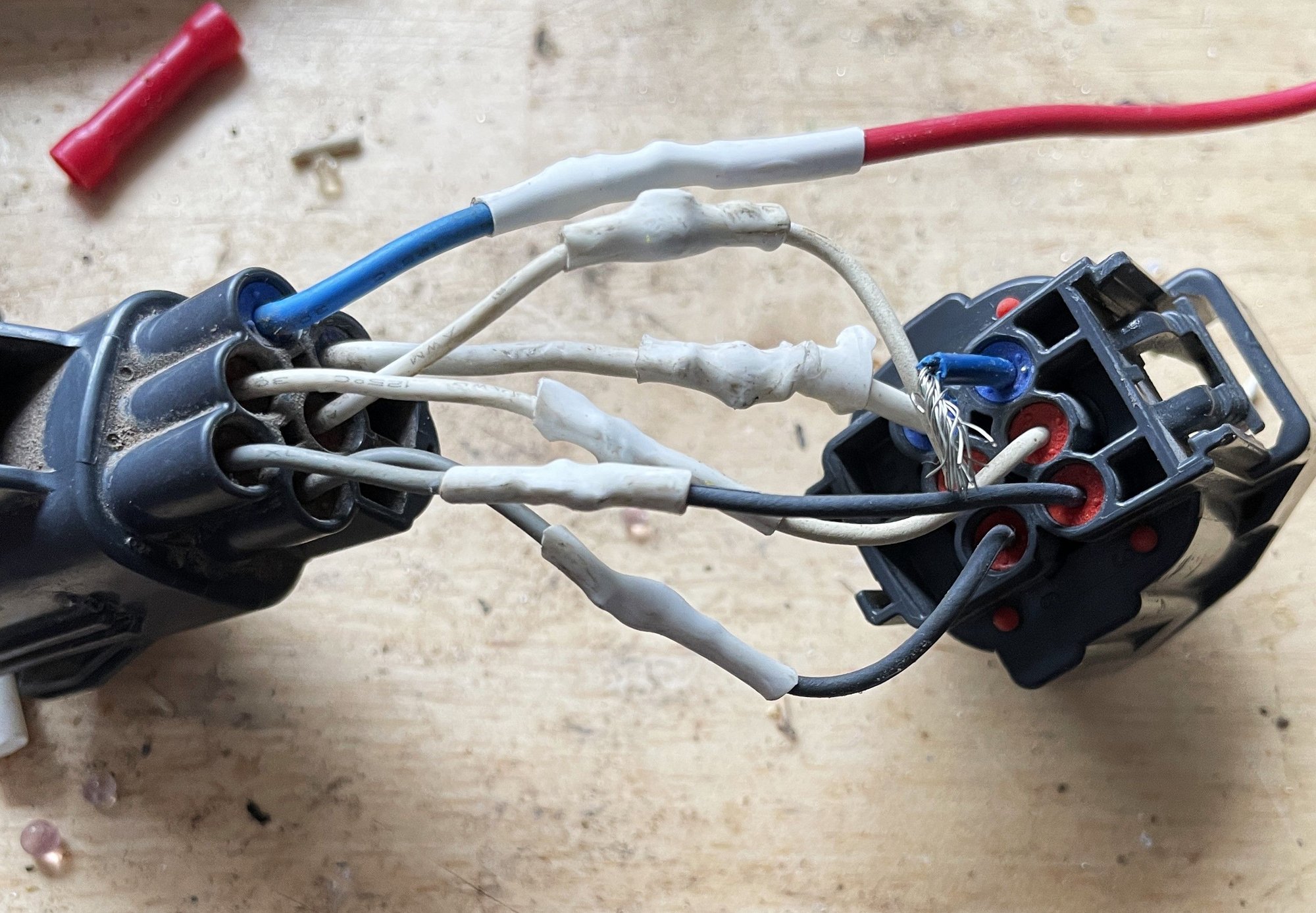

I considered maybe pullig the pin and reconnecting the wire but I don't really have the tools to remove harness connector pins and figiured if I tried I'd just make a hash of it. Along this journey I had found that a FFRR Hitachi pump uses an opposite plug for the controls so you can't plug it together, and I had rewired the connector from an LR3 pump as needed....but since I had both genders of connector on hand I could build me a pigtail!
red wire goes to blue wire on pump
Having to make this pigtail meant having to find my soldering iron, solder and shrink tubing which I have cleverly hidden from myself in different locations. This expanded a half hour job at worst to an hour and a half, and unexpected profanities. My cuss jar overfloweth. Once done though, I have this!
pigtail and scotchlock as we call them here
So I didn't have to cut up my vehicle side harness.

Range Rover l322 pumps will work but you will have to change the 6 pin connector. Cut it off your LR3 pump. You might want to keep both plugs, just in case.
