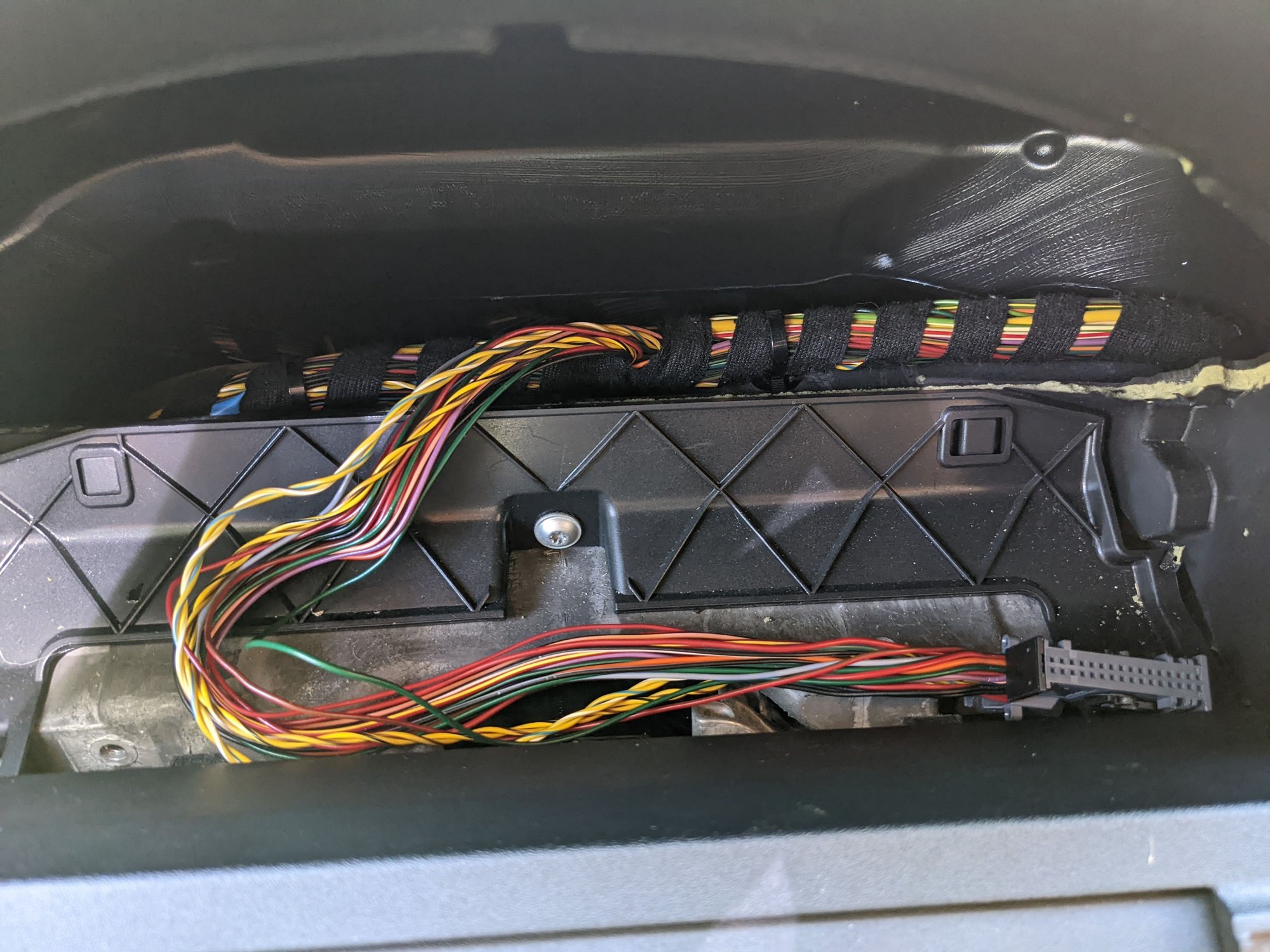

08 LR3 V8 SE. My instrument panel isn't working. More often than not it has no power so all screens are blank (no backlight either) and the gauges don't work. I peeled back the tape behind it as far as I dare but I haven't found anything that looks damaged/broken. The instrument panel will come back on sometimes if I knock on it, and it used to come back on more reliably if I wiggled the trip reset button. The only lights that work consistently are the parking brake light, and the red light that flashes when the car is off (anti-theft?).
Any ideas before I buy a replacement cluster? Is that the next logical step? Thanks!!

Used ones on eBay are sup risibly cheap, often seen for less than $100 USD. They have to be encoded over though using a GAP tool or such. If you feel adventurous, you could open it up and check the solder points on the connectors. There are a few that develop colt joints (tiny crack in the solder). Can simply re-solder then and see if it helps. I tend to doubt it is an issue further down like wiring, especially with that much going out on it.
