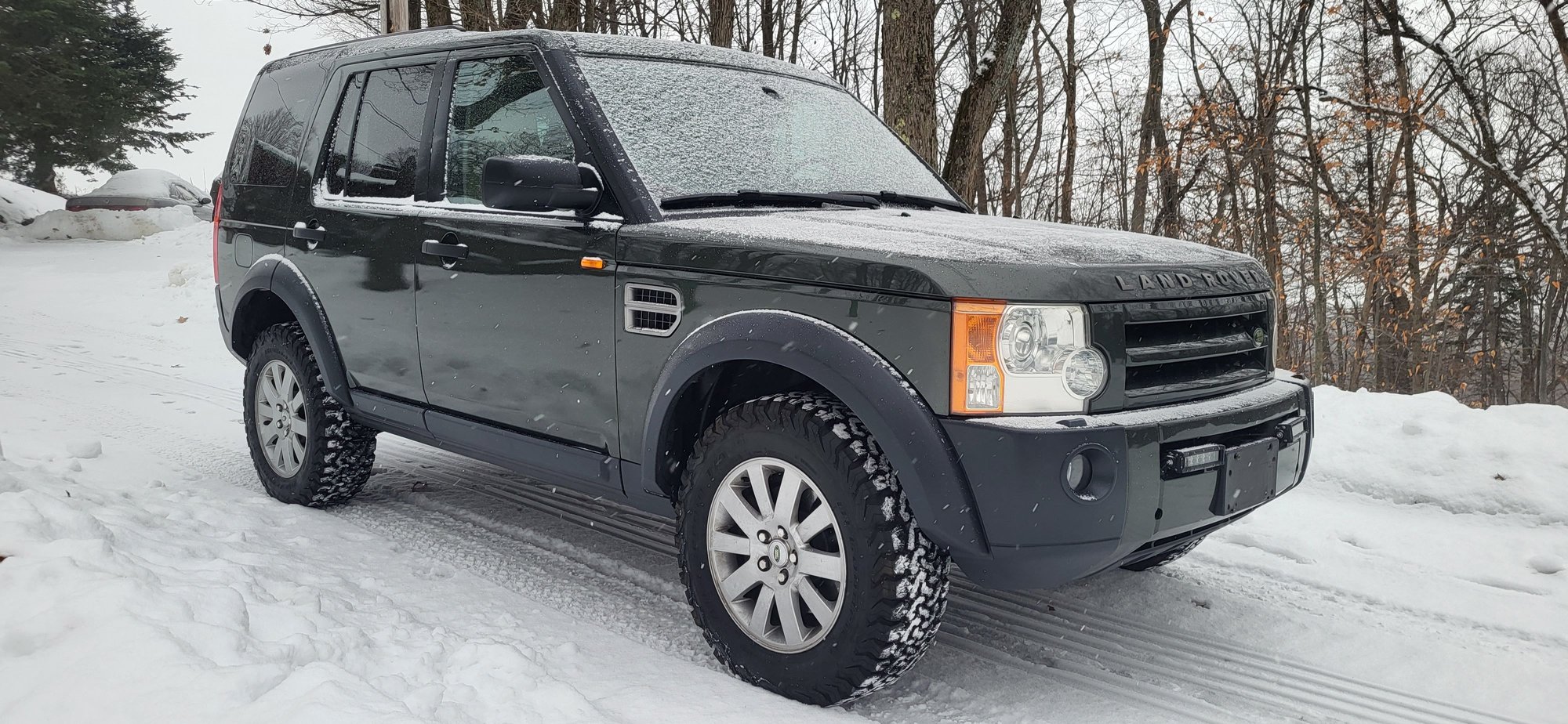

I'm trying to access the setting menu (controlled with the track/volume steering controls) but it doesn't show up on the dash. So I wanna try to do a hard reset on the truck to see if it will now show up.
Since I have Johnson 1.5 rods on my LR3, can I do the hard reset without "decalibrating" the height sensors or the suspension ? What position should the suspension be in ?
Thanks
Bill
