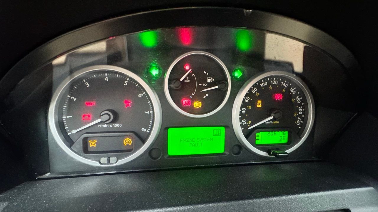

I'm pretty new here, so forgive me for any mistakes. Long story short, I left my sunroof open on a very rainy day, and the console was pretty much under water. After cleaning everything, the only problem remaining was that the D position was always on (and Manual Mode wasn't working either). Well, out of the blue, it got into limp mode (picture attached). Here are the codes I'm getting as we speak:

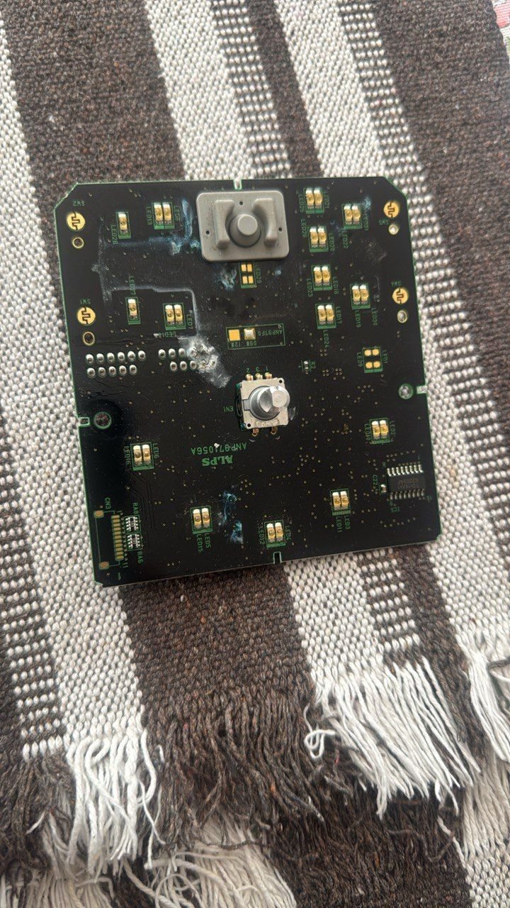

And you were right loanrangie, found a sort of corrosion on the PCB from the terrain selector central console (not sure how to call it). I'm sharing the pictures before/after I cleaned it. Unfortunately, even after reassembling everything, I still encounter the same errors (limp mode). I'm not sure if the board was damaged or not, so I'll try to get one from Savage around here and see how it goes. If any other idea pops up .. please let me know. thx again.

It's been years since I did the same thing with the sunroof wide open in a 2" rain storm. I can't remember my codes from that occurrence. In MY case, I needed to have the "yaw-rate" sensor, which lives beneath the center console replaced in order to get the truck happy again. There are several bits of wiring and such besides the shifter under there. The whole console had to come out.
I had to have the dealership do it....an expensive mistake and a fun 2 hour drive on the highways in only 3rd gear with a lowered suspension.
