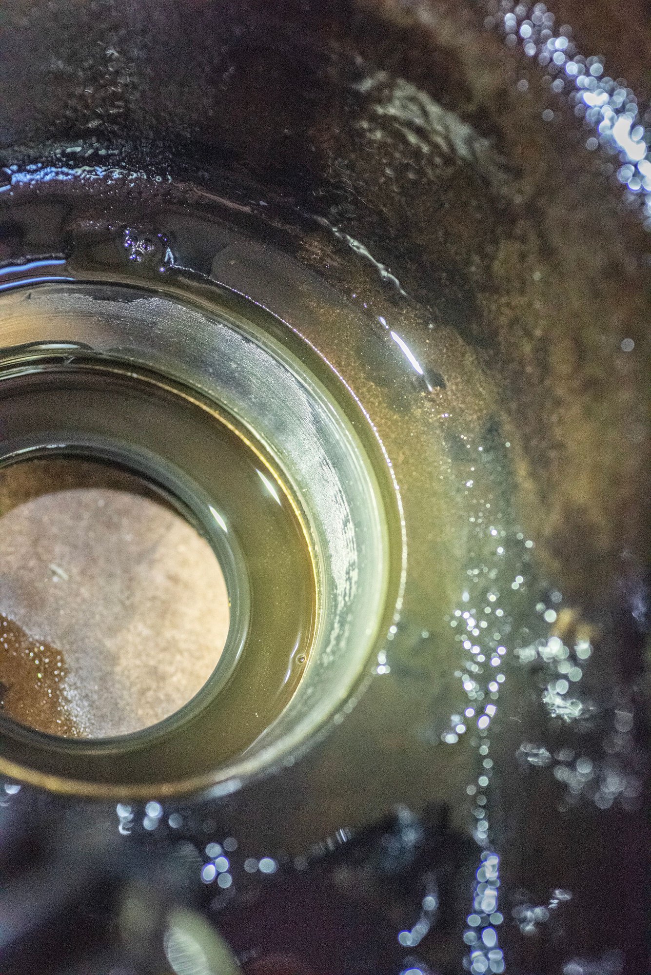

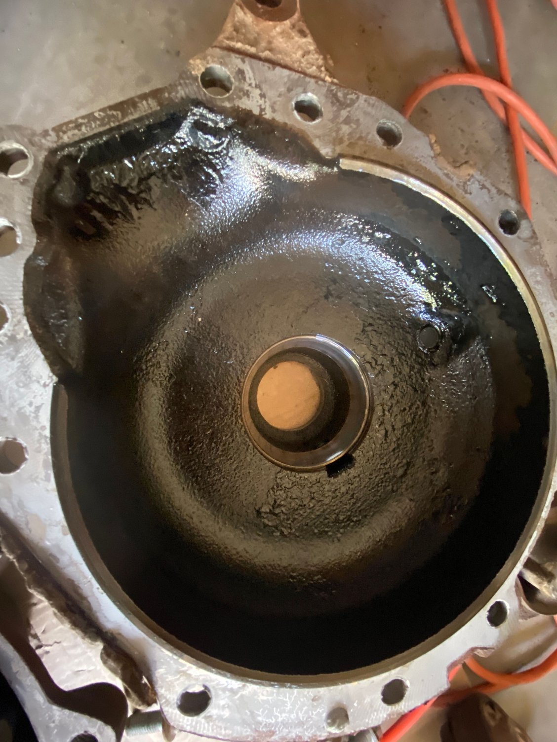

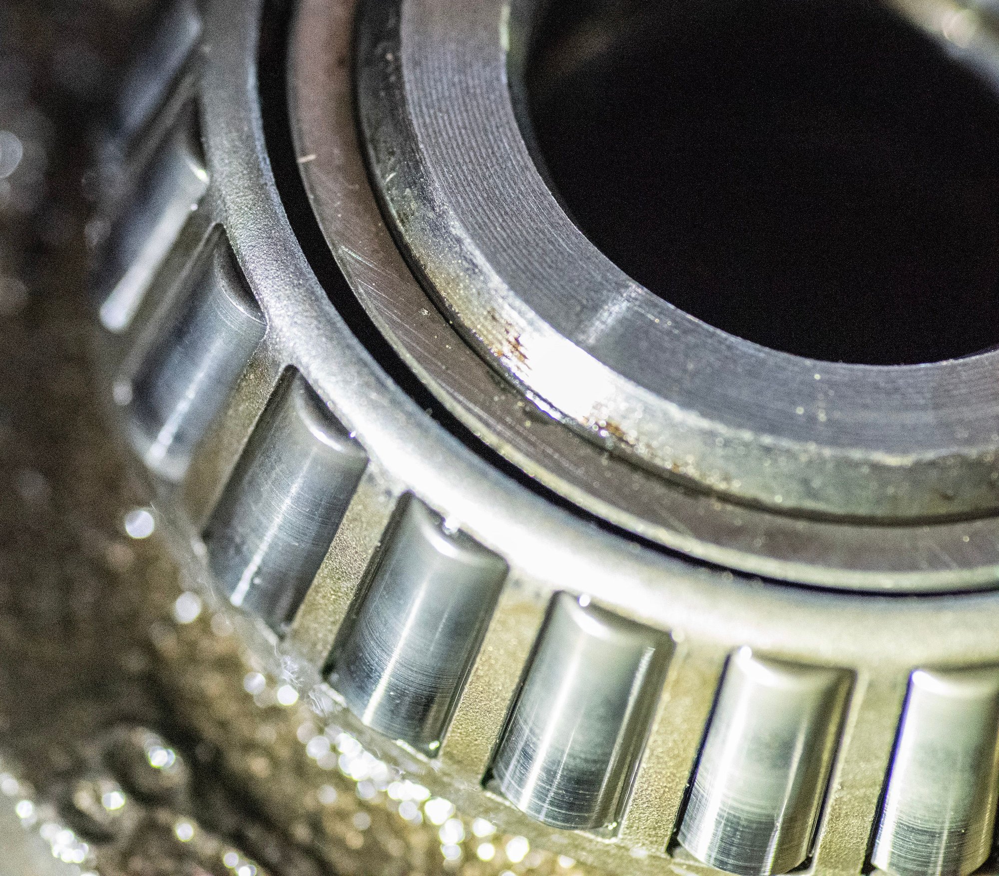

Old diff carnage pics. When I first opened it I was shocked that the black coating did not come off. It was just the poor light inside my garage..... With some light it became obvious quickly that it had come off in chunks. The passenger side bearing was very worn but looked decent including the outer race. The driver side bearing and race though.... pretty bad. And no rust inside that I could see. I am confident this was all caused by the material coming off. Again to recap, this is a 2006 LR3 with 235k miles which started to experience a vibration at speed some time ago but last fall and this spring it was working enough that I swapped CVs only to finally find that at the diff body I could move a CV at the output way too much (video in another thread).
Upon first view, I thought the coating was still in place.

Driver bearing had more than a few examples of this. And if not pitted you can see how very rough they are.
Driver side race is very worn and very uneven in that wear.
Passenger side bearing is worn but not damaged.
