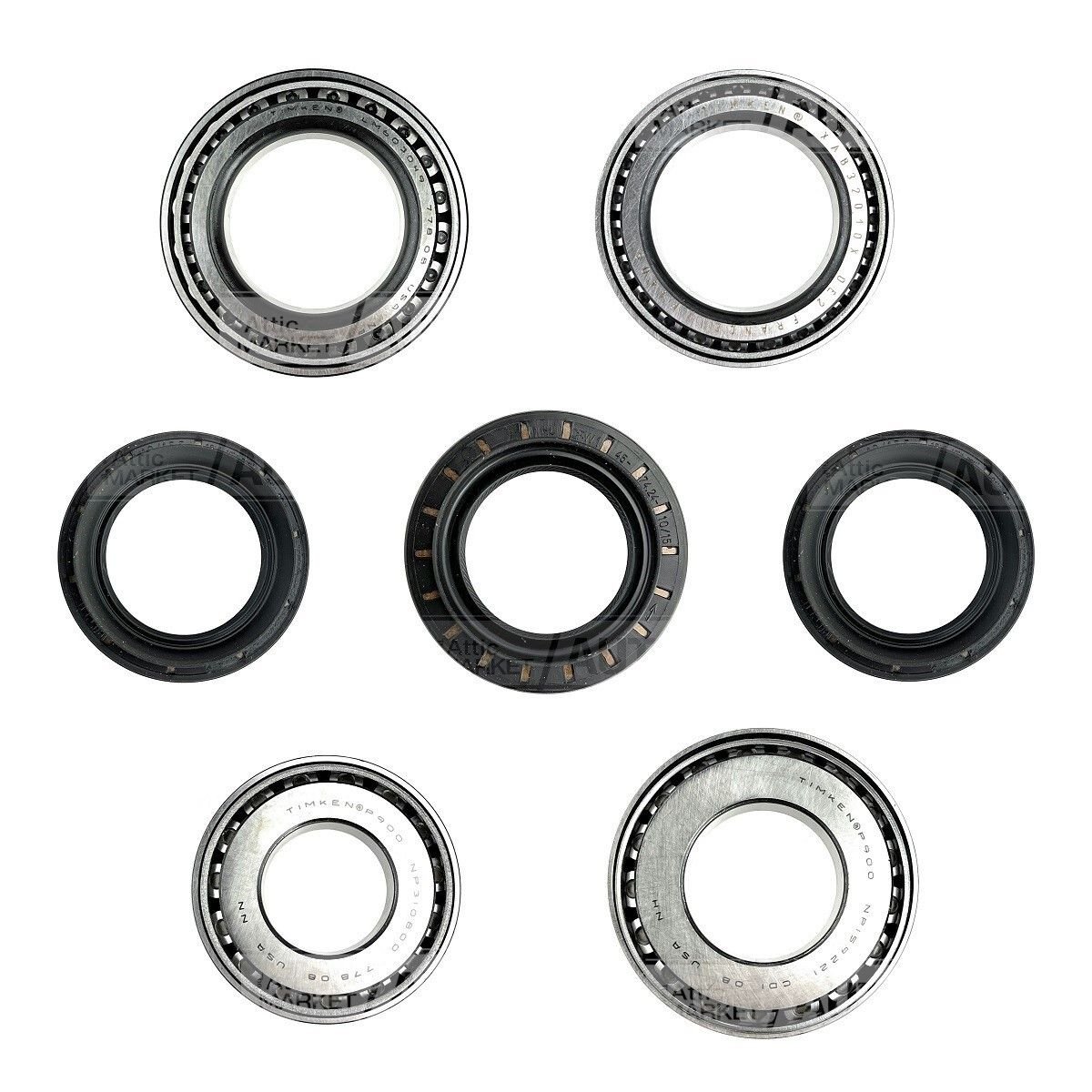

And def check what you need for pinion bearings to be sure. I listed just one, the outer bearing part numbers since that was the only one I could read. Several sources say two of the same are needed but I have doubts. And Rock only lists the outer also, not inner which makes me think in the case of out modified M200 they are not the same for both. My guess in the inner bearing is a Timken NPI59221.
Case in point, note the bearing at middle right. That is what is typically used by Dana from factory for one of the bearings in the M200. Pinion I believe. But a lot of aftermarket kits swap it out for a roller type like in ours because of more contact area and thus strength. Just one more thing that made it initially confusing looking for information before buying bearings.

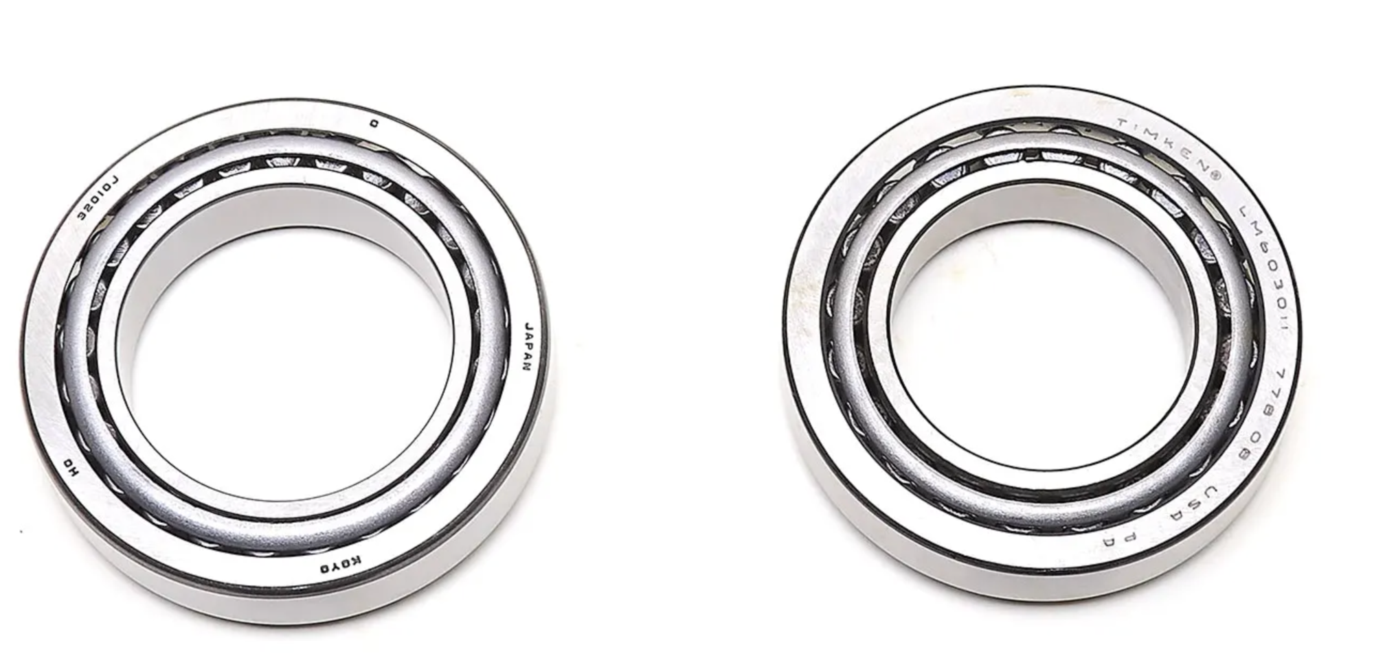

All I can add is that these are the original bearing part numbers I found:
Pinion (two needed): NP310800 / Timken
Driver side carrier: LM603049 / Timken
Pass side carrier: XAB32010XM / Timken
Pilot bearing located in the tube housing: B-268 / Koyo
NP310800 bearing needs NP312191 race (pretty sure it's pinion outer, and it's not the same as pinion inner)
LM603049 needs a LM603011 , together they are sold as SET37
I've noticed that last few weeks AI search summary has been blatantly wrong in many cases, I tested it and something is definitely wrong with it, so I only trust the specs that I can get from manufacturer.
Also on AB site you can make out some of the bearing numbers on DOK007 and they match the numbers you listed

two screenshots below are from Heritage kit DOK007, same p.n. as AB, 3 out of 4 are KOYO, ones I removed so far were all Timken

When it comes to the plethora of kits out there, this one seems to be most accurate to our needs when it comes to a photo of correct parts which is readable. Top two bearings being carrier, bottom two pinion.
