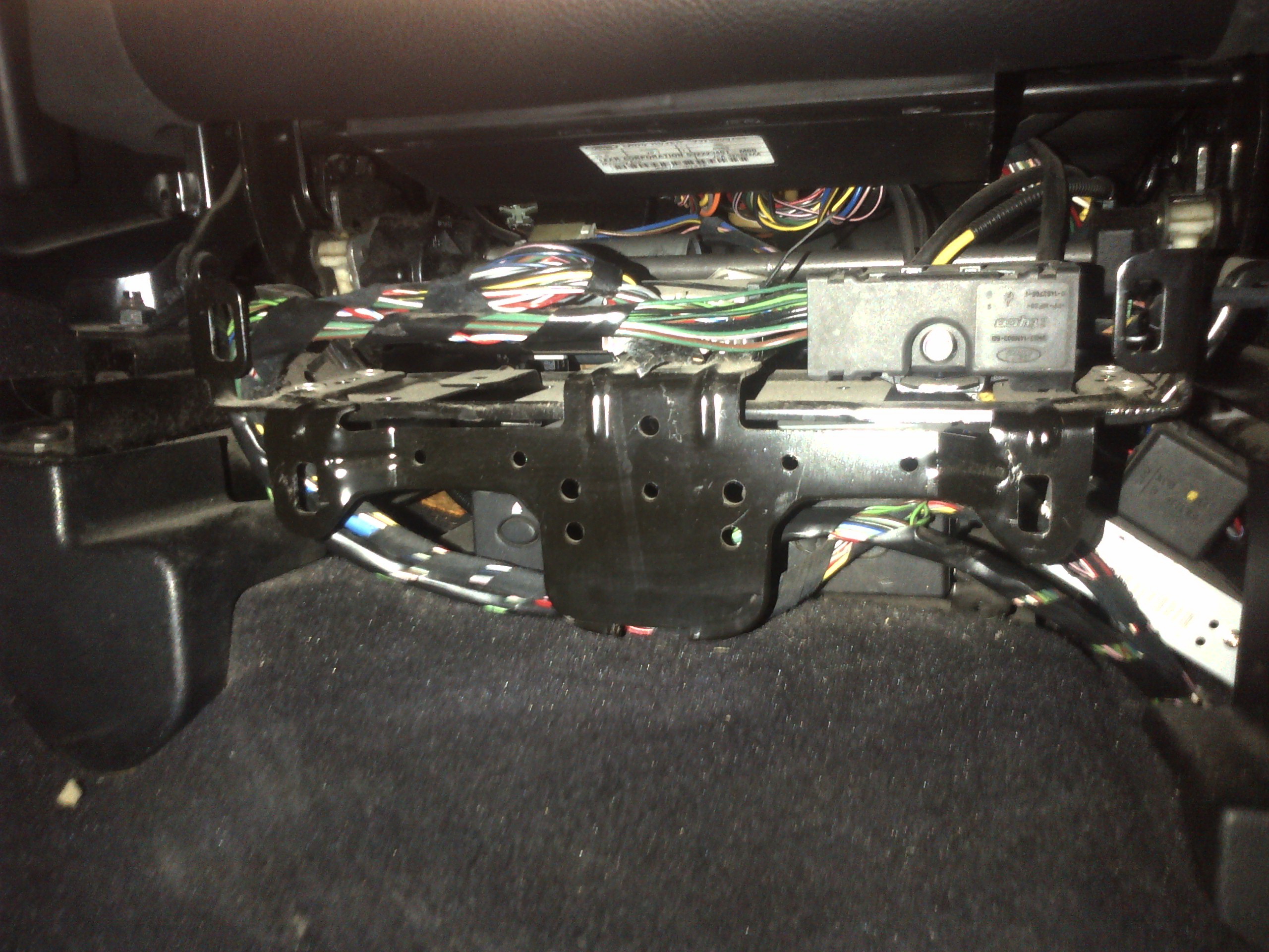

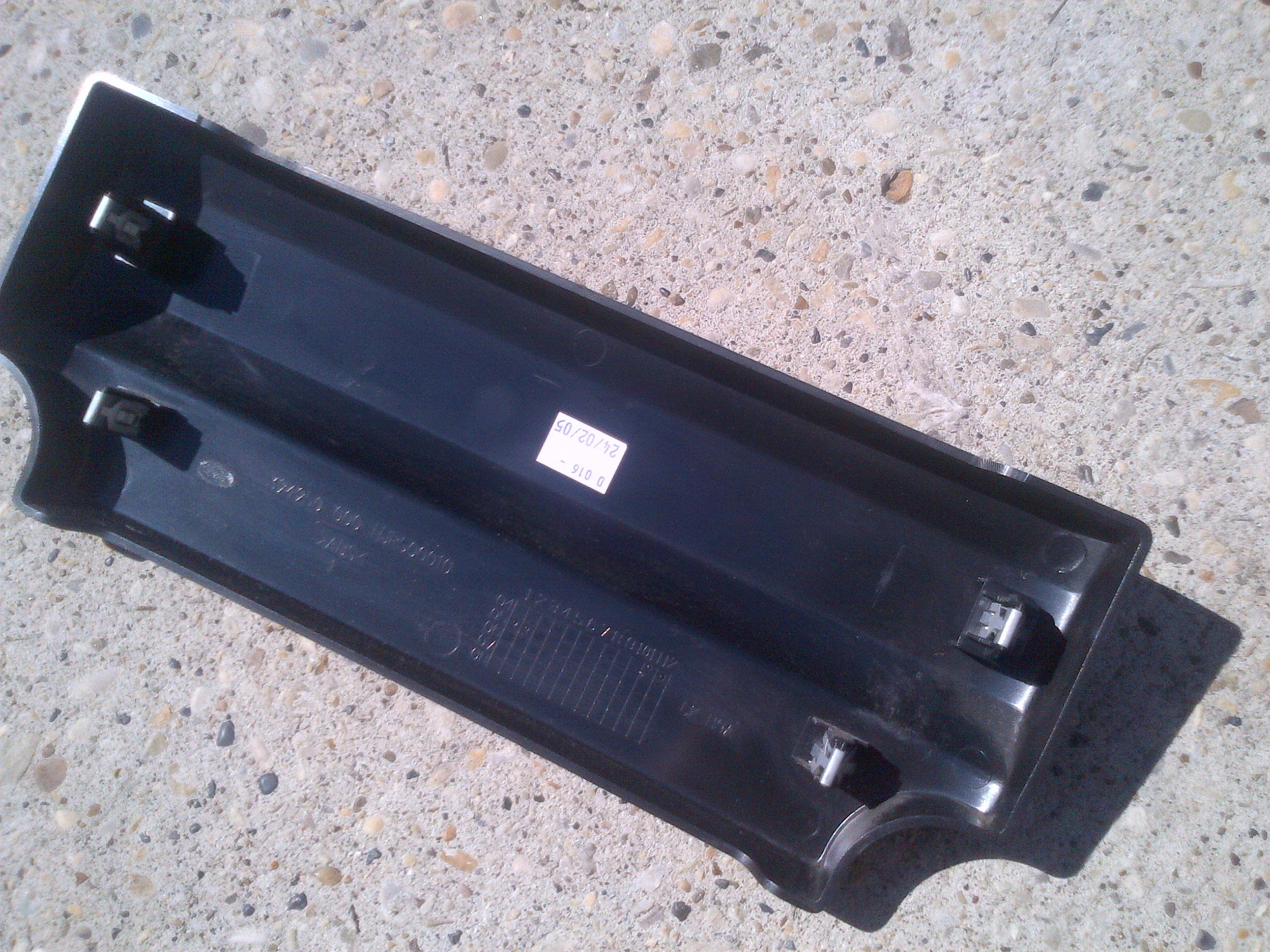

If anyone has a jpg of the backside of that seat fascia and or a jpg of the seat with the fascia removed, seeing them would be appreciated.
If I knew what the backside looked like, then maybe I could get something in behind to pry at.

There are four push-in type clips, small plastic tips with metal v shaped covers. Two on the upper section and two on the lower section. The two on the upper section are a little wider than the two on the lower section. Put a pair of gloves on. And then pull gently by gripping the bottom of the cover and pulling it towards the foot pedals. A Short quick tug will pull the bottom clips loose then do the same with the top. The clips are only about 1/2inch deep. So keep that in mind when you give it a quick pull. Your aren't trying to rip it off. Picture pulling out a nose hair between two fingernails. You will get the idea 😳 Not that I have any experience with nose hair pulling............... Good luck. Phil

I had assumed two, and hence was trying to pull evenly at each end. As you directed, I first pulled from the bottom on the near end first until I detected a bit of give. Then I did the same on the tranny tunnel end of the fascia and felt more movement; then the two tops and the fascia pulled away without too much additional effort.
Attached are two jpg's I took; one showing the panel removed and the other, if you look carefully, you will see the four rectangular slots punched from the black metal cross carrier.
