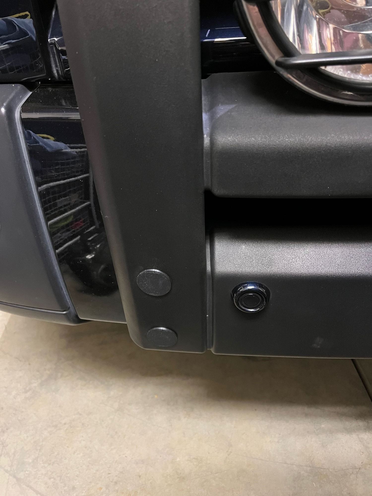

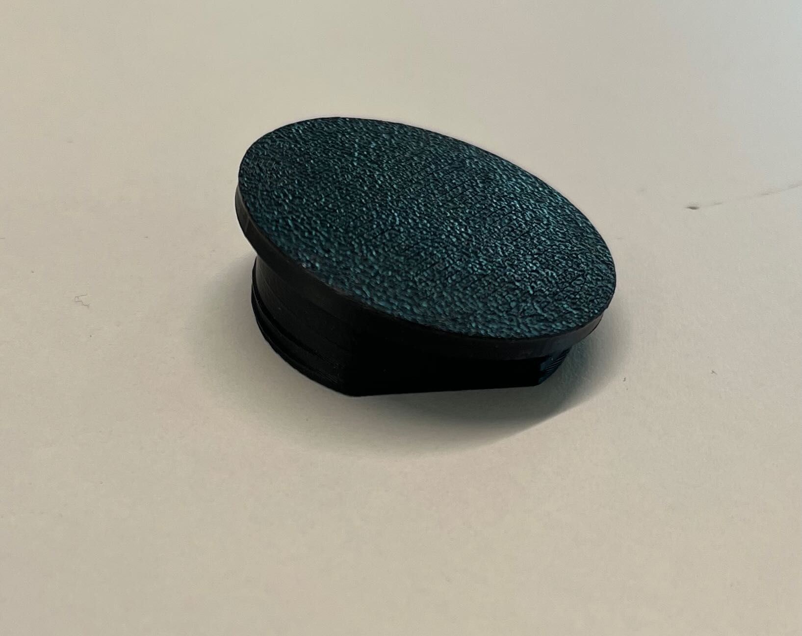

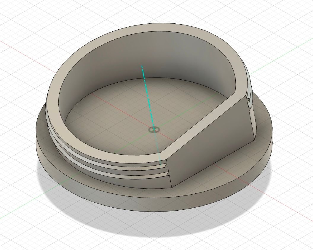

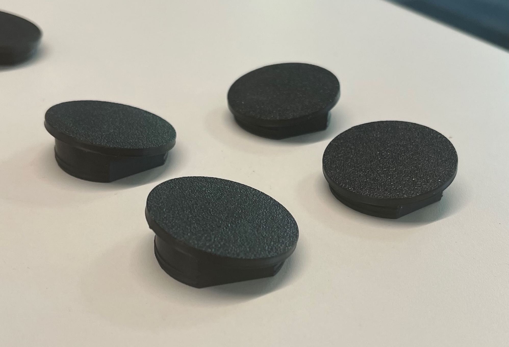

I just freshened up my OEM A-Frame brush bar, fixed a broken bolt, and then 3D printed the plastic caps that cover the bolts. The driver's and passenger side are actually shaped differently, and I modeled the CAD based on an OEM cap I had. I printed the cap on a textured surface for the 3D printer which gives the cap the same texture as the brush bar. I used ASA plastic for its UV-resistant properties and I'm happy with how it came out. I think PLA plastic will also work, especially if you treat it with something like Solution Finish black trim restorer to keep it nice and black over the years.
Here is a folder with the step files and gcode files which I used to print on a Bambu Labs X1E printer:

Good work, PLA would last 2 minutes in hot sun so at the minimum i would use PetG but ASA,ABS,Nylon or really any UV resistant filament would work.
