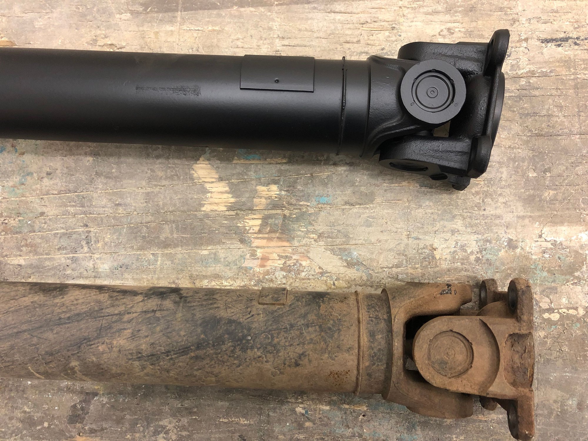

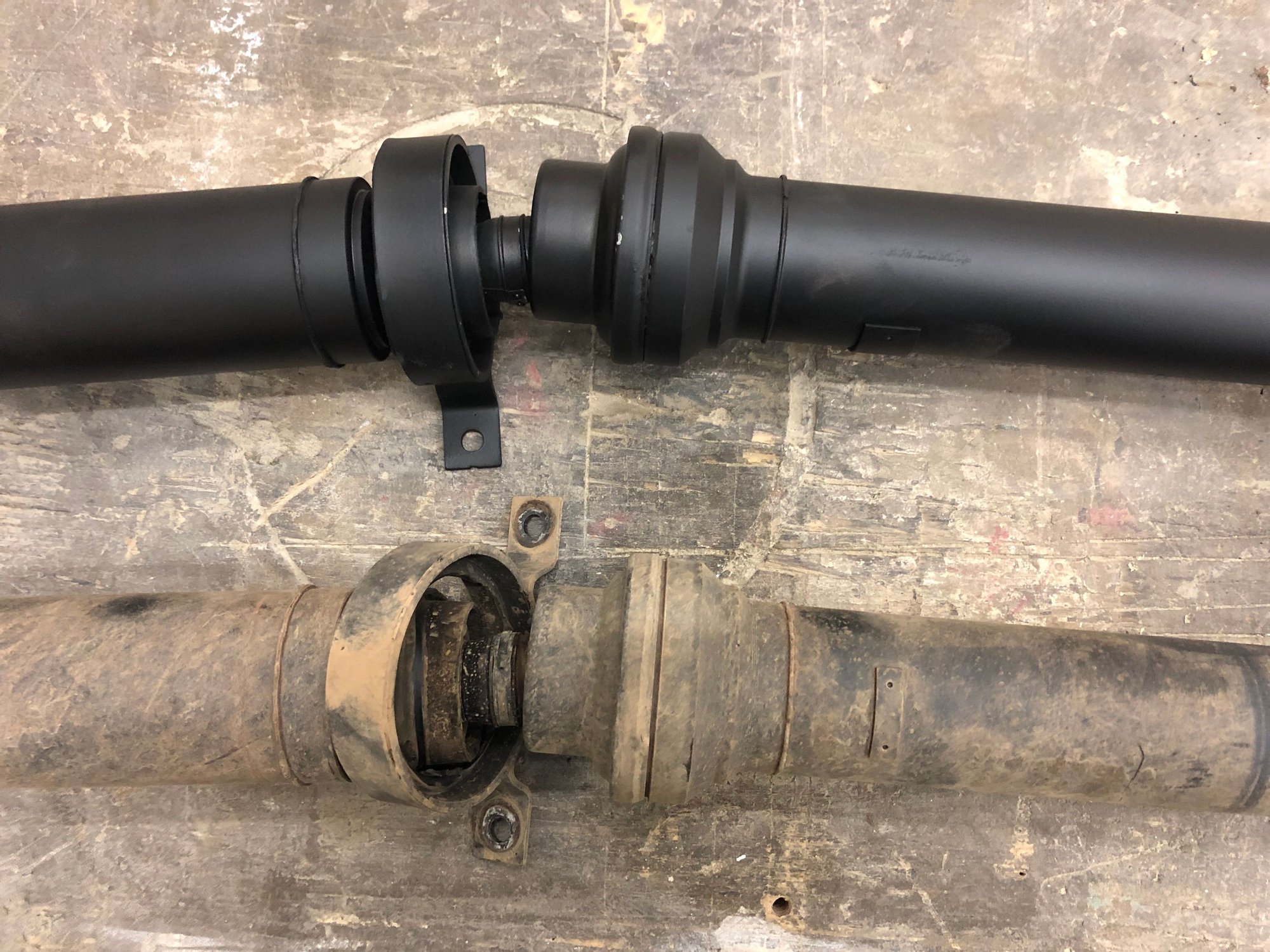

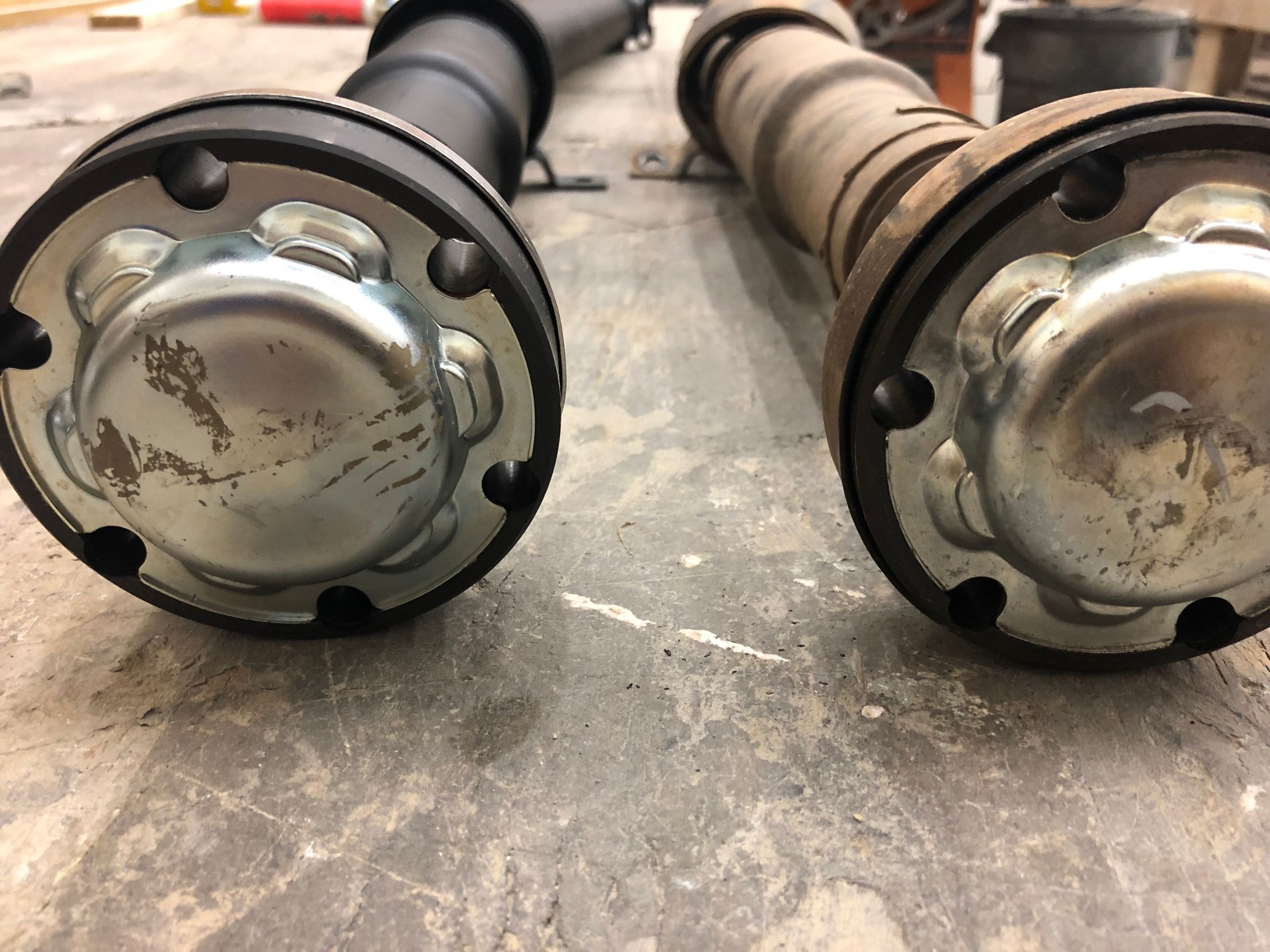

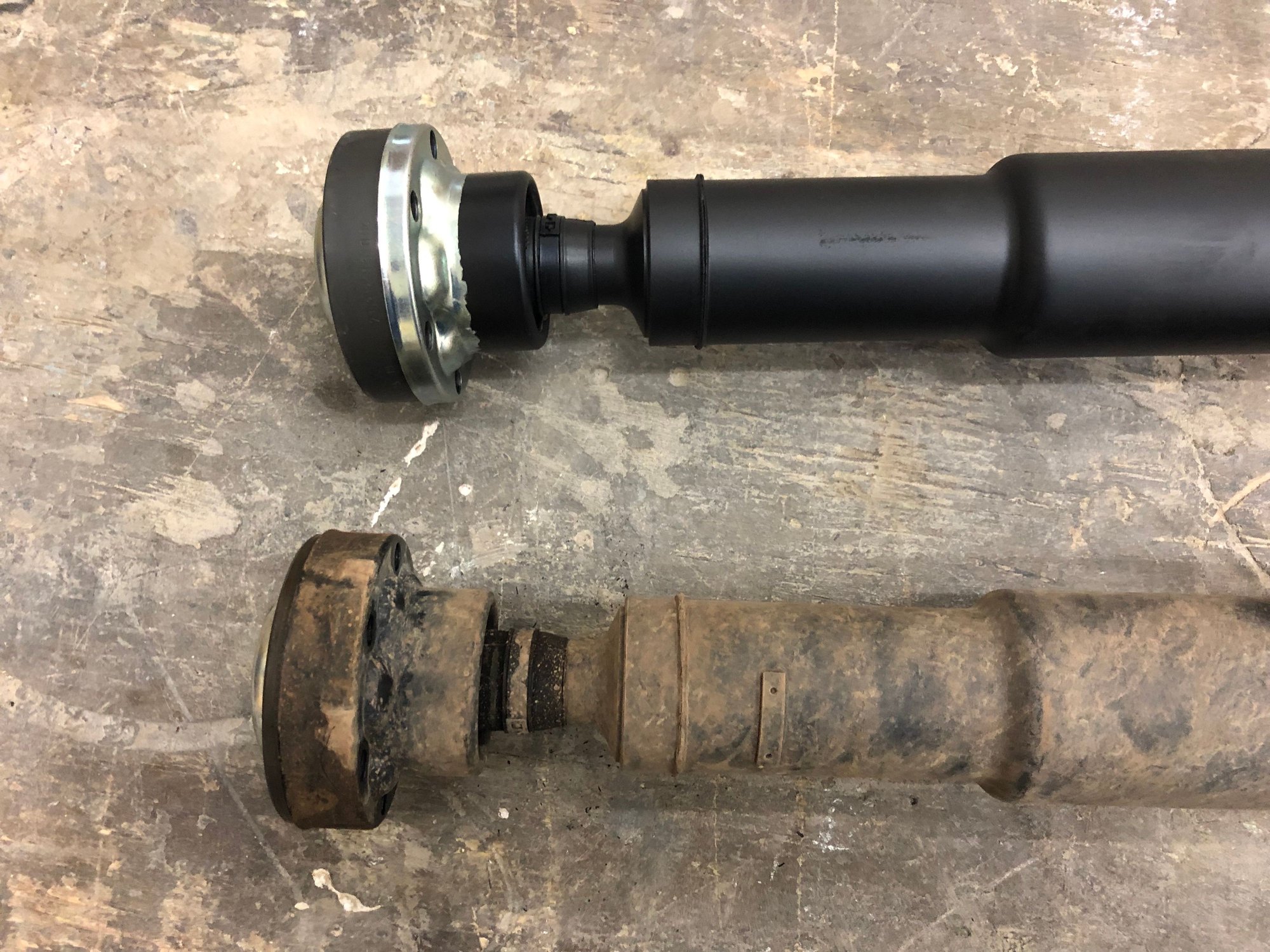

Short day at work so I had time to get the shaft installed. Difficulty level, 2. Its really not difficult and pretty self explanatory. There are enough write-ups. The rear flangers was the only "issue". The four T14 bolts have thread lock on them so you need a bit of force to get them started then they come out easily. I was able to do so with a regular length ratchet driver. Then I used a chisel and hammer on the back side of the shaft flange lobs. They stick past the rear diff interface so its the perfect spot to tap them forward. Once there was a sufficient gap I just drove the chisel between and it came apart. Took only a couple minutes. I slacked nothing with penetrating oil before hand. When installing insert the rear flange and attach at least one center bearing bolt. Then get all those bits in. The shaft will comprise to get the front flange in place and bolted. Total time was about 1.5 hours. Next time, half that.
Comparing the original shaft to the new. Only one change I see with the forward CV cover. It's shorter.
