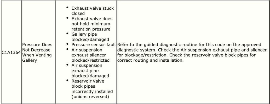

Ok so I finally got back around to the Land Rover. I found the original sensors on the front seat (OEM) so I took them and chucked them into an ultrasonic cleaner for like 10 minutes. I finally took a look under and ripped out the aftermarket garbage sensors. Replaced the original ones back on and calibrated the car. SUCCESS. But then I turned the vehicle off and turned it back on. The compressor kicked on and the vehicle kept raising to extended mode. I’d try to select a different height but it would tell me to “lower vehicle once clear of obstacle” If I tried to choose a different height again it would throw a fault code. “C1A13-64” something about a gallery venting. If I clear the code I can sometimes get the suspension to stay in normal mode but as soon as I choose a different height it gets all wonky and throws a fault. So I sorta got it sorta don’t. Any help pls.

happy to hear you got your first problem sorted successfully 👍
Here are the most likely causes for the code you mentioned
