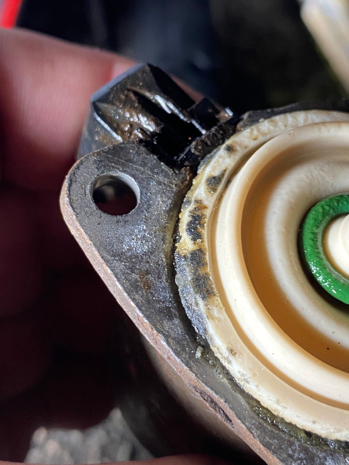

Another update. The weird nouns came back for a while, at least a few weeks now. This time I started to get codes, P181D-00 (2F) Clutch actuator changeover solenoid - range/performance . I even had an incident where I could not get out of low. This was after a little test I did in my driveway after having the transfer case bind up a couple times after starting. Basically it was stuck in low, but not really low? It was weird but made turning very difficult. And after clearing the code it would eventually come back. Since we had some decent weather, I decided to swap in a used one from my spare transfer case that eventually needs to be installed. I will order a new solenoid, they are only about $150 but I am glad I did not get a new one for this....
It would appear that the solenoid was indeed the issue, but it was my fault. I have not heard the clunk yet but I have not really had it out on the road. But I can say the changes from low to high sound better and even seem faster. The actuation is a little more "crisp" if that make sense. What caused my issue was the leak stop, BlueDevil, that I used. There is a small green o-ring on the boot of the solenoid. This does not insert into anything, it just acts as a small mechanical force on the center of the boot/diaphragm which is a seal between the solenoid itself and the transfer case fluid inside. There is no pressure in the case even though there is a pump, so any fluid that would have gotten in was from just being exposed. I am certain the fluid worked a little down into the shaft and got into the solenoid itself. So I think that somehow cause the issues.
Removing one is easy, you can do it by pulling a little and tilting the stamped end towards the front and the inner part towards the rear to get it off the print inside. Fluid will come out! I forgot that part, was not ready and made a mess.
https://landroverforums.com/forum/lr...g-86760/page2/
Install was a bit of a pain. I highly recommend getting a pigtail and wiring up a 12v supply. I have not looked up if this thing really works on 12v, it may be less - so you have been warned. But I had to make a tiny harness and hook up my battery to get the solenoid to energize and install. There is no other way, with it retracted it will not reach the fork inside. Even with it energized it was a bit fiddly to get it to set just right. Having the Rover on a lift would have helped a lot. When energized the solenoid got pretty hot which is why I am not 100% sure its a full 12v it uses. If you have a harness setup and tools ready to go this could easily be a 15 minute job.
The first pic is the used replacement, not the green o-ring. The next two show the one I pulled. Note the corrosion issues too. I had to clean up the surface of the transfer case with a brass brush on a Dremel.
