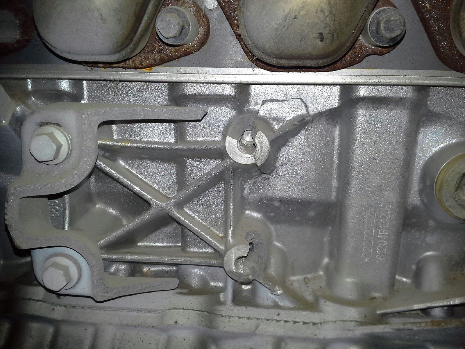

HAHA...AHH. This is getting interesting. So I am working on tracing the VIN down on this vehicle to decide if its worth spending the money on this broken motor. I've decided that if I can confirm it was damaged at a low amount of miles, its worth it to spend the money on the motor(being pretty cheap, probably around $900, since he hesitated at $1200). Carfax isnt showing history on the vehicle so I googled the VIN, and it came back with a GSA(goverment auction) listing.....Crash Tested Vehicle.
http://gsaauctions.gov/gsaauctions/a...51FBPI07017030
Was sold at auction in September 2007. After looking for crash test results, I found a Youtube listing for probably this very vehicle that was tested in 2005. 25MPH test.
Maybe it is, maybe it isnt, but regardless this motor is likely very low miles with nothing more than a very small hole due to a bracket breaking. I think I will bite on this bait.
