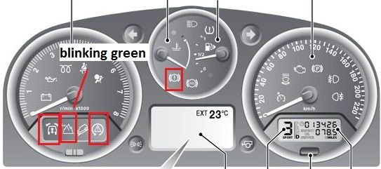

Hello, greetings from Eastern Europe!
Long story short - my wife and I went to the woods today. Everything seemed to be perfect until we wanted to go back home. When i stepped in my disco3 and started the ignition, and multiple fault indicators showed up on the dashboard. :
the air suspension doesn't work. When i try to make the car higher, using the switch near gear switch, nothing happens. Also, the hi/low switch doesn't work. There is a green indicator blinking in a dashboard, which means, that the car should be in ''low'' regime, but actually, the car is in ''hi'',
Any ideas how to solve this?
Cheers!
