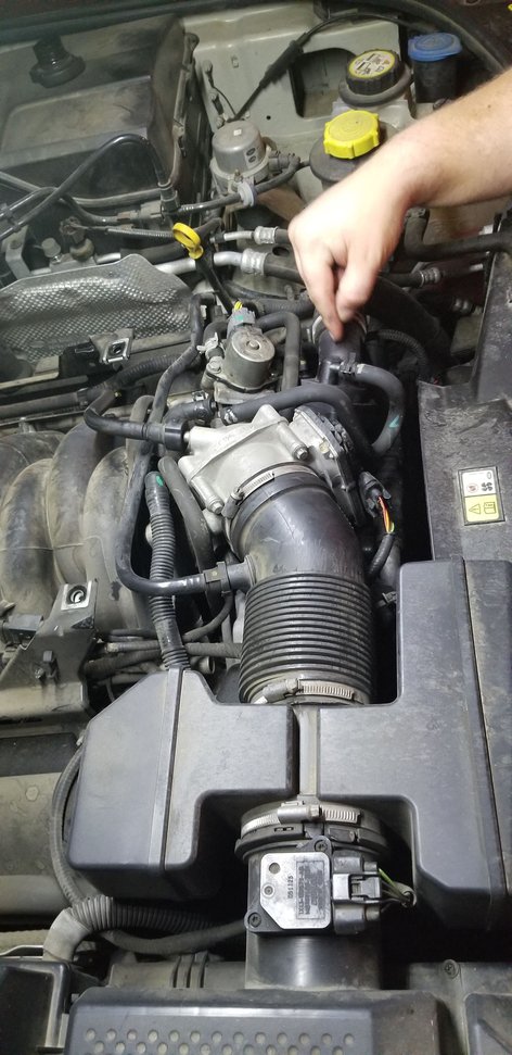

I want to apologize in advance for my lack of engine knowledge. I'm trying to prevent another thousands of dollars visit to the dealership. I have a 2006 LR3

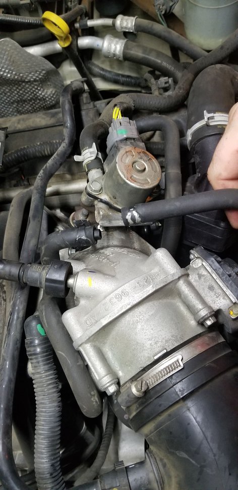

The other night I was driving and stopped when I noticed smoke coming from the engine. I immediately turned the car off and looked under the hood. There was coolant sprayed every where. I finally found the source which ended up being a busted hose. I'm not sure if the clamp broke or there was immense pressure that made it burst. I'm hoping I can just buy the clamp to reattach the hose so that I can drive it to a local mechanic. I'm not sure if this is a coolant hose, over flow? Its off the upper radiator house and before the throttle body...I think. Again I'm just a girl who isn't well versed with engines but I'm not afraid to try and fix it.
I will attach pictures of the hose. I don't know where to search, so I'm hoping someone knowledgeable can guide me in the right direction.
Thank you so much for your time

Based on what I have read before, I am shocked you still had the original fitting (maybe replace once already?). Anyway, just pick up a ****** connector with two clamps and get it back together. Its a common failure point and often the fitting is replaced as preventative maintenance. I think the size is 10mm inside diameter.
Old Aug 11, 2018 | 03:47 PM

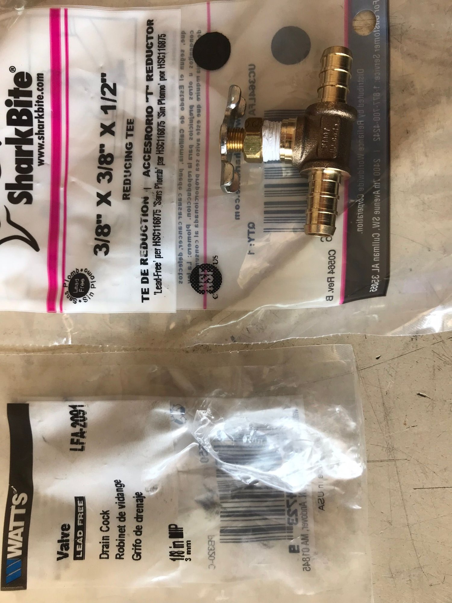

THat's the bleeder valve its a crappy 10 dollar part that gets brittle than snaps to pieces. You will want to dig the chunks out of the hose and either replace it with a new plastic one or spend a few extra bucks down at Home Depot or Lowe's and you can make one out of brass parts that should last forever.
https://www.ebay.com/itm/Land-Rover-...sid=m570.l1313
Old Aug 11, 2018 | 03:48 PM
Link to the brass do it your self version
https://landroverforums.com/forum/lr...low-out-85645/

After reading this, I remembered that I needed to do this. Spent $9.00 at Osh to make this:
when I went to put it on, I realized the v6 doesn’t need one. The bleeder is built into the expansion tank.
