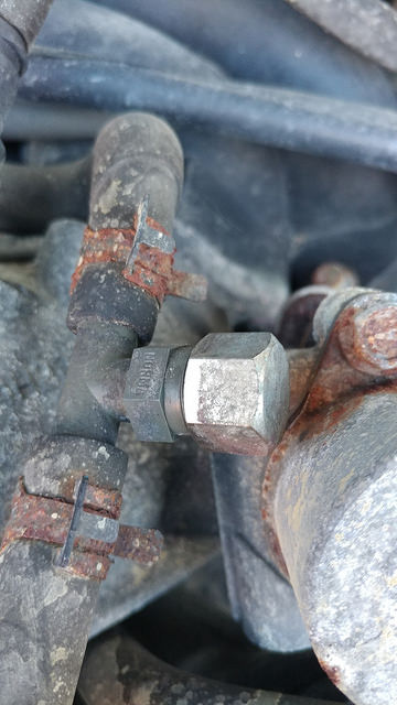

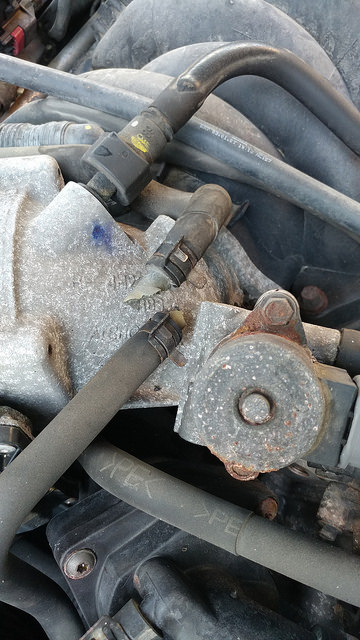

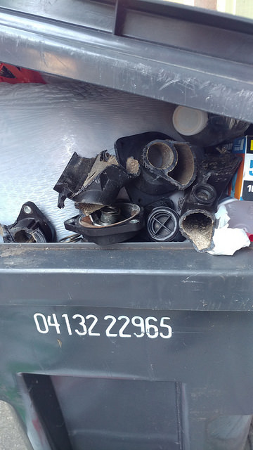

Once home I got under the hood and found the culprit. A cheap plastic T connection with the bleeder.

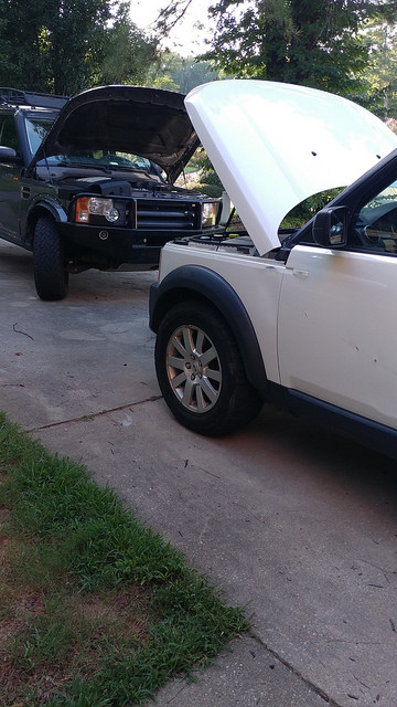

Wasn't sure if there was supposed to be a third hose or if was the bleeder for sure. So I pulled the engine cover and checked the other LR3, twins are handy sometimes.

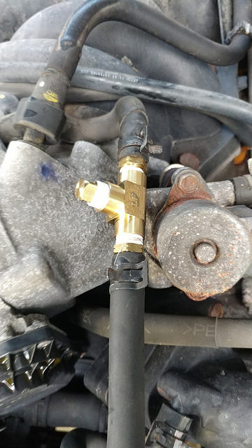

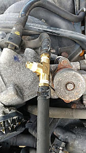

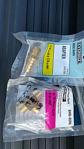

So not interested in plastic for a replacement a little trip to Home Depot found me with brass parts to make a new 2 with bleeder.
Thought I was good to go, but found that thermostat housing had sprung a leak as well. So hopefully I can get one over-nighted so I can get the truck back on the road.

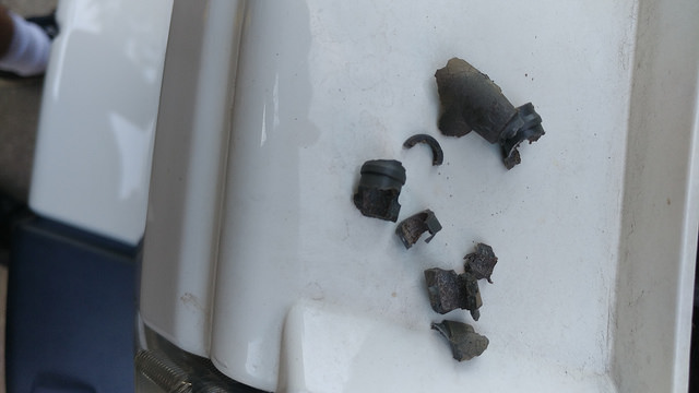

Decided to be smart and make up a second brass T for the other LR3 to be ahead of the power curve. This one was not leaking but was in 6 pieces inside the hoses...
Guys be proactive spend the $15 on the brass parts at Home Depot, Lowe's Napa or anywhere you can get the brass fittings and save yourself some serious grief.
