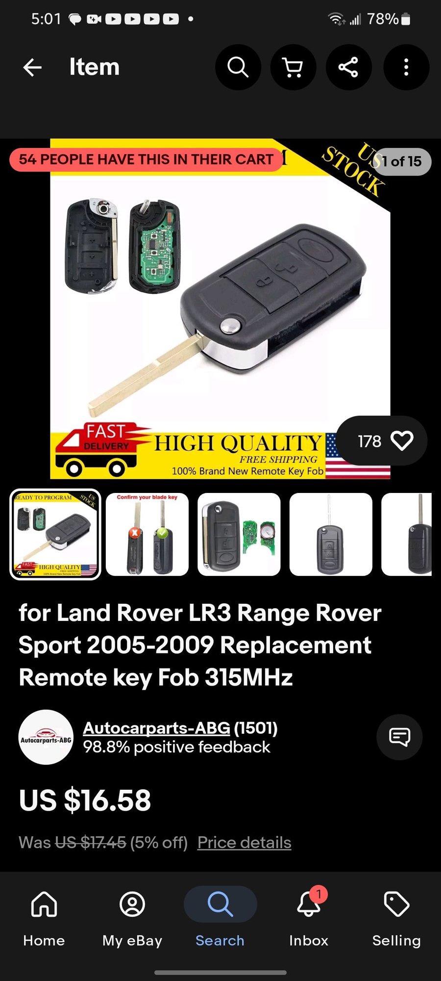

I bought one of these on eBay, added the battery and programed with GAP.
