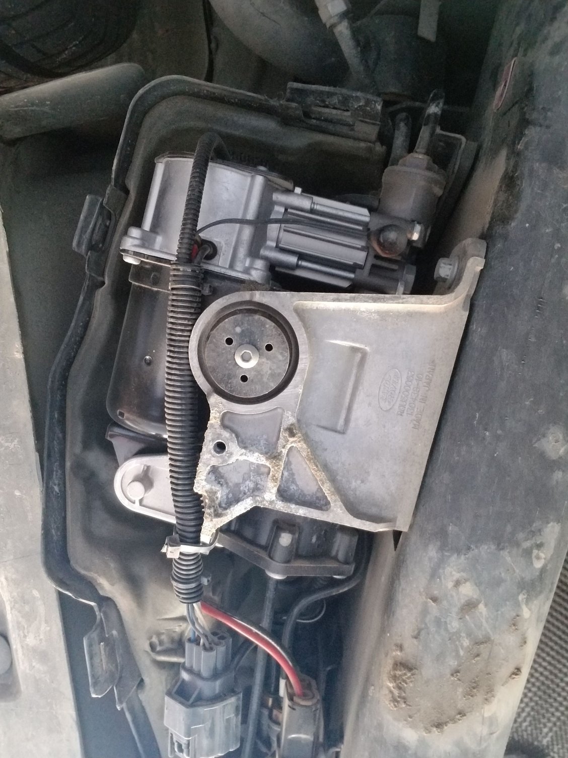

Okay,
I got the compressor cover off and snapped this photo. Hopefully one of you are able to tell me which style of suspension compressor I have. Thanks in advance...
Keith

I removed the cover this morning and took a picture. Can you tell from this photo which suspension compressor I have?

I have been trying since this morning to post a photo of the compressor on my LR3 and the post has not been showing up. I think the attachment size may have been to large. I am going to try this again with a smaller attachment. I could use some assistance in determining if this is a Hitachi style compressor, or the newer AMK style. thanks....

Hitachi
