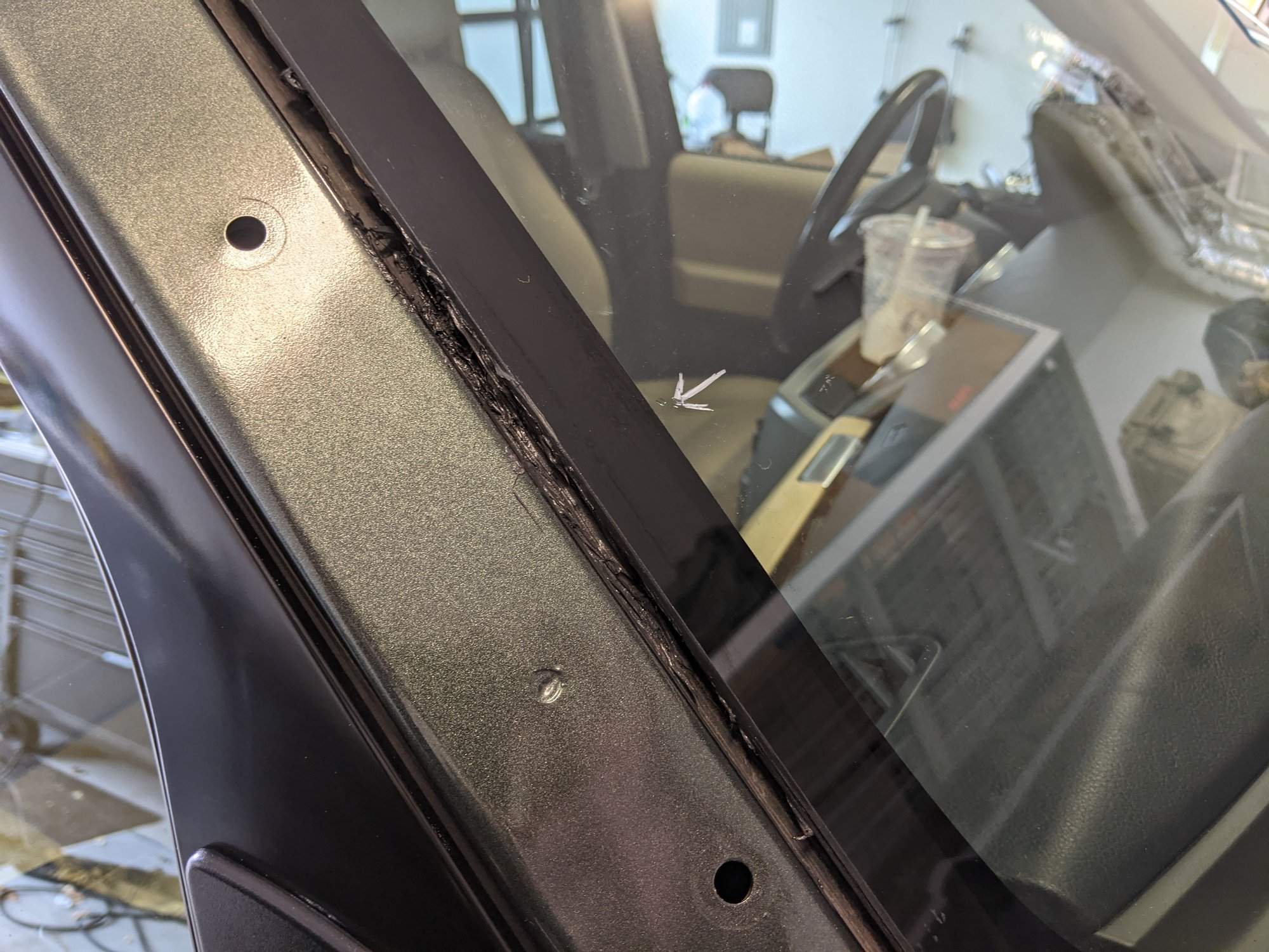

Found a new leak today. Looks like the windshield isn't sealed properly in a small spot. Water intruding into the a pillar. I pulled the interior trim and found where it's coming in. Blew air from the outside after removing the exterior trim and confirmed it's seeping in. I used some black silicon for now to seal it up, but will likely have a new windshield install done at some point.

Is that the original windshield? I dont see heating elements, but there are a few out there that never had em.

I don't think it's original but it definitely has heating elements running through it.

Well I fixed the leak that I found. I drove it about 3 hours today in the rain and water is still getting in somewhere up in the headliner/passenger a-pillar. I verified the windshield leak I found is fixed, but can't find the new/second leak. I think I'll have to drop the headliner a bit in the front to see if it's still coming from the windshield, or from somewhere else. I poured water over the tip of the a-pillar trim and it was channeling it properly nad not making it in. This water is getting in and wetting the airbag in the pillar, so I think it's coming either from the top right of the windshield, or somewhere else up there.
