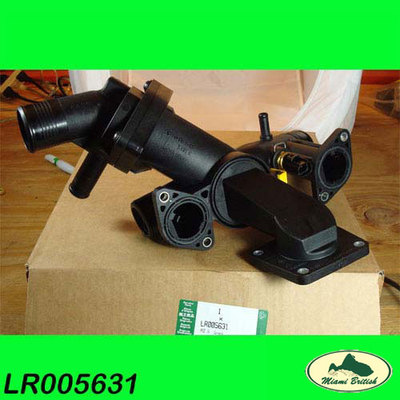

Default yes the fan must be removed
This is a real good link re the belts.
How To: Change your engine belts
This is how to change the thermostat but the better idea I think is to replace the whole plastic housing LR part number LR005661 - you get a "free" thermostat properly installed plus all new plastic. If you are doing the belts and are thinking of replacing the thermostat, now is the time.
How To: Replace your Thermostat
Attached Thumbnails Newby Posting RE: Serpentine belts for 2006 LR3 HSE-thermostat-housing-complete-lr005631.jpg

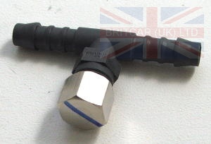

I actually changed the thermostat housing a few months ago, unnecessarliy I might add. i had a slight coolant leak around the thermostat housing, I cleaned it several times trying to find the source. I finally just bought the new top section, o-ring and thermostat as I recall. In fact, the issue was a loose clamp. However, when I was working on it the t-fitting broke as I was bleeding the system.......if you are reading this, get a spare and put it in your glove box, it will break and if you have one on hand, it will save you a trip to the dealer or to the hardware store for a make shift replacement until the dealer part arrives......Phil

Default have LR027661 bleeder tee in my parts stock
Yes, you are correct - that plastic bleeder tee gets brittle from the heat.
As such, I installed a new one and keep the removed on in my spare parts stock.
By the way, keep your old belts; also count the number of grooves in your new belts before you install them - you can get a wrong groove belt with the "right" part number.
The same story when you replace the alternator - count the number of grooves in the new pulley - it can be the correct diameter but the wrong number of grooves.
Bye the way, I am not smart; I just learned all this stuff the hard way.
