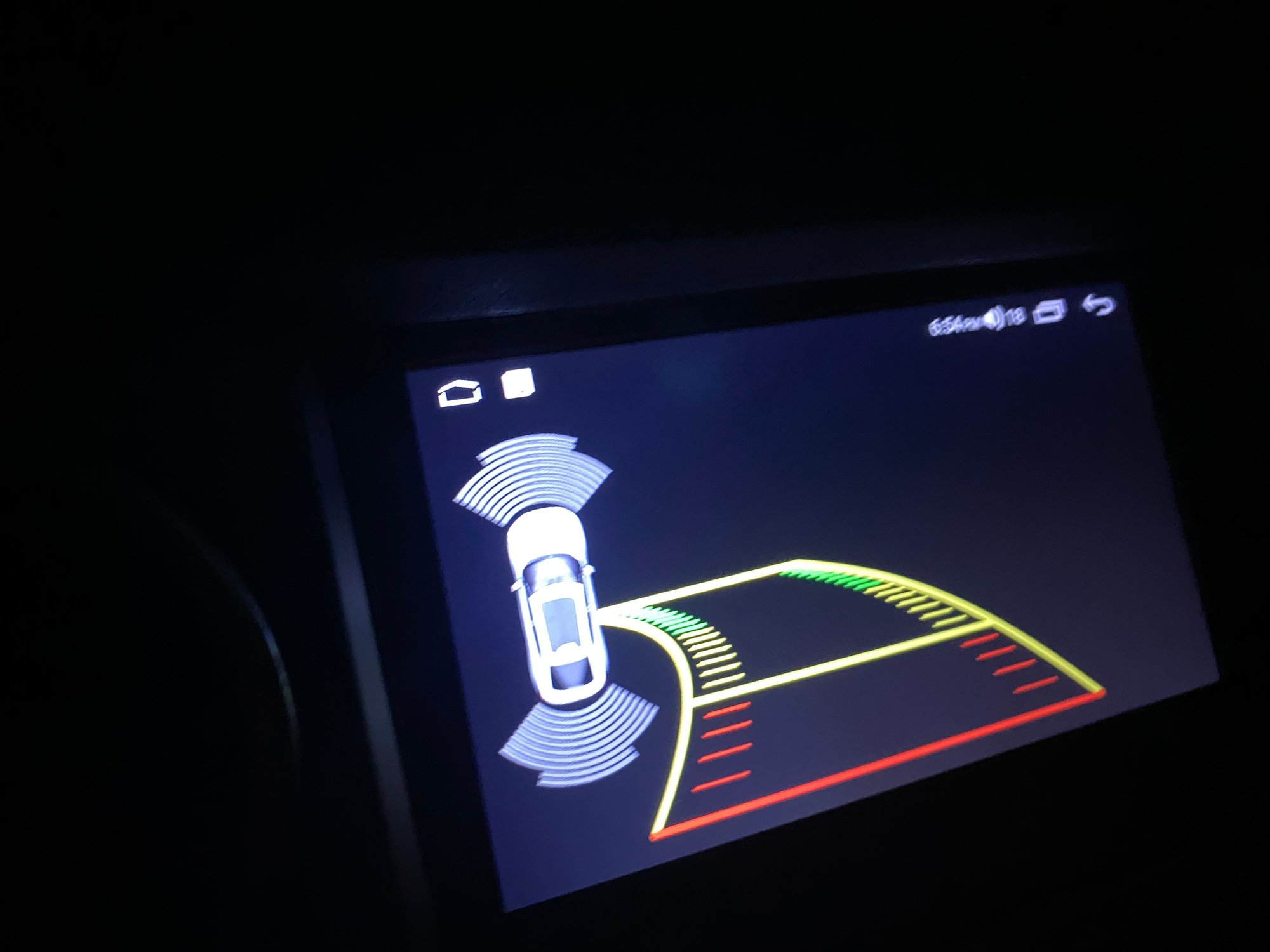

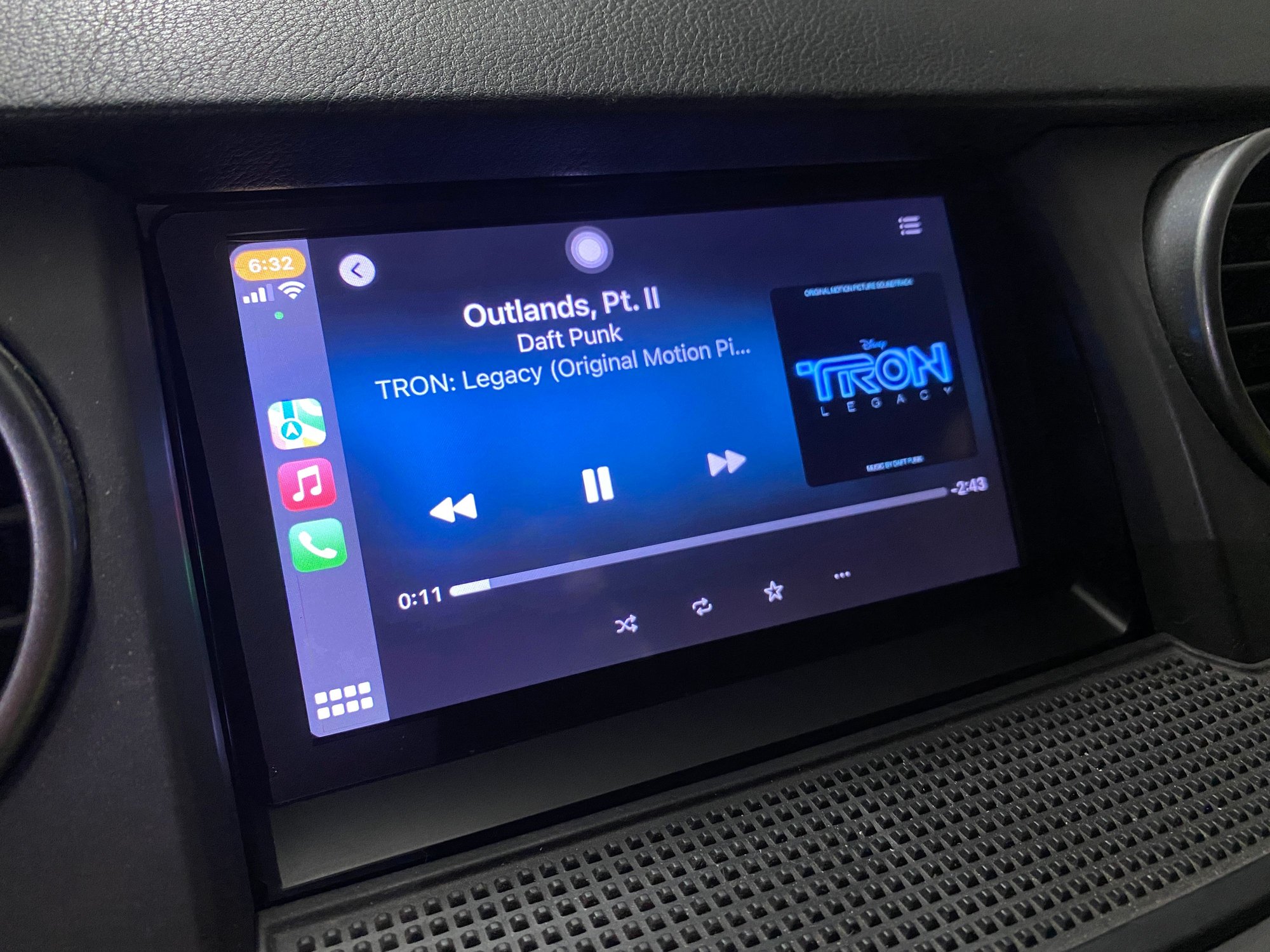

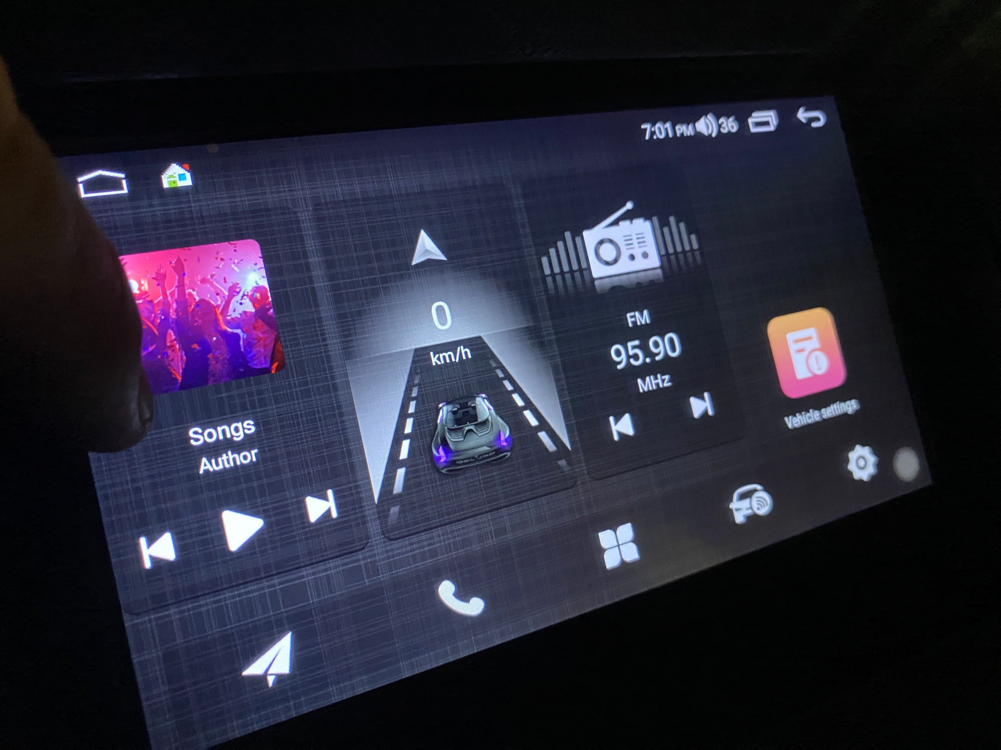

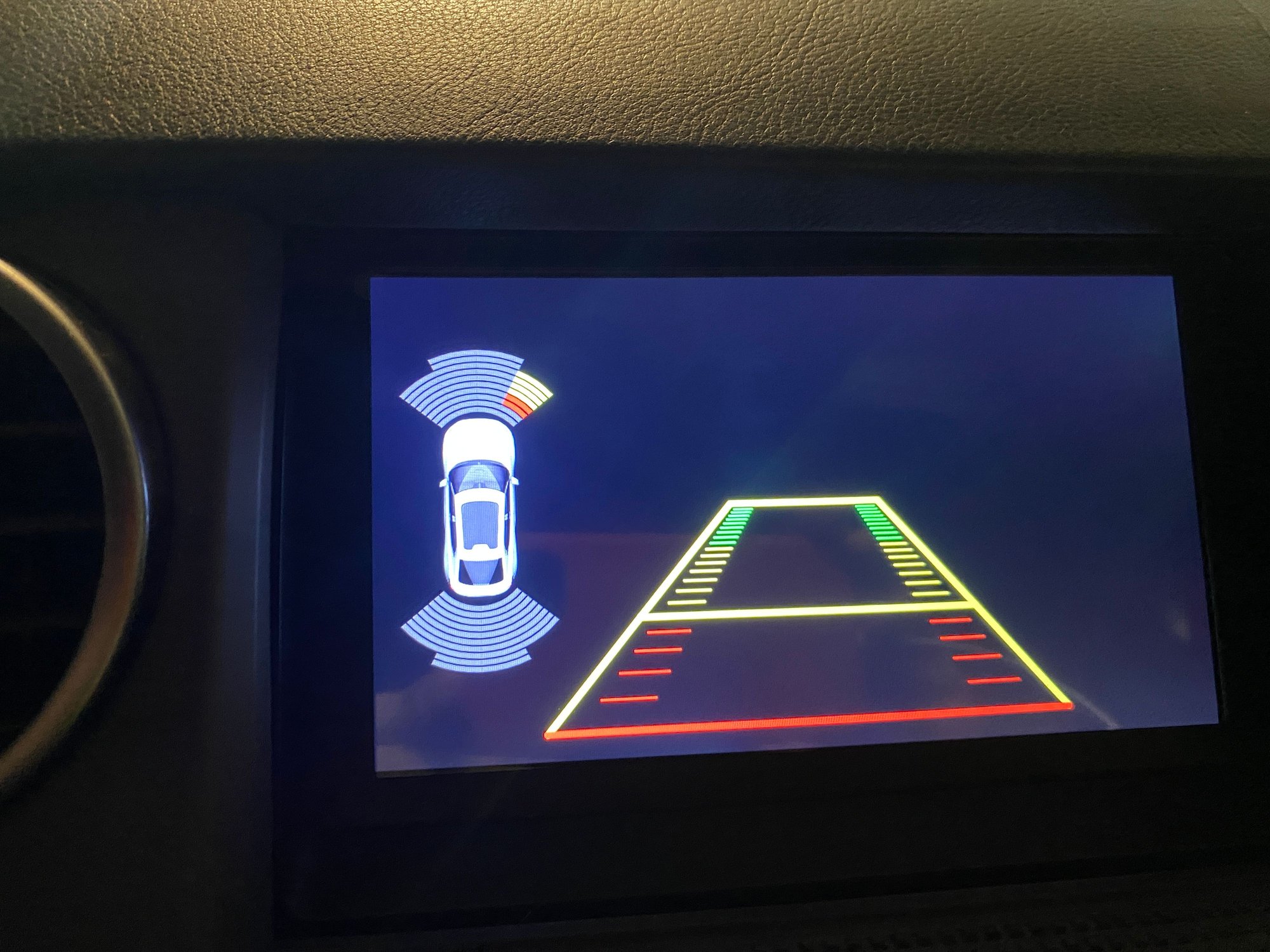

Okay, the solution I went with is mostly installed. I have some more things to do because I had an LR4 nav screen modified into my LR3. I also have a GMRS radio tied into my audio. But overall things work well. So what I did was swap out the navigation display unit for an aftermarket display module that has Apple CarPlay or Android whatever play. It is pretty dang neat and with a sale price of $200, its not bad. You still need/retain your factory head unit. Sadly it does NOT interface to the MOST network like I excepted, so there is no direct link to the amp. Instead you have to use your AUX input. In my case, that was pretty hacked by my previous installs. But this unit will output into aux right in the dash itself, no long wires to the input. Easy to do tho. I am still learning all the features and such. I wont go into much detail but the CarPlay works. Also some surprises, such as the parking sensors coming up with the backup camera (camera offline right now) which show exactly which sensor is being triggered! And the camera grid curves with steering, so the steering angle sensor is actively being read - something that of course does not happen if you install an aftermarket camera. But the biggest reason I went with this is because the 4x4 display still works, or I should say it has its own version. Unlike the OEM versions in the D3/4, the front wheels actually change direction as you move them. But my rear locker is not showing, not sure what is up with that... I would much like that. There are some other quicks too that I dont care for, but I may just have to learn to edit and modify things more. For example it is suppose to have wireless CarPlay but I can not get it to work. Not a huge deal since I usually have my phone plugged into to charge when driving anyway. I will post another thread about this in much more detail later on.
