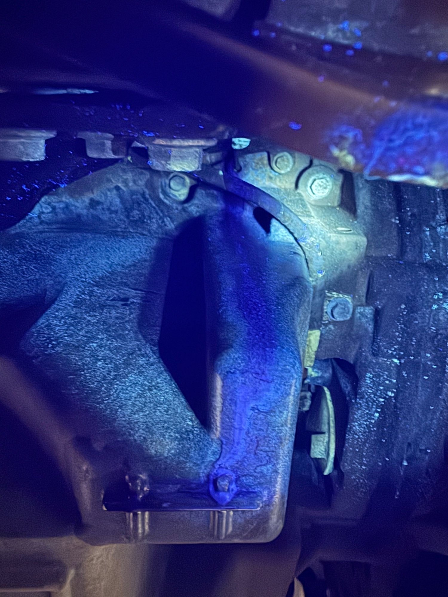

I removed it, cleaned everything up as much as I could. Then I added some UV leakiest dye to the engine oil. From what I can see, oil is weeping down the left rear of the sump. I see no evidence of a leak from the top or front. From the oil cooler either. I have no idea where this could be coming from.
This is hard to make out but oil is pooling on the bottom of the sump and you can see a trace line where the oil has leaked down the sump.

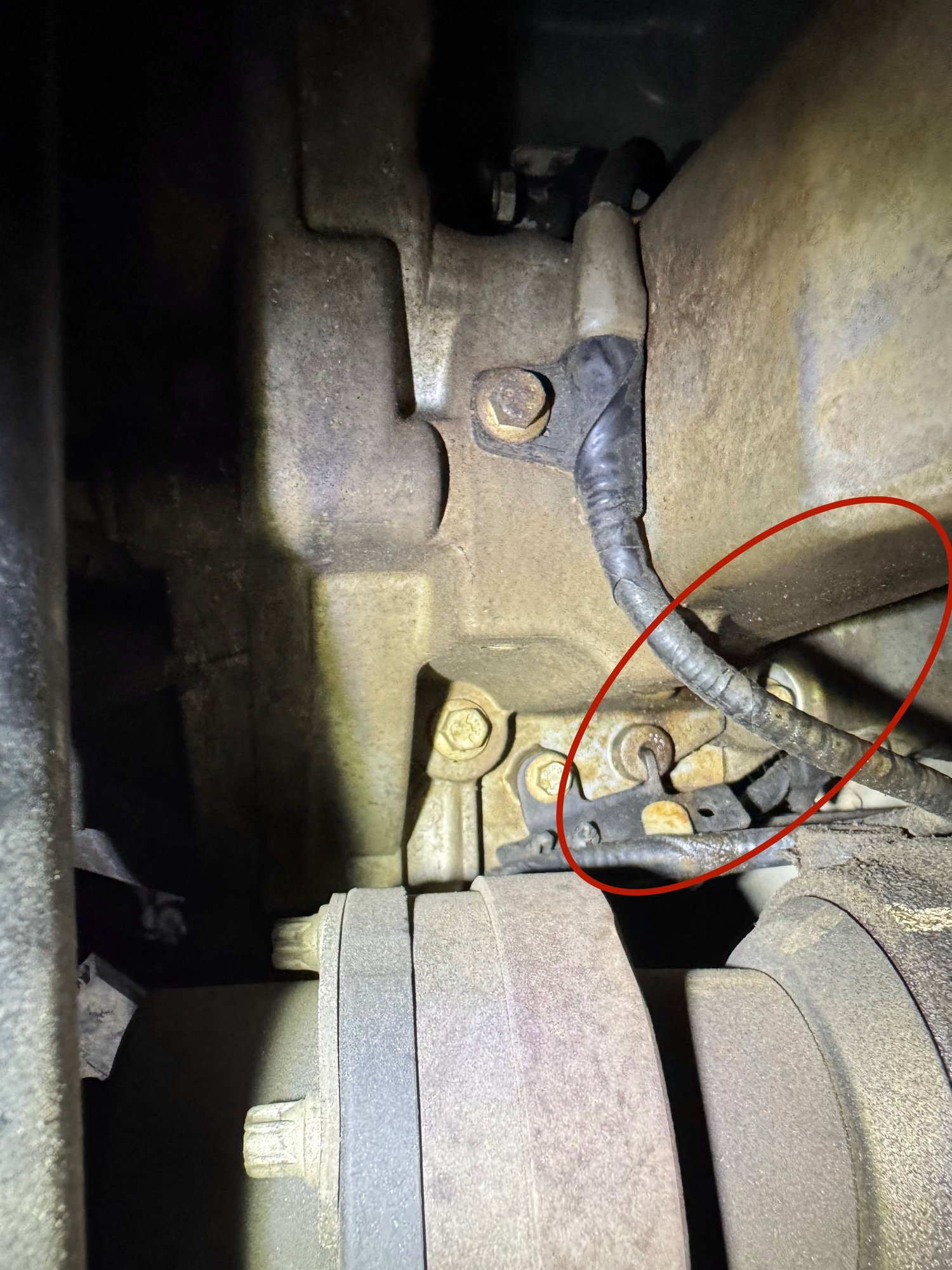

here I marked where I see the oil. No idea what this bracket is and what's above here?
