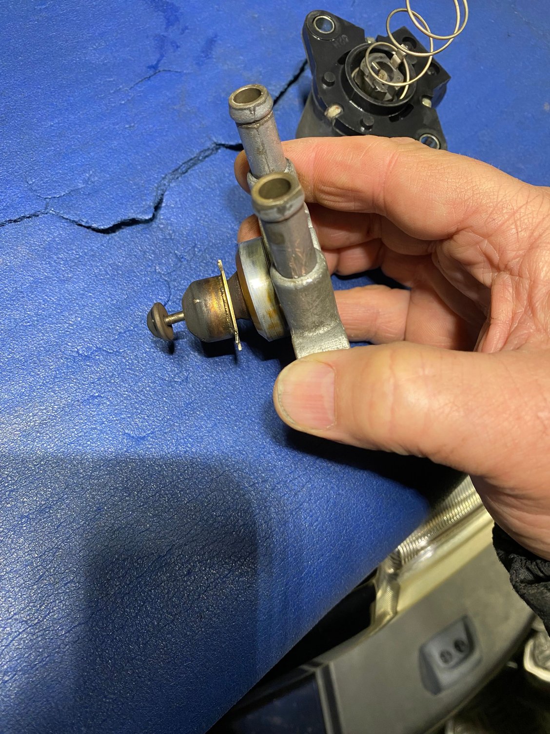

There is no seal on the plunger stem at all. It just moves up and through the aluminum coolant housing.
There is no gasket sealing the stepper motor assembly to the coolant housing.

That’s good info about the EGR.
So far lean codes are not back and the fuel trims are perfect.
