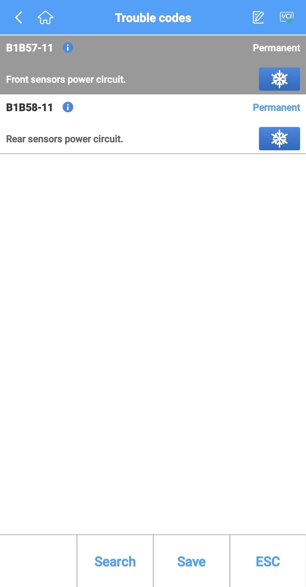

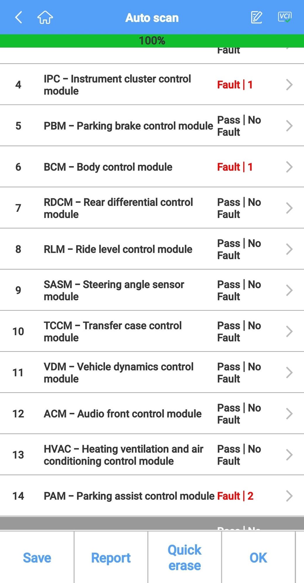

Ok guys, he bought a reader. Here’s the results, But I see nothing in those results that would shut off the air compressor for the ride system after 15 to 20 seconds
any further thoughts?

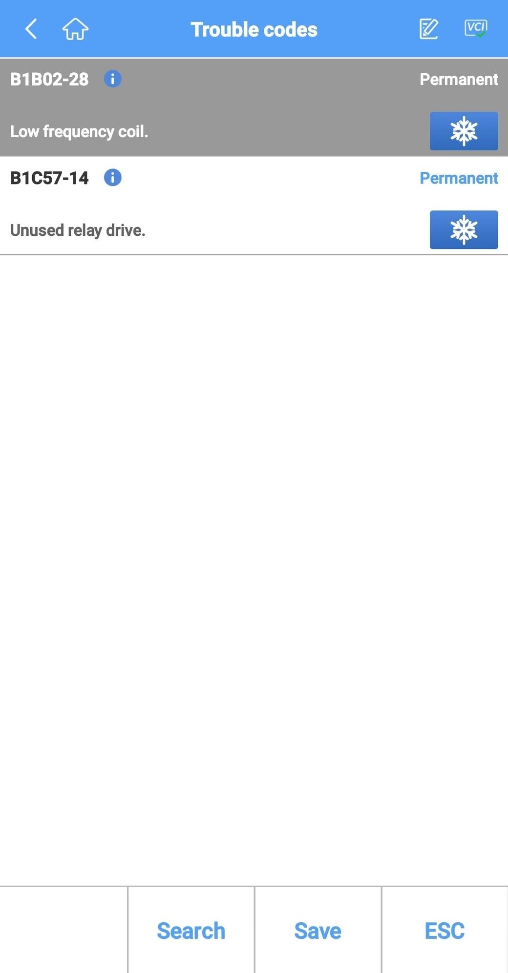

Apparently he wasn’t done sending me screenshots. There are two more coats and 1 have to do with power to the rear sensors.

Is that from a $30 generic code reader from Autozone? Not to be a dick, but that isn't going to be helpful at all. You need the actual codes and fault descriptions.

The AP200 will read the codes just fine. But again, you may have to read the air suspension codes when you have an actual fault. You haven't shown any suspension fault codes so far. And codes are just one part of a diagnostic.
Review LRTime's recent video on YouTube where they go over diagnosing a suspension leak. Also, just because something was replaced recently, don't assume it's still good. You need to follow a logical diagnostic process - throwing parts at this system will likely lead to frustration, not necessarily a fix.
