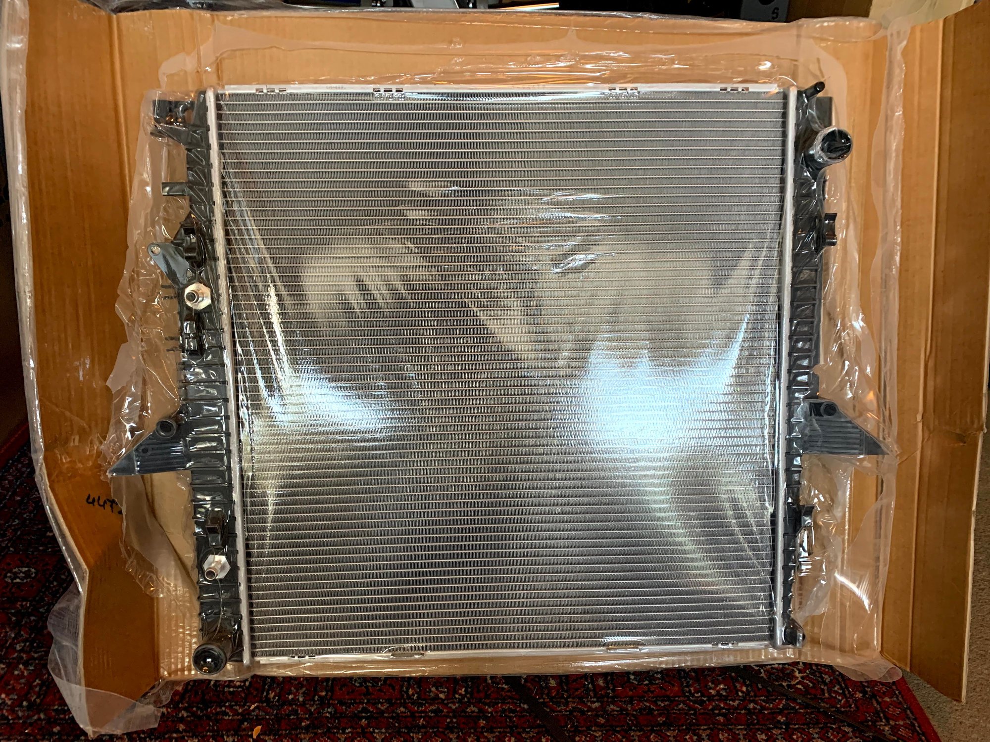

I just replaced mine recently, sounds like you might be talking about my issue. As keninnc said, I had problems with the one from lucky 8 accepting the air guides. I had tried the higher priced one of the two that they show but ended up returning it. They were very good about that, I always liked Lucky8 anyway. I ended up spending more for one from autohausAZ, pic is what I received from them. I have a few pictures on the other thread that show the clip part. The one I got ended up coming with metal clips as replacements on the bottom.
My mechanic also said not to worry about the little bit of transmission fluid that is lost when you change it, but I still like keninnc's suggestion to top it off straight into the radiator once it's in. The transmission line ports are on the left side in the picture.
