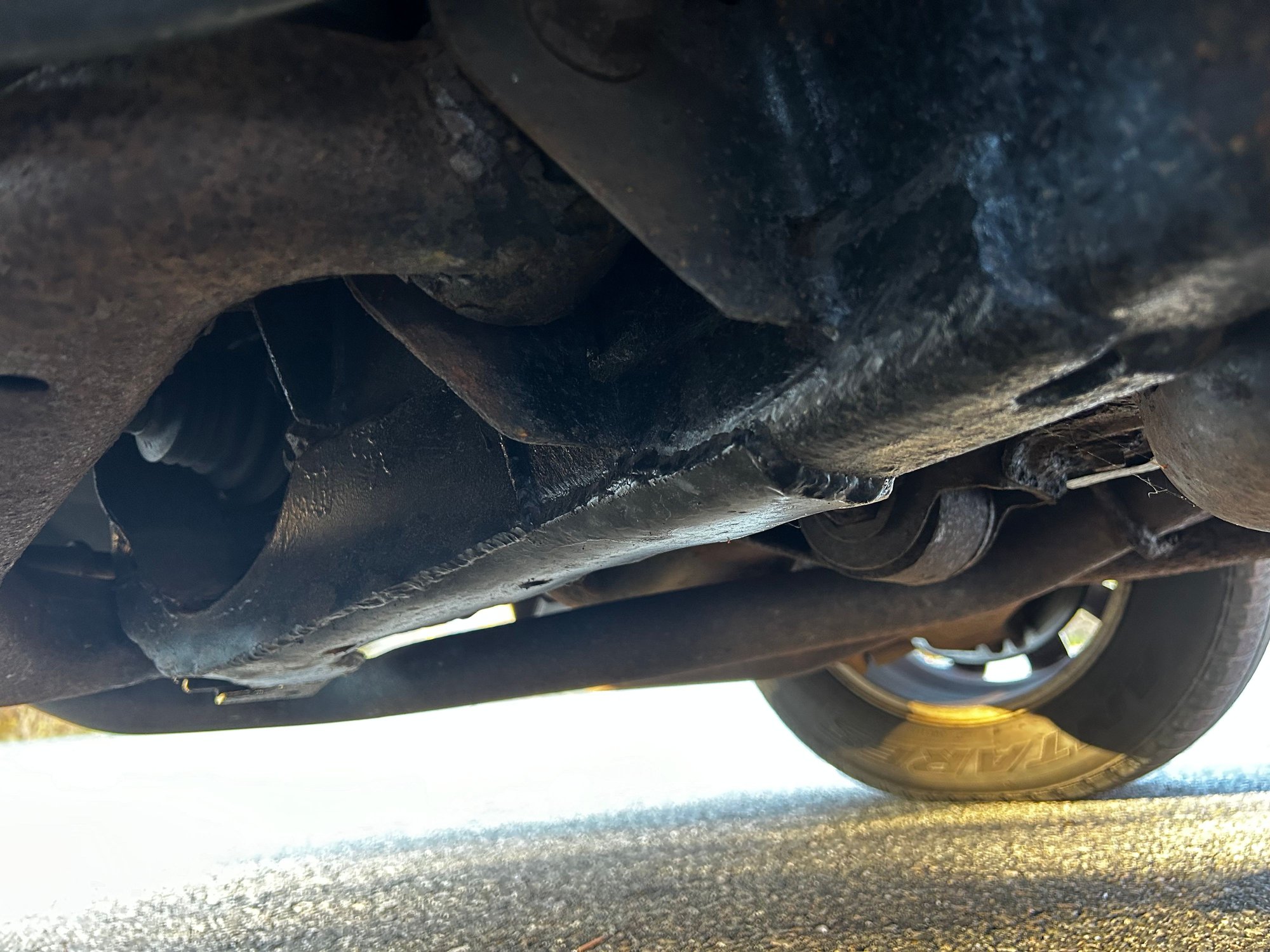

Yeah that's terrible....
Not to be a dick, but this is my frame.
Old Oct 10, 2023 | 08:33 PM
  #22
DakotaTravler's Avatar
Joined: Nov 2017
Posts: 5,106
Likes: 986
From: Green Bay, WI
That is 100% untouched original? Wish mine was that nice, but mine it at least still showing most of its paint. With that said, I would love to do a body-off restoration of the frame. And def repair the factory defect areas that collect water and debris.

It's original, from 2005....the only thing I do is sand/paint any surface rust from off-roading, like if I scrape paint off on a rock and rust forms (mostly sliders and gas tank skid, hardly any of that on the frame) and then spray it with BOESHIELD. I do that once a year.

I don't think ive seen a chassis that rusty even on a UK forum, i guess the other side would be just as bad so may need a chassis chop from a wreck to repair it or just do a body swap as DT has said.

Originally Posted by Ackrovers
I know, right? @houm_wa it’s a shame…no off road experience. Check out some more frame rust. I want to now take body off frame, weld in new frame section, rebuild the upper and lower control arms, wheel, hub, brakes etc,, remove all rust and turn it into a fun overlander rig.
I was able to go after the rust shown and put a beefy patch in. Also fixed the control arms.
Solid frame again.
Solid frame again.
