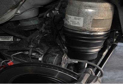

Repair complete. Not as straight forward as I expected. As Mike stated, required a bar and ultimately spousal assistance with the floor jack to get the lower shock bolt back in place. Used several jack stands and was very careful braking the bolt loose. As I removed the bolt, the rotor shot "up" instead of falling down as I expected. The replacement took a little more than an hour.
