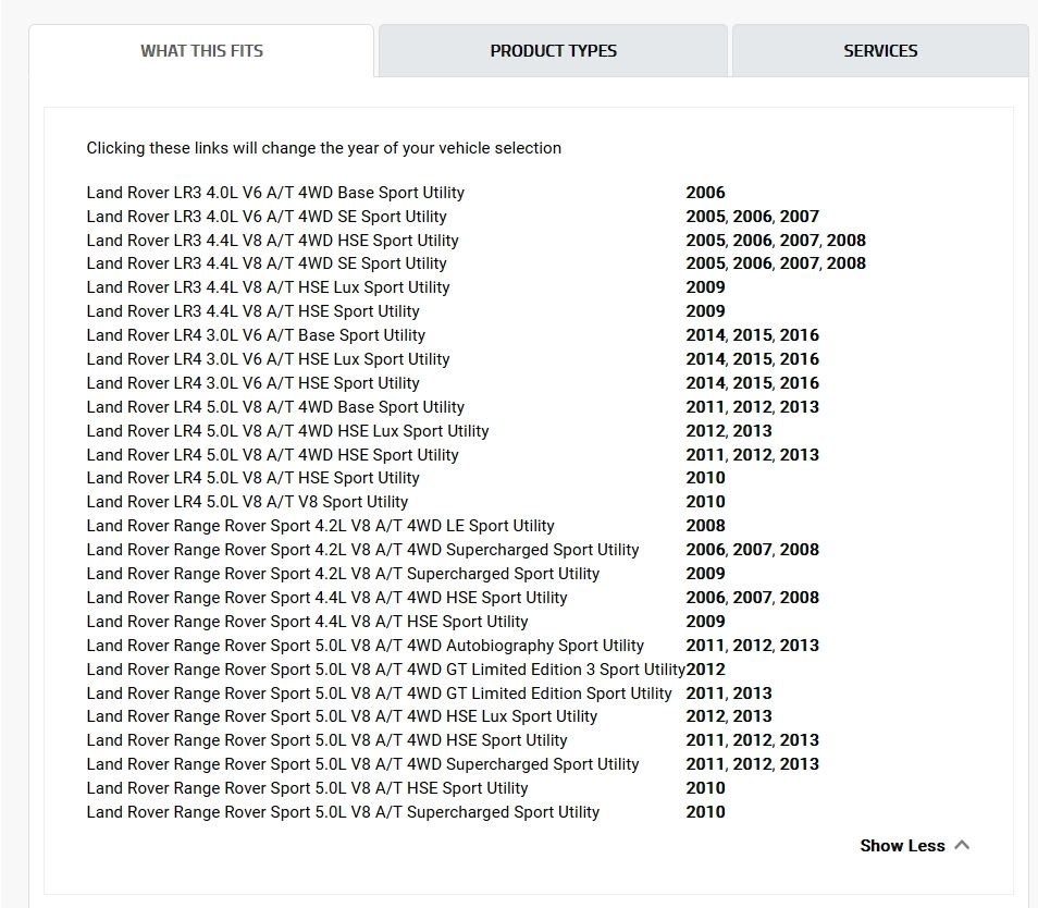

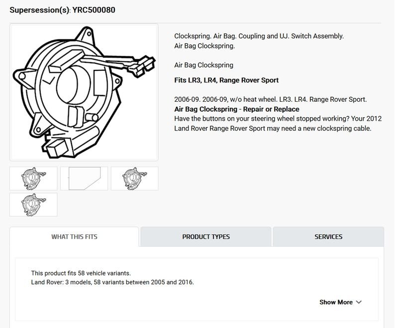

I pulled a clock spring from a 2012 RRS with a heated steering wheel today. The p/n is 9H22-14A664-AA and (obviously) has the 2 heating pins. Looking at the listings on eBay for this same p/n I'm going to assume there are only 2 clock springs for all Lr3, LR4 and RRS up to 2016. One with heat and one without. The chart below shows the years the non heat fits. I highly doubt they have multiple iterations of the heated one which may be why the aftermarket comes with heat... less expensive to manufacture one style vs. retooling for a second. Am I missing something?
