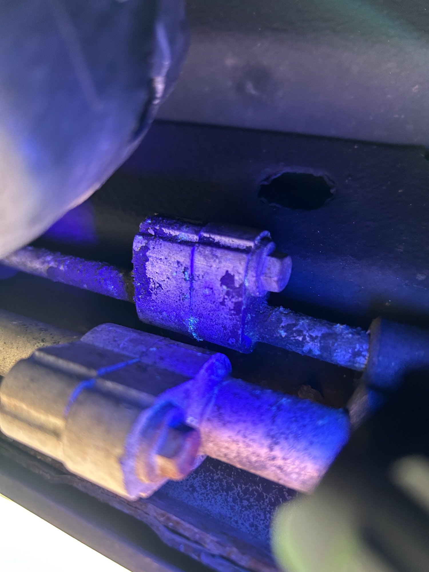

It depends where they leak is. The solenoid that isolate the rear AC looks like it is on the high pressure side. Its mounted to the aux climate control box that sits in back. If the leak is after that valve I think you would have a much less leakage during operation IF you dont use the rear AC. If its before, I think it will still reach full pressure and even is the solenoid is closed, it will leak out because of that difference. The last image shows the typical connections for the AC lines, inside are o-rings. These connections are located front to back and at the compressor, condenser in front of the engine, etc. My opinion again is if there is a leak would be to have the system evacuated and just replace them all. If you fix one, another may leak months later. I did this with my 91 Mercedes and the troublesome system was no longer that and worked great until sold.

Thanks Dakota - that makes sense. I picked it up today and they said from the " left front wheel well back AC system is corroded and leaking" They also saw leak dye in rear drain tube. As far as the O rings go - where the line gets corroded or rusted , it sounds like it's easy to damage the line trying to fuss around with it?. They said there's a place here in the Twin Cities that has a fix that essentially finds 2 places to attach AC hose and rig it along the existing one , bypassing the bad part of the line.( I think the rear evaporator might get replaced as well.)

Thanks for the info, I didn't think to check Rock Auto for this. It seems like my system is holding it's new charge ok, but I think I see some UV dye showing up at one of the rear AC joints. If the charge goes low again I will start with replacing all the union o-rings before I give up on the rear air conditioning.
