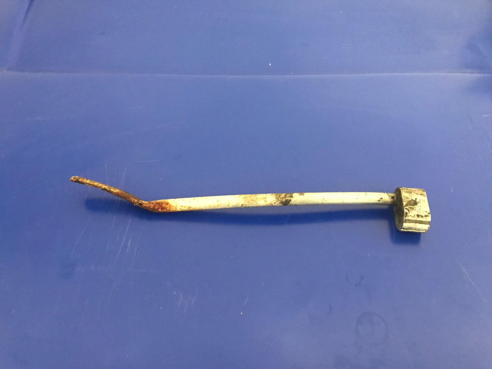

Well, I seem to have found my issue. I mean, I'm pretty sure this is THE issue.
The damaged part is line that goes from the middle of the driver side and goes under the compressor. The damaged are was right under the compressor. I undid the mid section and this just fell right out of the insulated tube. I can only imagine that at some point some work was done on the compressor and the line was smashed. There is a lot of build up around the break so I think several attempts were made to refill the AC but no one found the break.
So, now to find what parts I need to replace the mid line back to the connection to the coupler above the axle.
