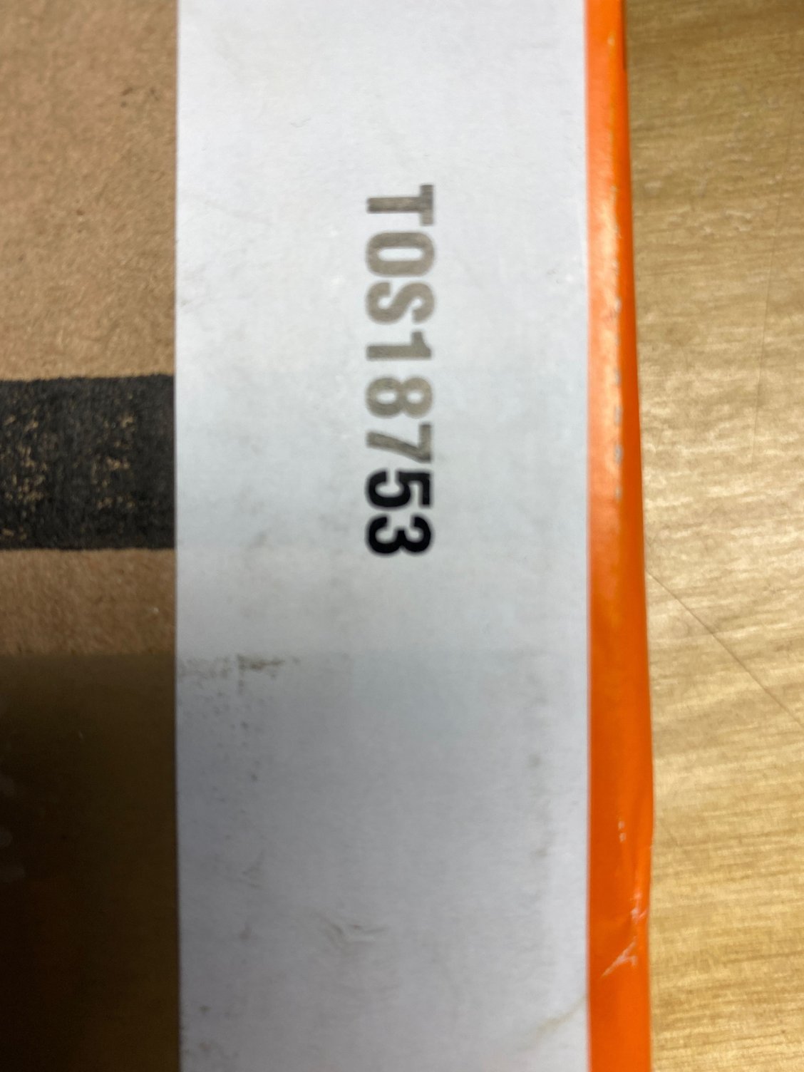

This is the gasket you want to use, Fel-pro brand:
Is this better than what comes in the AB kit? I just did the conversion and have a slow leak coming from the backside. No amount of tightening is helping it out.
yes, AB kit gaskets suck. I stopped using that style. Torque to spec, under torque, or over torque they always seem to leak.
this one is a metal gasket with rubber over mold. Impossible to over torque and supposedly reusable.

Did you torque to spec? Trans gaskets usually fail like oil pan gaskets, over tightening which deforms the metal pan, causes it to bow a little between bolts and leak. That can sometimes mean a new pan is needed.
I didn't torque to spec but definitely didn't over torque as I'm paranoid about stripping the aluminum. A couple bolts on the back where it was leaking seemed to keep backing out over time so I'd lightly tighten back up. I eventually added lock washers but leaking continued.
Thank you! I'll definitely replace it with this gasket.

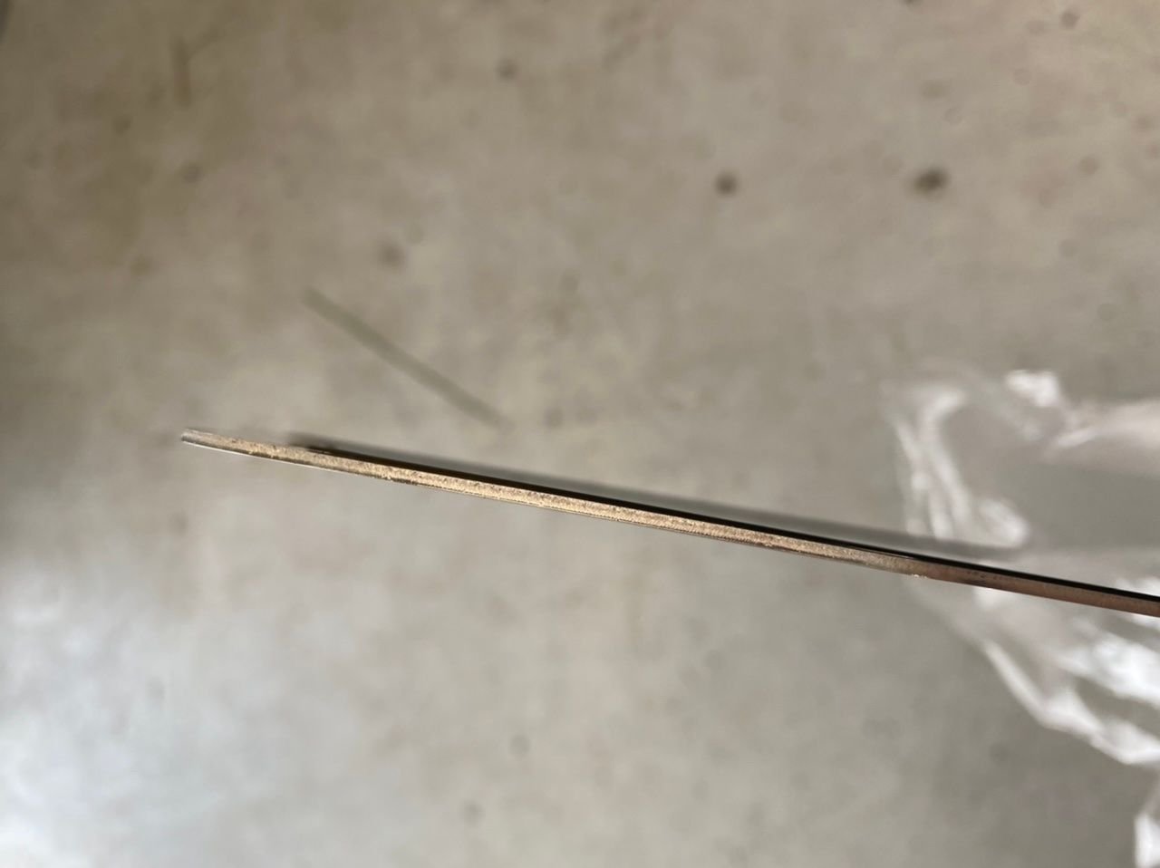

I suppose the shorter bolts that come with the the metal pan blot will suffice when using this gasket? The gasket provided in the kit was like a paper gasket ( much thinner) .. which I will discard and use the Felpro TOS-18753 instead.
Thanks again.

Photos:

Yes, supplied bolts work.
