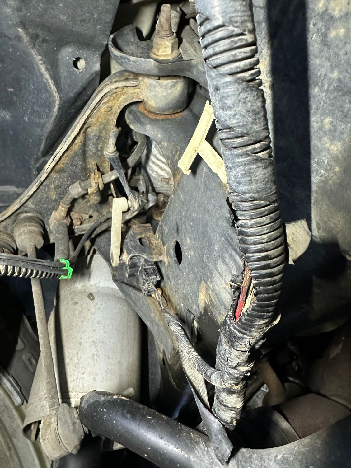

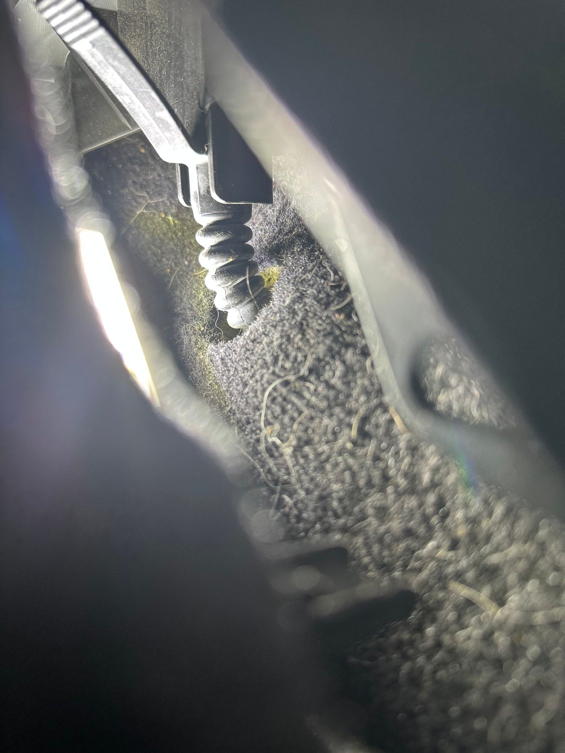

While trying to find the stupid drain from the AC which is supposed to be next to the left side of transmission, I stumbled upon this. Not sure if it is related to the "cluster" issue, but when I start working on the suspension, I think that is what we call in law enforcement as a clue.
was getting no compressor temp readings other than 9 degrees C with no changes on the thermistor .
Old Jul 27, 2025 | 09:40 PM
  #48
DakotaTravler's Avatar
Joined: Nov 2017
Posts: 5,009
Likes: 966
From: Green Bay, WI
Dam.... you are a glutton for punishment. I dont think any CAN BUS wires are there, but I could be wrong since I am not certainly which way the ABS bus wires are routed and Rover did some weird ****. As for prior post, I know steering angle can really mess with some things like ABS, suspension, etc. Lots of warning when it is defective or out of calibration.
Old Jul 27, 2025 | 10:16 PM
  #49
cybercop's Avatar
Joined: Dec 2008
Posts: 1,034
Likes: 38
From: North Georgia
Is this the Interior drain hose for the A/C next to the LHD gas pedal? If so, Mine is in what I would call great condition without a drop around it.
Old Jul 27, 2025 | 10:19 PM
  #50
Joined: Nov 2017
Posts: 5,009
Likes: 966
From: Green Bay, WI
Brake pedal. But yes, that is it. There is one on each side but the issue is not if they look nice or not, they usually do actually. But they can clog up and prevent draining and then the HVAC box itself just leaks all over. Give it a gentle side to side twist as you pull down on that tab. It should pop odd easily enough. If you get a gush of water, you have an issue. I take water bottle with the pop-up thing on top and squirt those into them to clear. But they are not long, so almost anything can be poked down em.
