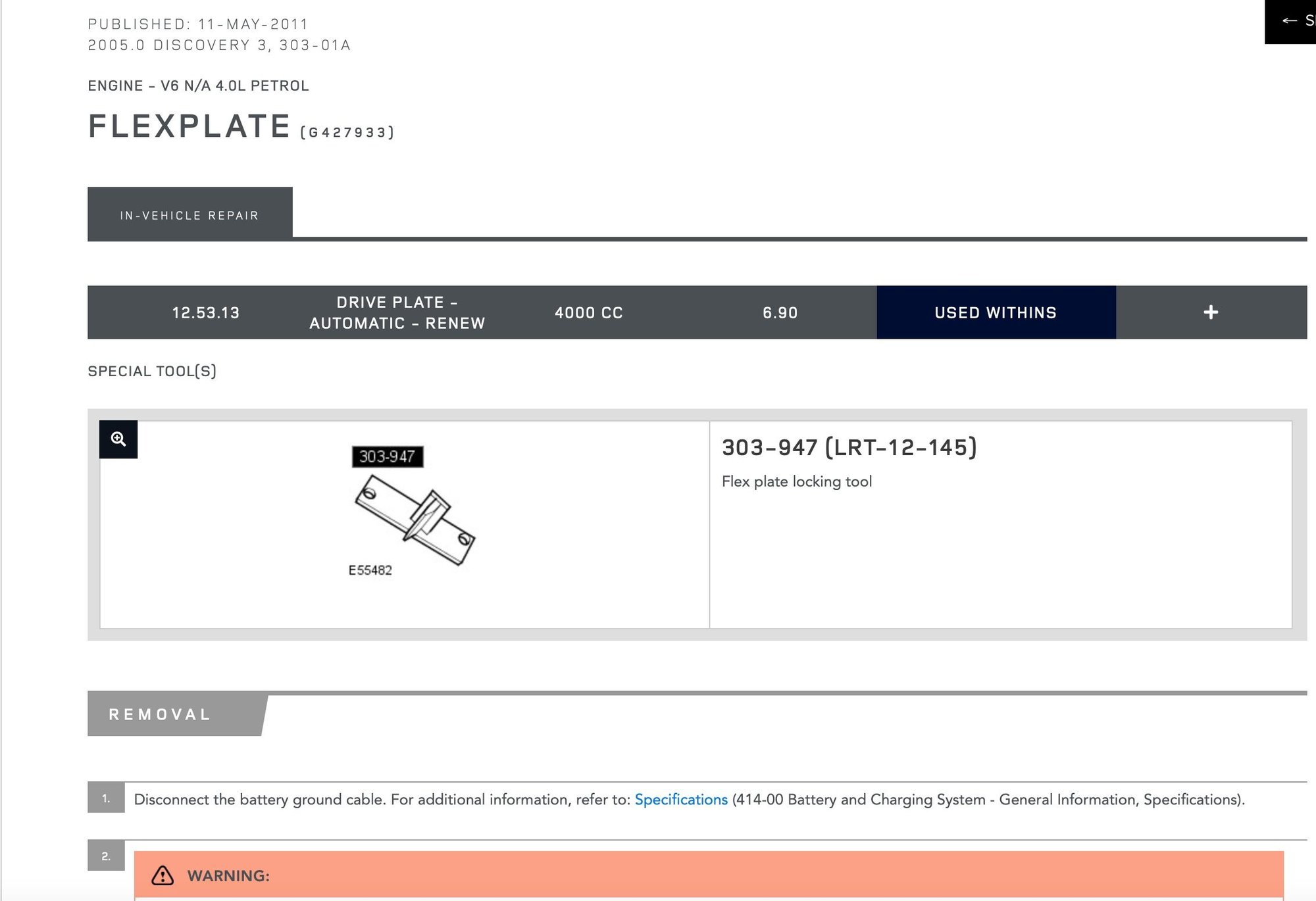

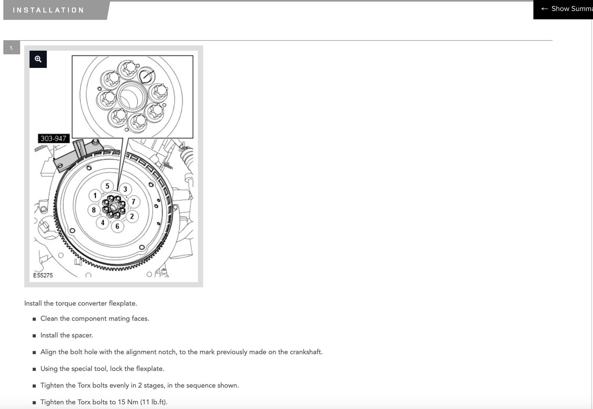

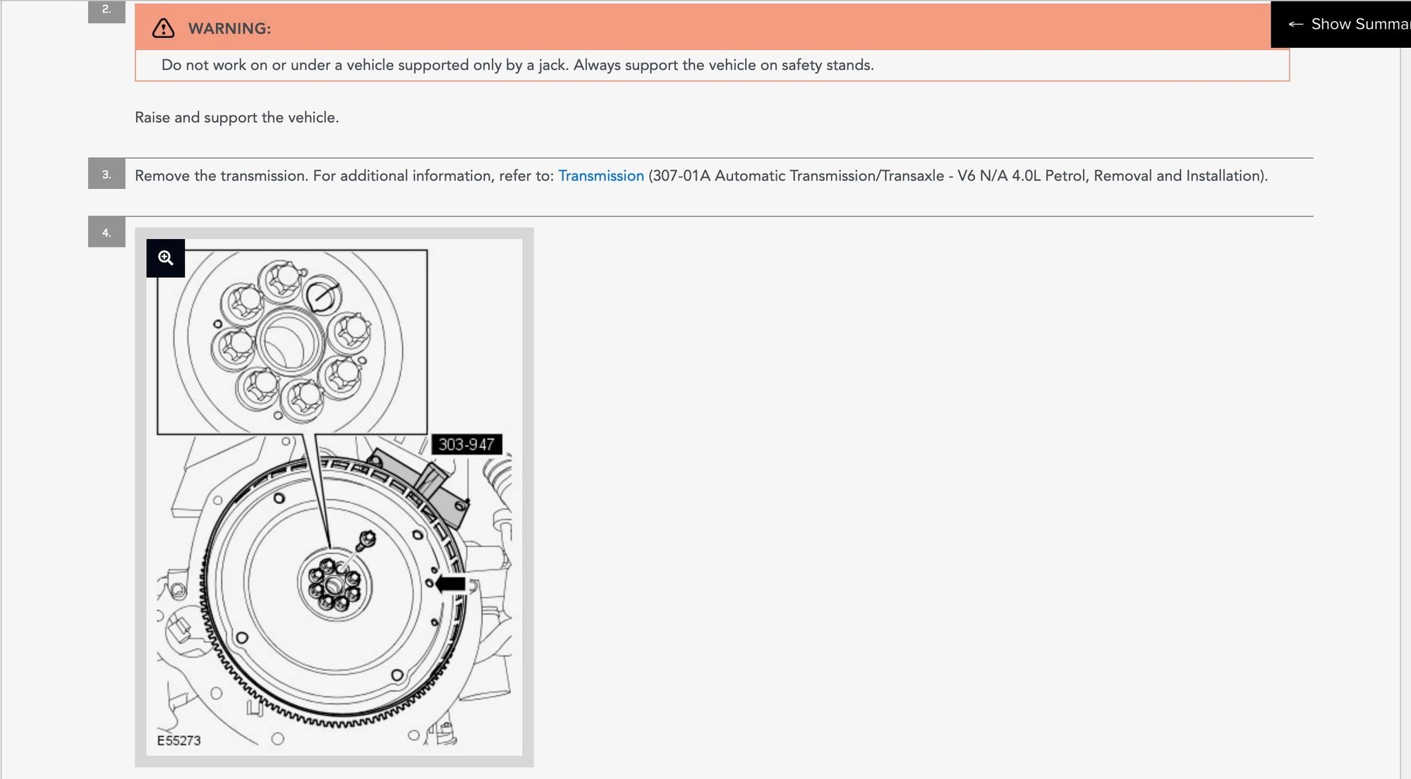

The flex can be installed in any orientation. There's no pin or anything that would prevent you from installing it in the wrong position. Search the forum... I can't remember where it was supposed to be lined up. It was addressed in one of the V6 threads. Maybe the "master rebuild kit for the V6" thread?

Default This thread is dead.
It was the flex plate.

Thanks for posting the installation procedure. Hopefully it'll help someone in the future. Miss you around here!
