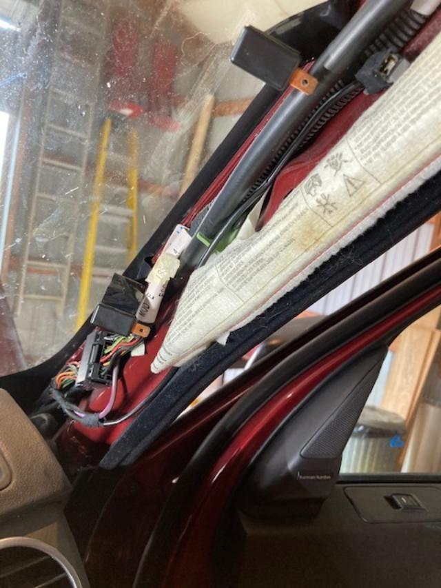

Got the drivers side pillar trim removed. Went back to records and had pillar/windshield leak worked on at dealer in July 2010. Looking over job I would call it a 6 out of 10. Seems like went overboard with auto sealant but hey it worked till now. Appears could possible be a point of water intrusion at top corner of windshield. I assume need to peel back rubber gasket on along top of windshield to check? Any observations or recommendations. I’ll clean up pillar, buy new clips and maybe a new pillar trim.
anyone peeled back or removed these two trim pieces? Any experienced advice or otherwise would be helpful. I would like to peel both back some to get a good look at glass seal and maybe add a little. Going to put some water to this area and see if I can replicate leak. Thanks.

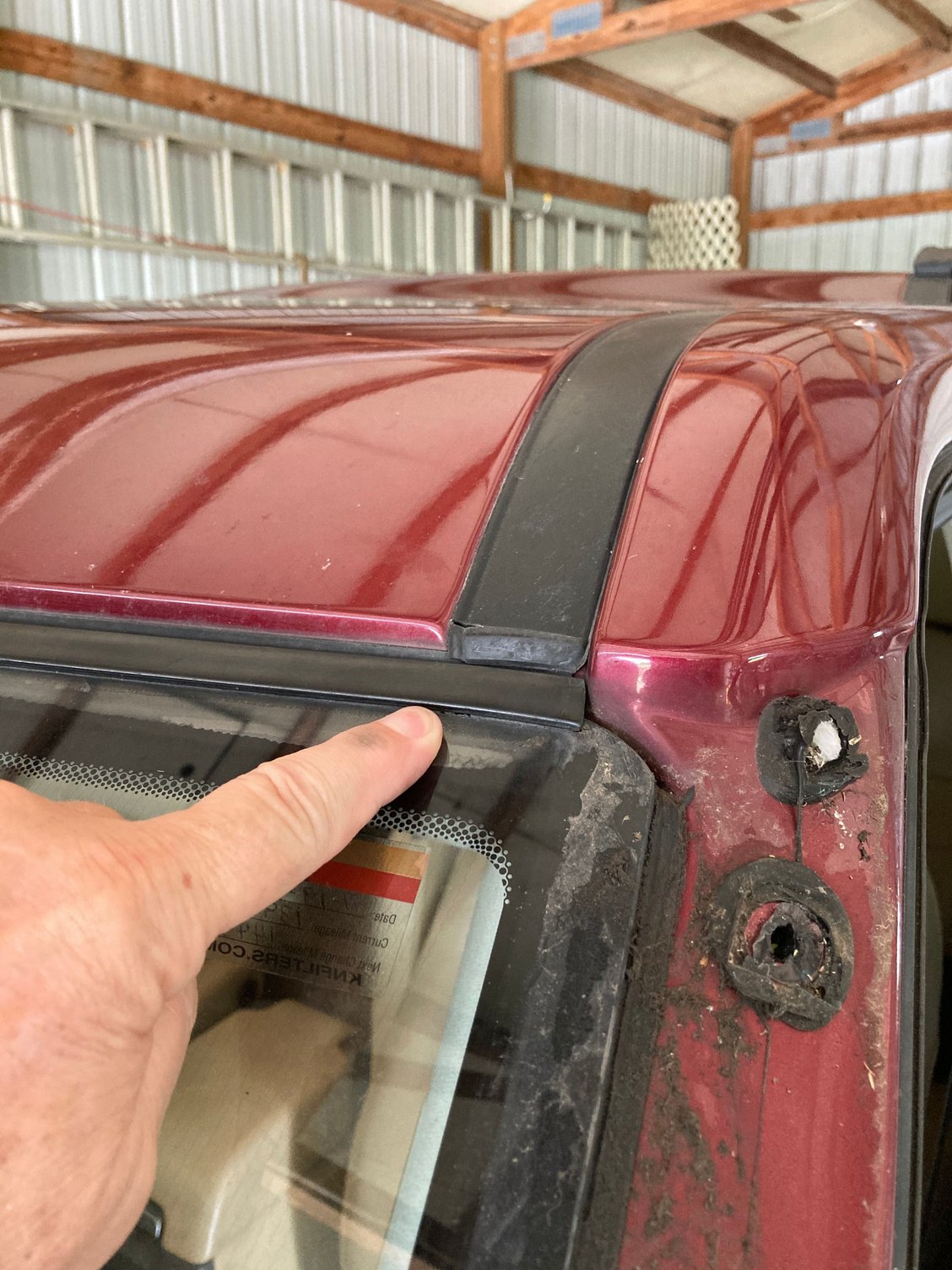

Looking at your last picture it looks like the sealant or debris on the side of the glass has allowed a space for water to collect at the top corner (and possibly along the top).
The trim along the windscreen is most likely glued to some extent. peel back from the body side to see how much debris is under it or how easily it pulls up. The trim on the roof can be gently pulled up from a front corner as the plastic snap usually releases on one side first. Seldom have I seen the perfectly clean.
I still think you have a leak from the windscreen not sealed properly and most likely you have found the point where the water has been standing and has now worked its way inside.

Thanks Rufflyer! Both trim pieces on pretty tight. I figure the sealant at side of windshield was installed during previous fix. Does seem to form a blockage at the top which would cause some water to sit at the top corner of windshield. Will have to peel trim back several inches to inspect and get some caulk in there. The trim is so tight I wonder if I will be able to get in pushed back in?

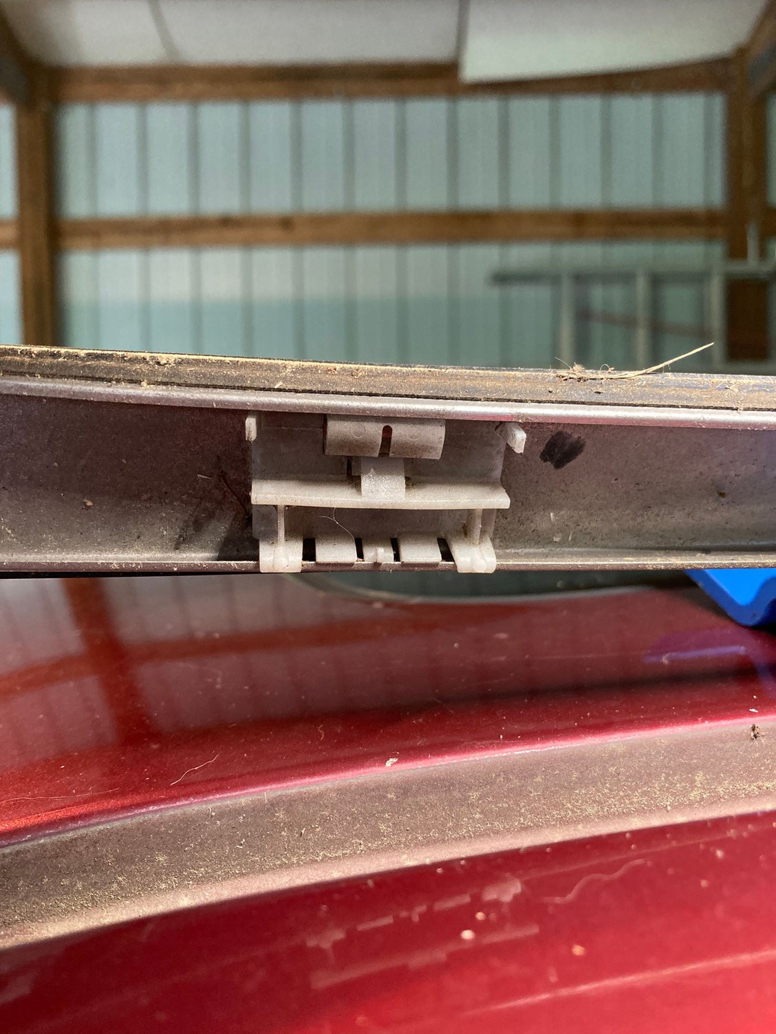

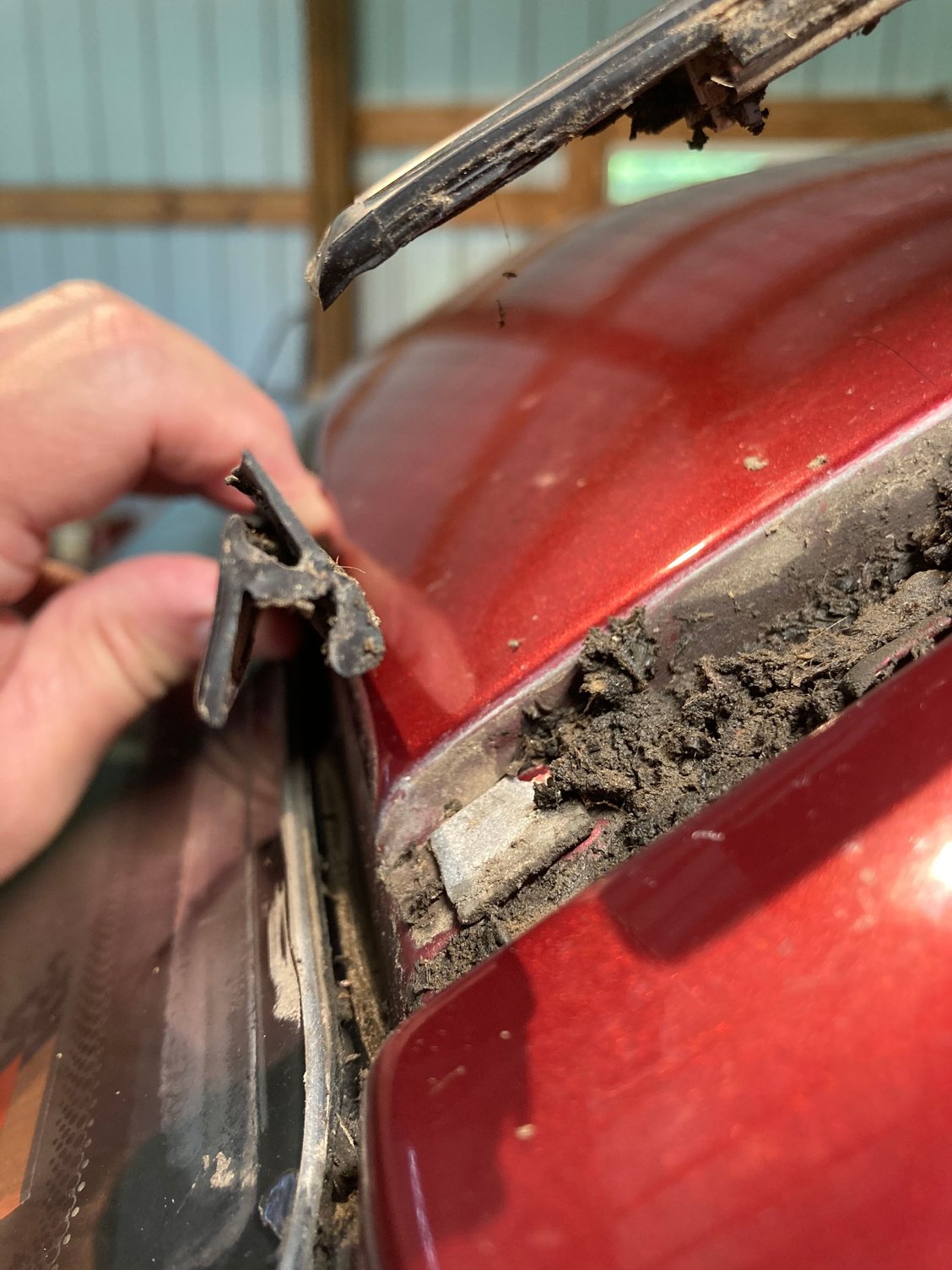

Got upper windshield and foot molding pulled back. Windshield molding just took a good tug and it broke free no problem. Ran a tool along the upper and lower edge first to break it loose. The roof molding has some different clips attached to the molding. Ran trim tool under front and pried upwards and they popped loose easily. First clip was about 1.5 to 2 inches from from front edge. Water test uncovered the leak, thank goodness. It’s at the top of windshield and appears approx 2.5 inches or so from the edge of glass. Glass still is original so I guess over time a leak developed through original seal. It’s crazy all the places LR3’s develop leaks. I’m uploading some more pics, maybe they will help someone later on with similar issues. If I ever have to replace the glass I’ll install new right pillar (replacing left on this job), and upper glass molding. Notice all the debris collected at the front of the roof molding.
